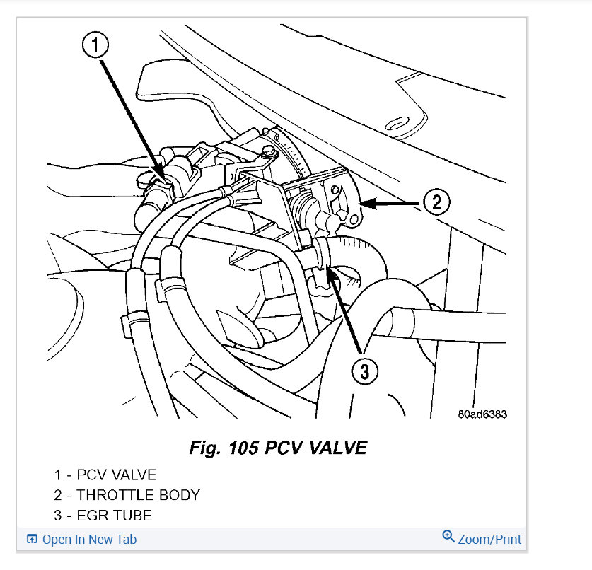

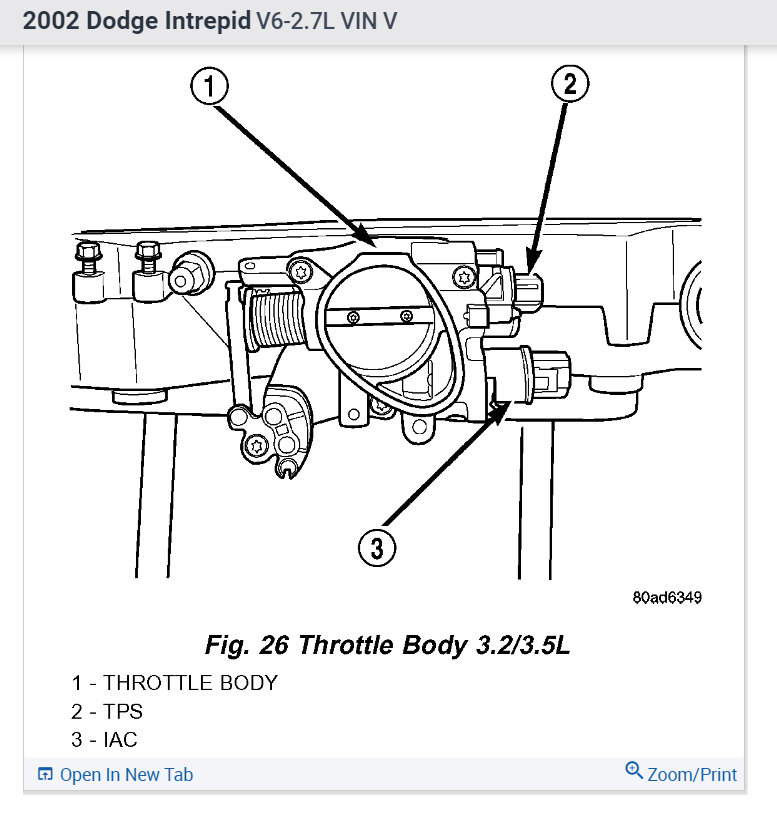

My idle doesn't return when I let foot off the accelerator, but if I shift to neutral the RPMs drop to normal.
Jun 13, 2022 at 8:53 PM
  • 55,433 POSTS
I have seen both the idle air control valve go out or get slow not adjusting the engine idle speed correctly. Also check the vacuum hose going to the PCV valve because they can tear and allow a vacuum leak. Here are two guides to help you with diagrams below to the PCV valve and IAC valve on your car:
