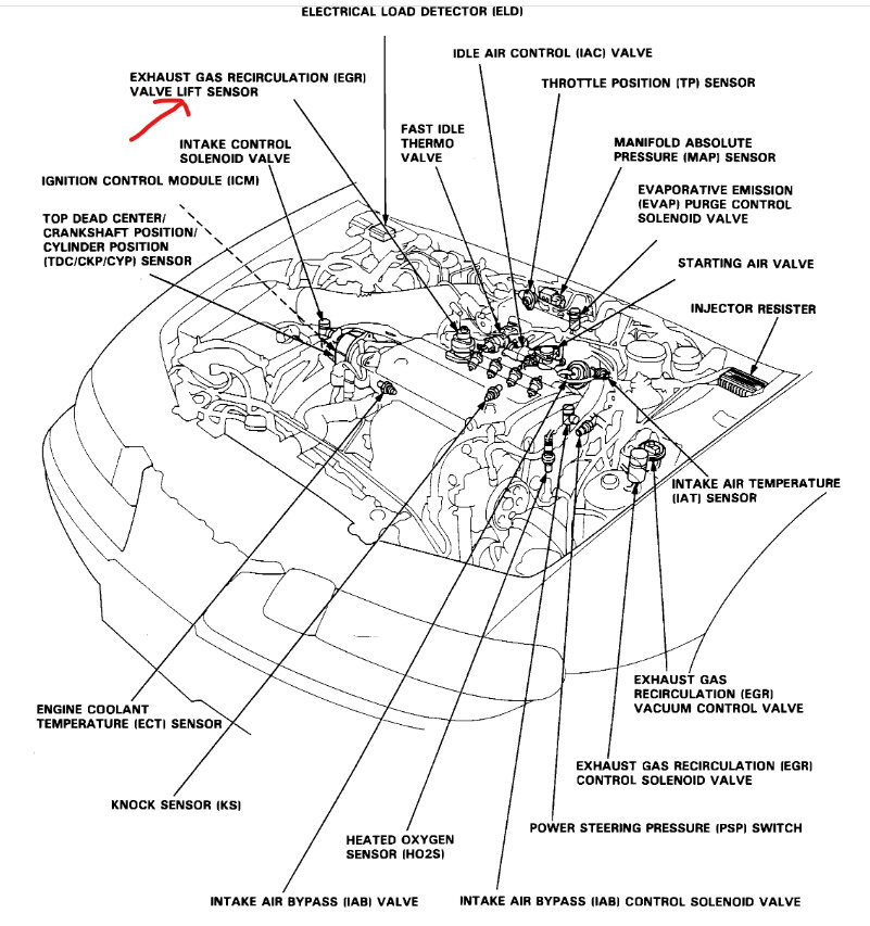

Idle is off and there is no pickup when I push the gas down
1993 HONDA PRELUDE
265,981 MILES • 4 CYL • FWD • MANUAL
OCTAVE
It's an h22-a1 Jdm crate engine and it's running rich in gas but no check engine light comes on it used to be super fast but now it's a slow car and the horsepower has gone somewhere else
Jan 28, 2015 at 9:48 PM
HMAC300
  • 48,601 POSTS
check fuel pressure with a gauge, this guide can help
Please go over this guide and get back to us.
Jan 29, 2015 at 5:56 AM
  • 54,840 POSTS
I would remove the EGR valve to see if i is stuck open here is a video to help you test it and the location of the valve in the images below.

This guide can help as well
https://www.2carpros.com/articles/why-an-automotive-engine-will-run-rich
let me know.
