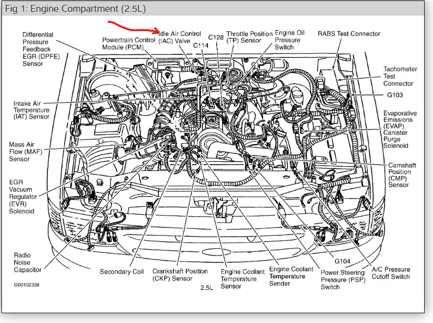

Idles high the only way to slow it down is the clutch it. Will slow down on its own but takes a while checked cable, but it is fine anybody have any thought.
Thank you
Aug 29, 2023 at 3:38 PM
  • 55,456 POSTS

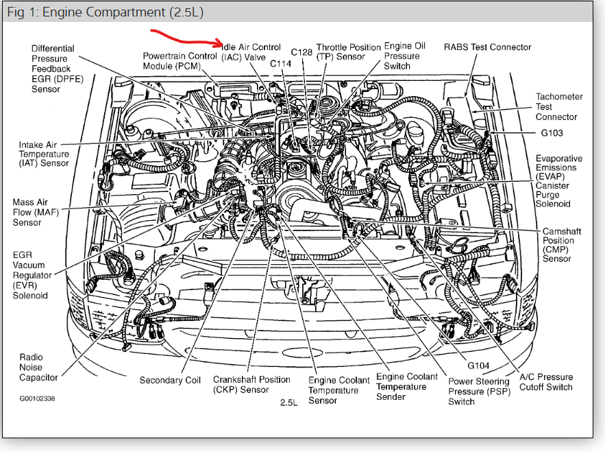

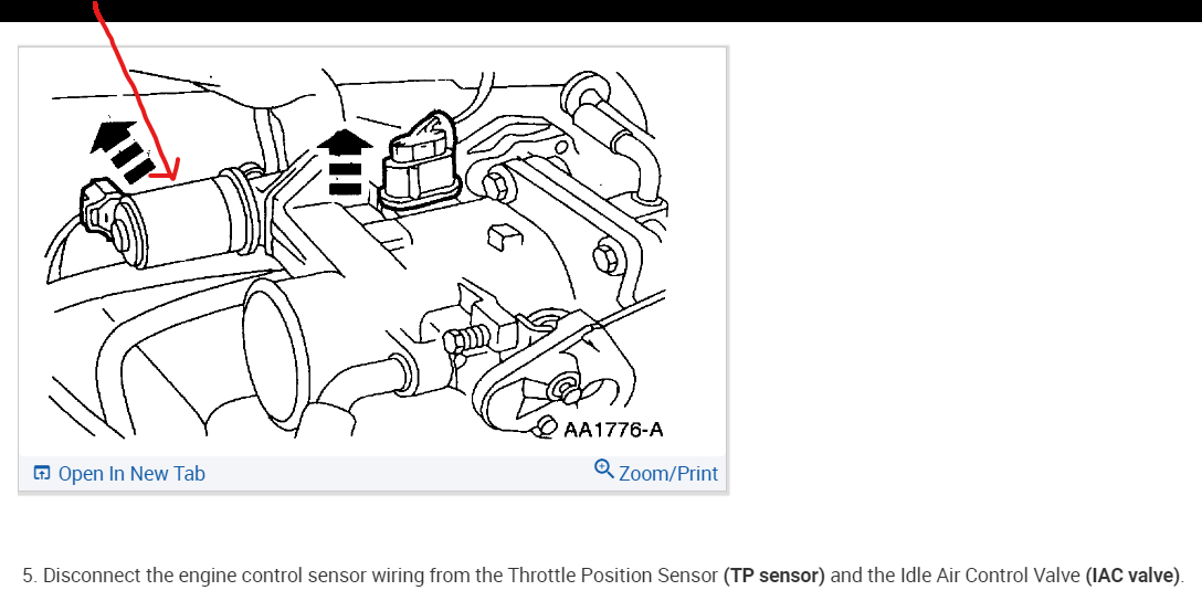

It sounds like the idle air control valve has stopped working, here is the location of the valve so you can swap it out and a guide that can help as well:
https://www.2carpros.com/articles/engine-idles-too-high
