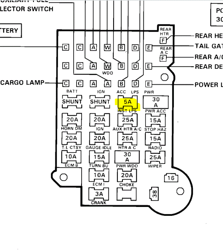

I heard it. Okay, because a few different things can be causing it, we need to try to determine why the check engine light isn't coming on.

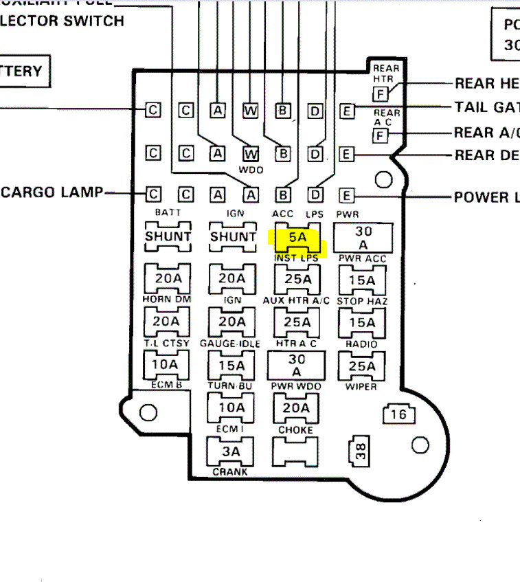

Does the light turn on when you first turn the key on? There is a fuse for instrument lights that could be blown. See the attached pic. Check that fuse and if it is good, confirm power to it and from it.
Next, when you replaced the IAC, did you check inside where it mounts for possible carbon or something that would prevent the IAC from working properly?

Pulled the fuse and tested it for continuity, okay.
With the fuse out, none of the instrument lights come on.
The 4WD light works. Right next to the engine check light.

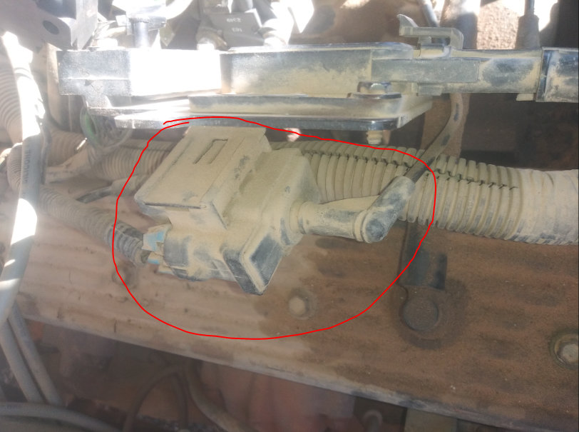

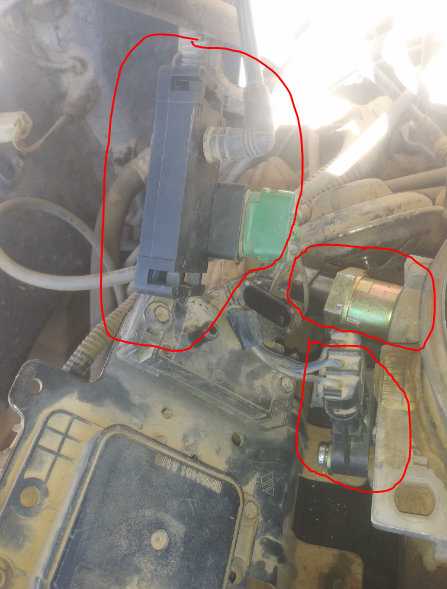

I'm confused as to what the part I replaced is called.
The sensor I replaced has a single tube connected to it.
This is the one that has been replaced.
There is another sensor that has two tubes connected to it.
Thanks for hanging in there while I muddle through this!
I'll attach a picture showing the parts that I've replaced (in red), and the other
sensor.

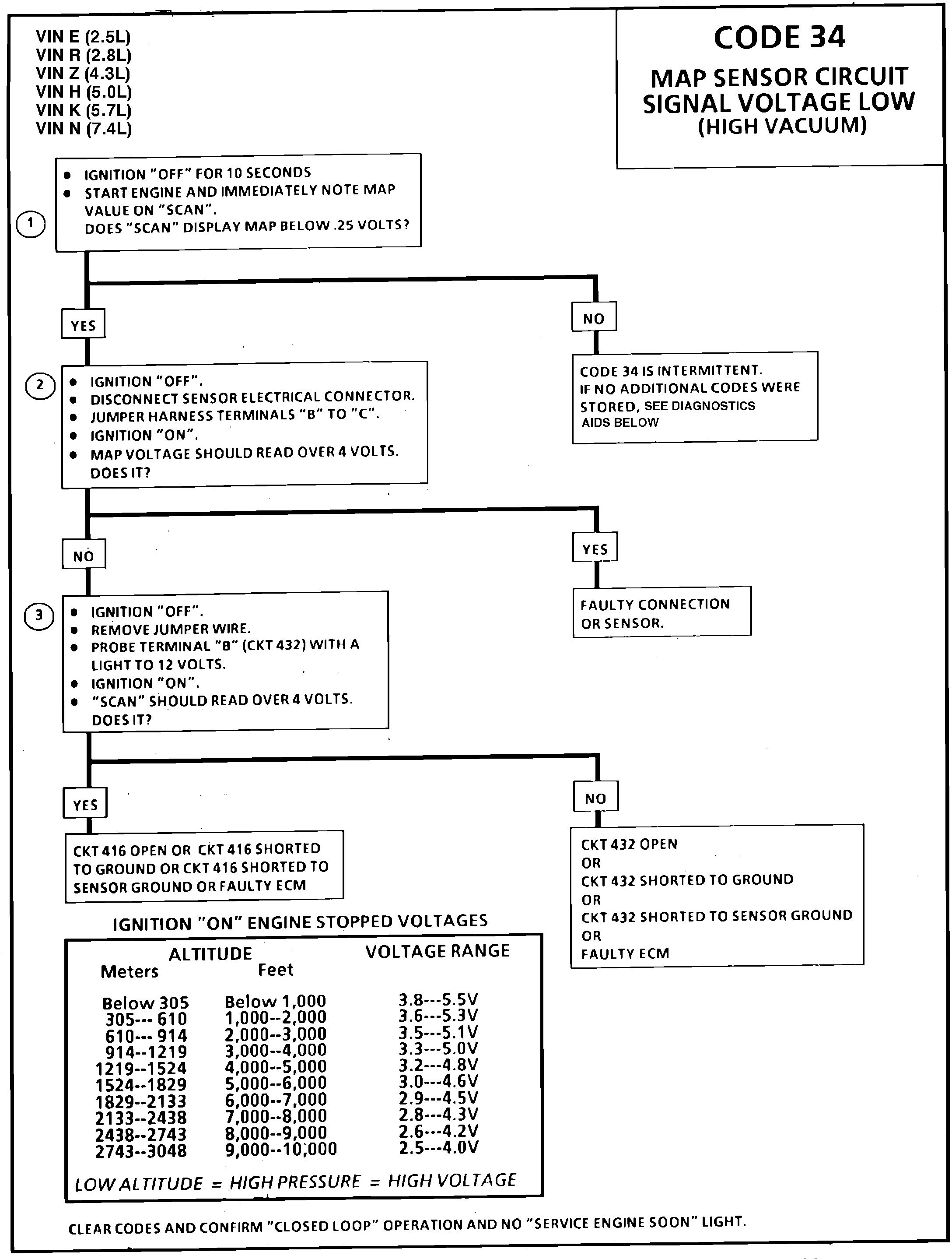

It certainly related to the MAP sensor. Here are the directions for diagnosing this code. Take a look through it and let me know if it helps.
___________________________
1989 Chevy Truck Suburban 1/2 Ton 4WD V8-350 5.7L
Powertrain Controls - ECM/PCM
Vehicle ALL Diagnostic Trouble Codes ( DTC ) Testing and Inspection Manufacturer Code Charts DTC 34 Powertrain Controls - ECM/PCM
POWERTRAIN CONTROLS - ECM/PCM
Code 34 - MAP Sensor Circuit Signal Voltage Low (High Vacuum)
see pic 1

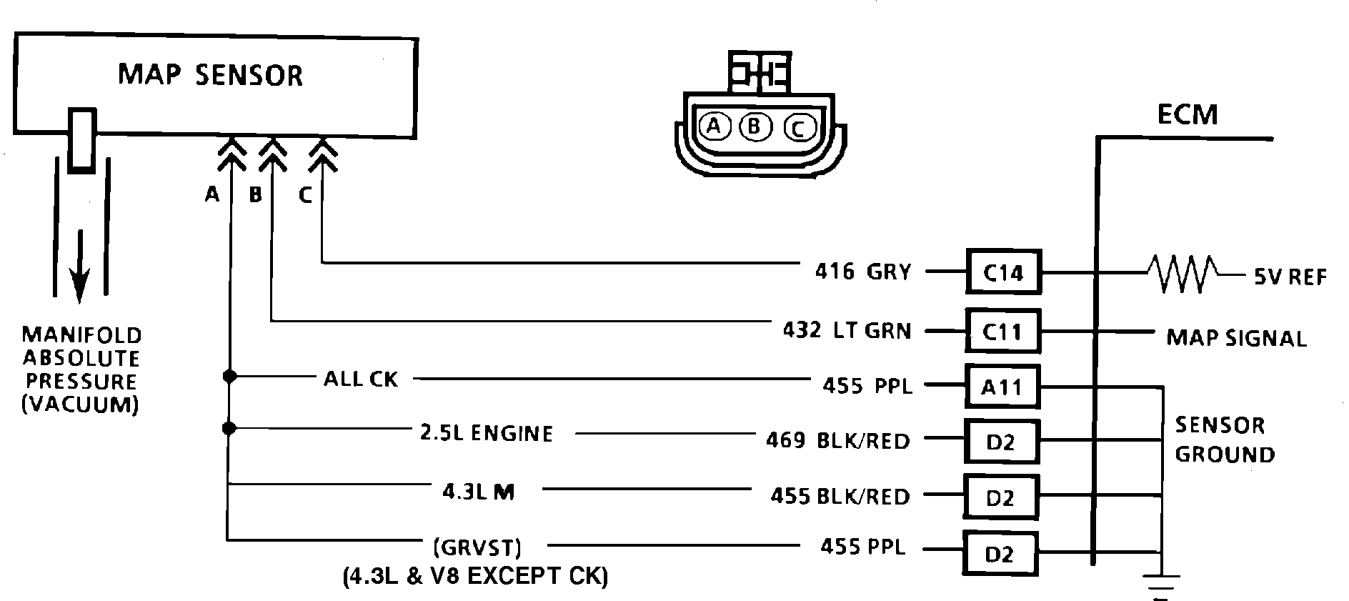

Wiring Diagram For Code 34 - MAP Sensor Circuit Signal Voltage Low (High Vacuum)
see pic 2
CODE 34 - MANIFOLD ABSOLUTE PRESSURE SENSOR CIRCUIT (MAP) SIGNAL VOLTAGE LOW - HIGH VACUUM

Test Description: Numbers below refer to circled numbers on the diagnostic chart.
1. Code 34 will set when:
^ When engine is less than 600 rpm.
^ Manifold pressure reading less than 13 kPa, conditions met for 1 second or
^ Engine is greater than 600 rpm.
^ Throttle angle over 20%.
^ Manifold pressure less than 13 kpa conditions met for 1 second.
2. This tests to see if the sensor is at fault for the low voltage or if there is a ECM or wiring problem.
3. This simulates a high signal voltage to check of an open in CKT 432. if the test light is bright during this test, CKT 432 is probable shorted to ground. If "Scan" reads over 4 volts at this lest CKT 416 can be checked by measuring the voltage at terminal "C". (should be 5 volts)
Diagnostic Aids:
An intermittent open in CKTs 416 will result in a Code 34.
See Diagnosis By Symptoms - No Trouble Codes Stored.
The "Altitude to Voltage" scale at the right may be used to test the MAP sensor at a specific altitude level to evaluate the possibility of a "slewed" (mis-scaled) sensor. A "slewed" sensor could result in poor driveability complaints.

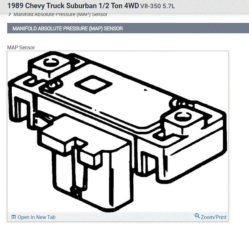

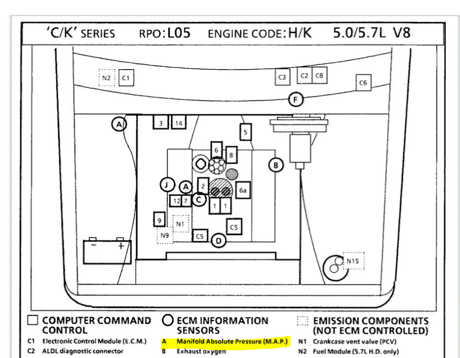

Pic 3 shows what the map looks like and pic 4 shows the location.
