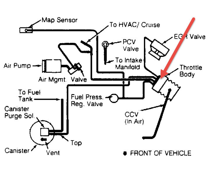

Idle control valve location
1988 OLDSMOBILE CUTLASS
63,000 MILES
SANDY JONES
There are three different sensors in general area on this 2.8 v 6. I need to have a picture of where the idle control valve is and what it looks like. Car revs once started and does not kick down until you shut it off and restart. any other suggestions?
Jan 11, 2017 at 12:46 AM
HMAC300
  • 48,601 POSTS
try cleaning throttle plate on both sides with choke cleaner and vacuum lead to PCV like to break above throttle body as it is plastic. arrow in picture points to location. Check out the images (below). Let us know if you need anything else.
