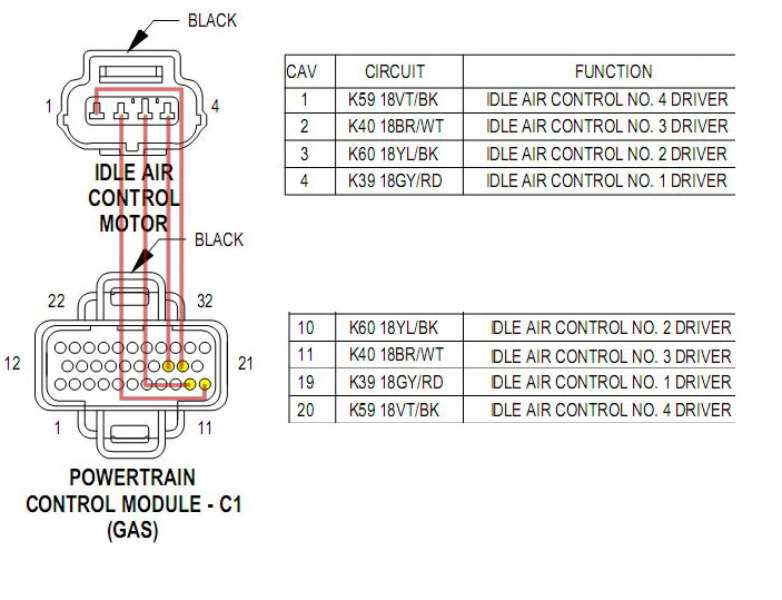

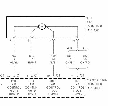

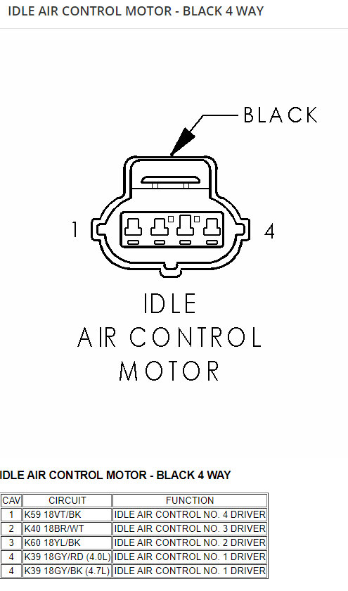

i think somehow the wires coming from the harness to the control valve have been crossed, is there a schematic for the colored 4 wires.
May 18, 2023 at 3:15 PM
BORIS K
Experienced Mechanic
836 POSTS
Below please see the connector layout.
See images attached.
Pin 1, violet/black wire
Pin 2, brown/white wire
Pin 3, yellow/black wire
Pin 4, grey/red wire
Hope this helps.
Cheers, Boris
