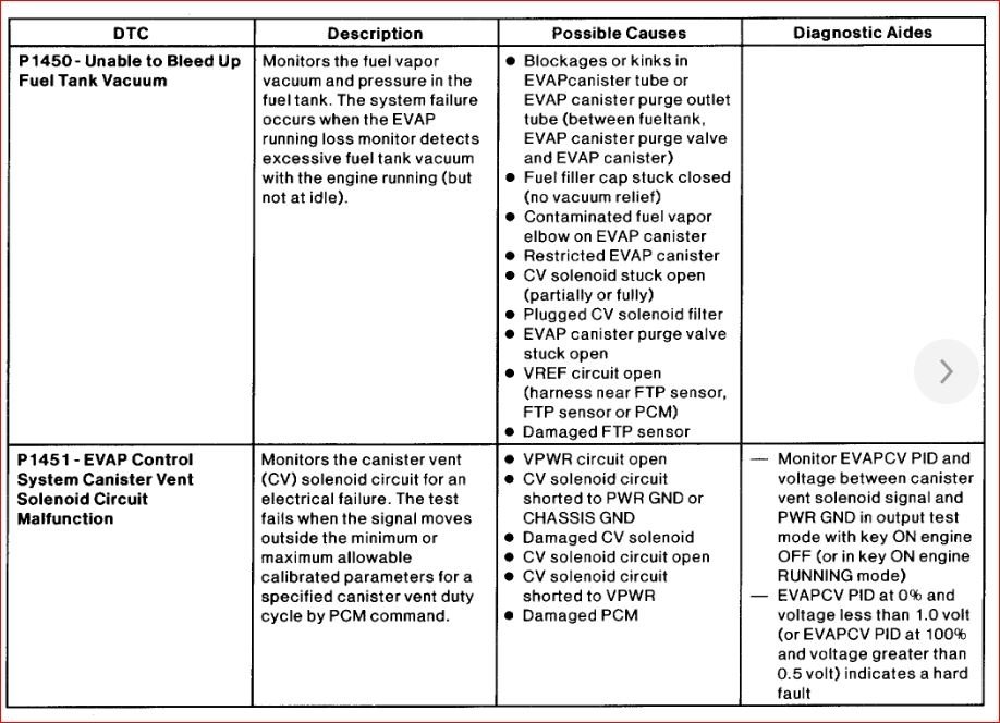

At startup idle is smooth and accelerating is good. After warm up idle is very rough and accelerating is very bad with some backfiring. No vacuum leaks found. Replaced PCV.

Codes found are po174, 705, 708,1451,141,256,1131,2132,1151,171.

P0171 and P0174 are for Bank 1 lean. The P1131 and the 1151 is an o2 sensor says it is at the limit for the fuel trim which means it is indicating a lean misfire.
The P1451 is for the evap system.
The main causes of lean misfires are listed in this guide. If you have no vacuum leaks, have you checked the operation of the MAF sensor. Also, are there any leaks in the exhaust before the o2 sensors?
https://www.2carpros.com/articles/repair-lean-mixture-codes-p0171-or-p0174-on-some-manufacturers
https://www.2carpros.com/articles/mass-air-flow-service
If the engine runs well at first, and then it starts running poorly I am pretty sure you have a sensor issue.
Do you have a scan tool that can monitor the live data? We need to see what the MAF is doing when it starts to misfire.
