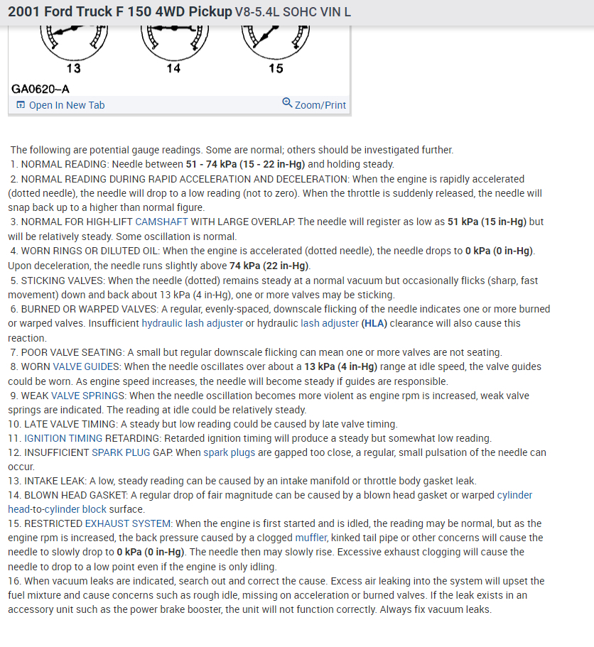

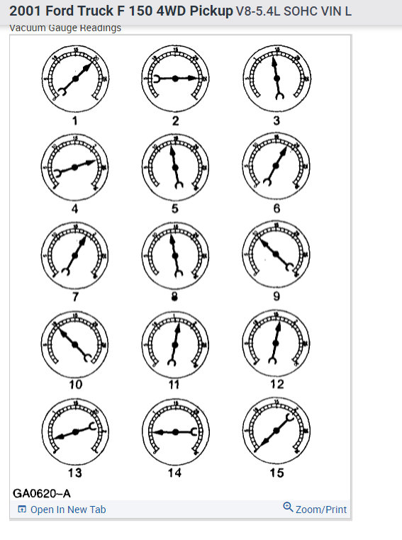

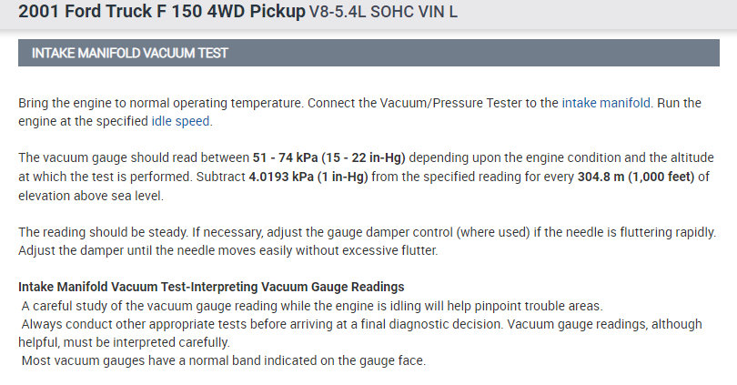

The idea that you have a lean mixture can certainly point to an engine vacuum leak. However, when that occurs, it will usually affect all cylinders and not just three.
What I suggest is this. First, check to see if you can locate any engine vacuum leaks. Here is a link that explains how this is done:

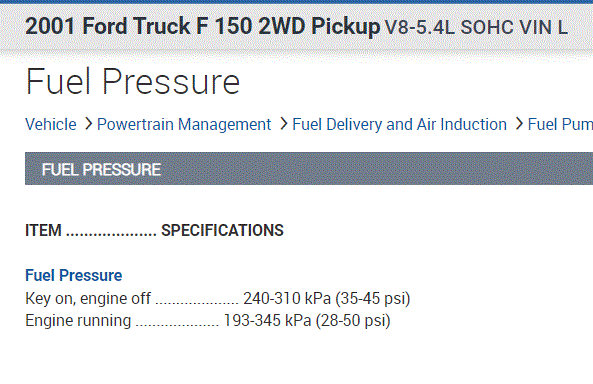

If nothing is found, next check the fuel pressure to make sure it is within the manufacturer's specifications. Here is a link that explains how this is done:
Pic 1 below provides the manufacturer's specification for pressure.

You also want to make sure you have proper fuel pressure. This vehicle should have 35-45 PSI of fuel pressure with the key on and engine off.
