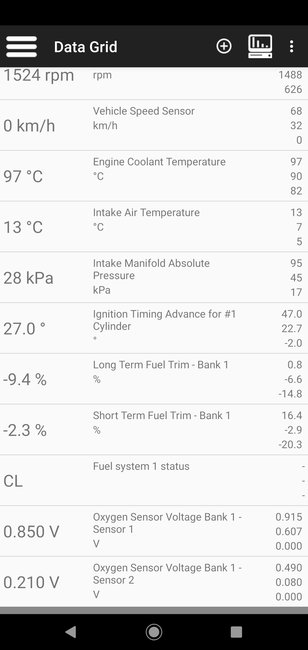

After a recent timing belt replacement where battery was disconnected. My car suddenly started idling somewhat slowly and has no fast idle when cold. It idles between 450 rpm and 690 depending on temperature, and it bounces a little bit. It smells and seems to be running really rich at idle. I am a decent mechanic and have been scouring the internet for a solution.
I assumed the ECU reset had caused it and first just drove it awhile.
I cleaned the IAC and TB, then replaced the IAC valve, if anything it got a little worse.
I tore apart the timing belt again and verified the timing was correct. It was, and the car runs fine above idle, no power loss, it does hesitate now when setting off from a stop.
I checked the coolant temp sensor with a obd tool, seems to register fine, gives steady temperatures, I checked resistance with a multi-meter and it behaves as expected as it warms up.
There are no codes stored, the fuel and O2 system reports running in closed loop so the O2 sensors seem to be working.
I replaced the spark plugs.
I found a test for the IAC circuit where you jump two pins in the diagnostic port under the hood, it does not idle up as expected. Which is my only clue.
I have voltage 13V when running at the IAC valve between the middle pin and either outside pin.
This seems like an IAC issue to me but a clean and replace didn't help.
Since replacing IAC valve didn't help, finally I bought a used ECU on eBay and swapped it, no change at all. Ugh I really thought that would fix it. I am all out of ideas.

You have done a lot. The one thing I noticed you didn't mention was checking for engine vacuum leaks. That can cause an idle issue. Also, I noted you check for codes, so I suspect you have a scanner. If it is a live data scanner, can you let me know what the fuel trims are. I would specifically like to know the short term fuel trims.

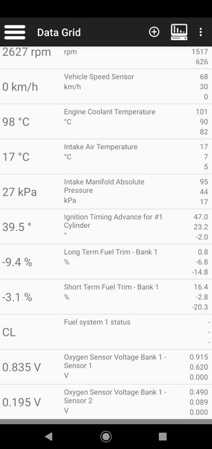

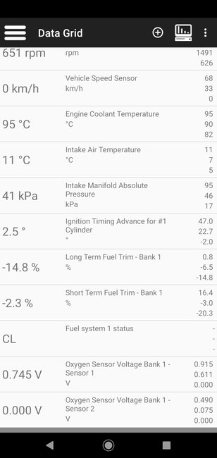

I added 3 data screenshots from idle 1500 and 2500 rpm. Short term trim bounces a lot but generally at idle it's plus minus 2, long term is locked on -14.8 at idle but when driving is around 0, at higher no load rpm it sits at -9.4 steady. O2 sensor 1 in header bounces .1 to .8, sensor 2 after cat is 0 to .1 whenndriving. Steady 0 at idle. I did hunt for vacuum leaks, couldn't find any. Any tricks to try on that? MAP seems low enough. I put some vacuum to EGR valve at idle and engine chokes instantly. If I pull a vacuum line and leak air the idle shoots up to 1200. How can I test EGR for leaks?

One more sensor, throttle position shows 10.2 at idle 12.5 at 1500 and 14 at 2500 no load.

I looked through the pics you attached. Was the engine warm when you did the test? I noted the engine at 208°F and the air intake at 55°F. Just curious. As far as the egr leaking, based on fuel trims, I would say the problem isn't a vacuum leak. However, here are the directions for testing the EGR system. The attached pics correlate with the directions.
