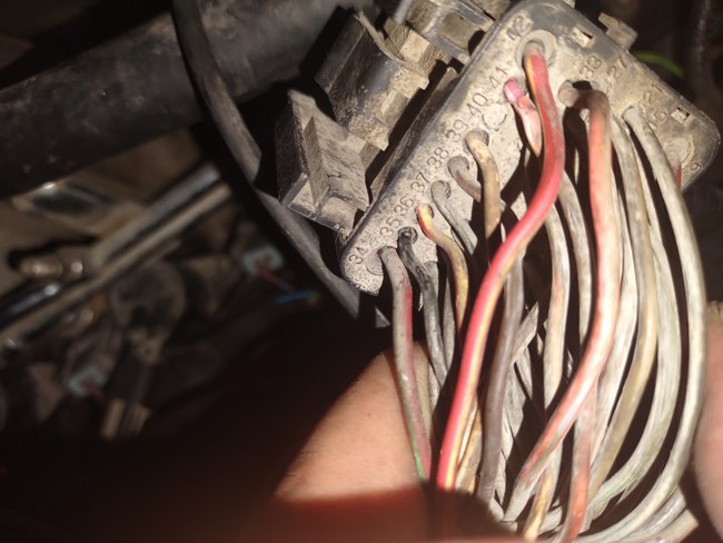

I have no power on the Idle air control valve connector when I turn the key to the on position. I've attached a light Noid and no power. The truck starts but it shuts off. The only way I can keep it running is by keeping the throttle open just a bit. So Iam thinking that since there is no power to the IAC through the connector it's not sending the amount of air coming in so that the motor can supply the correct amount of fuel, so then it shuts off. The other thing I was thinking is the key might have gotten unprogrammed. All this started when I replaced the valve cover gaskets. And in doing so I unplugged the main connectors on the firewall. I've cleaned the throttle body; I've confirmed I got spark and fuel. It just does not stay running and there is no power at the IAC connector. I need a wire diagram for the idle air control valve that looks similar to the picture below so I can trace those wires and see if there is power or continuity. Can someone please help? Thank you! Truck in question is listed above, a XLT crew cab.
Sep 13, 2022 at 7:17 AM
AL514
  • 5,700 POSTS
Hello, it sounds like you're absolutely right, if the IAC is not powered up the ECM will have no control over the idle. The power supply (12v) is actually the same one that powers the fuel injectors, it's a red wire, I will pull up a diagram, but if this happened when you did some more work, there might be a pinched wire somewhere.
With a 12-volt feed it's probably a pulse width modulated circuit on the ground side for control. So, with a node light you would see a pulse.
Another thing to think about, is if you unplugged the main bulk connector at the firewall going to the ECM, the ground wire that controls the IAC might have a pin fitment issue at that bulk connector and it is not reaching the ECM, trace back the work you did and check the connector to make sure there is a good connection to the ECM. It looks like the control wire is White/Light Blue stripe.
I added the OEM diagram too, just to verify wire coloring. They are the same, Also the bulk connector, pin 39 is the ground side control wire for the IAC. White/light blue wire.

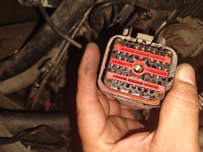

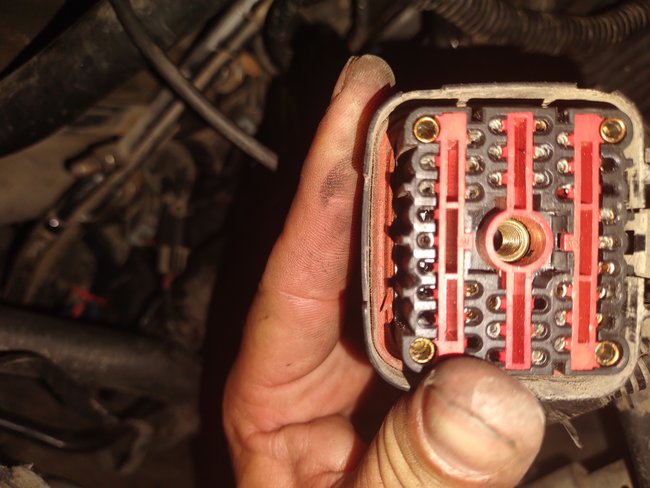

I am so relieved!!! It appears that there was a pin fitment issue at the bulk connector on the firewall. Just like you said AL514. It appears the female pin was somehow pulled to the back of the connector, making the male pin unable to establish a connection. There were 3 pins connectors that were pulled to the back, which can be seen on the picture below, which were wires 35, 39 and 41. The other pictures show the pins, which are located at the bottom row barely protruding. No wonder there was no ground connection. So, if anyone has any issues after unplugging these connectors, it won't hurt to inspect these pins. Thank you all for this amazing website and your amazing willingness to help!! Two thumbs up for sure!!!
Sep 13, 2022 at 2:46 PM
AL514
  • 5,700 POSTS
Thats good news, glad it was only a wiring issue, pin issues happen a lot after so many years of heating up and cooling off, the plastic expanding and contracting. With low voltage issues I usually don't touch connectors and wires until the problem area is isolated. I hear about modules being replaced so much over a bad wire or ground, sometimes going back to the basics helps a lot. I see a few pins there that look like they might have some corrosion on them, they sell terminal cleaners you can try spraying in there to clear that up. Deoxit Terminal cleaner seems to be the best. You can spray it right into the connector and it will clear up any corrosion. Saves you from future headaches.
