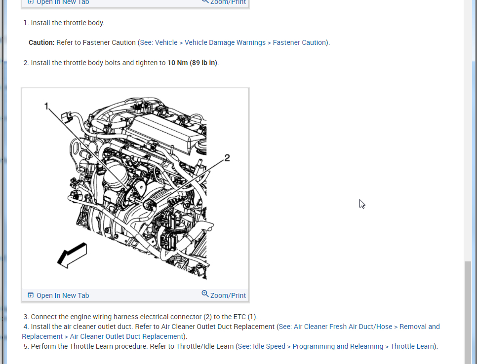

Does this car have one and where is it located?
Friday, February 19th, 2021 AT 2:47 PM

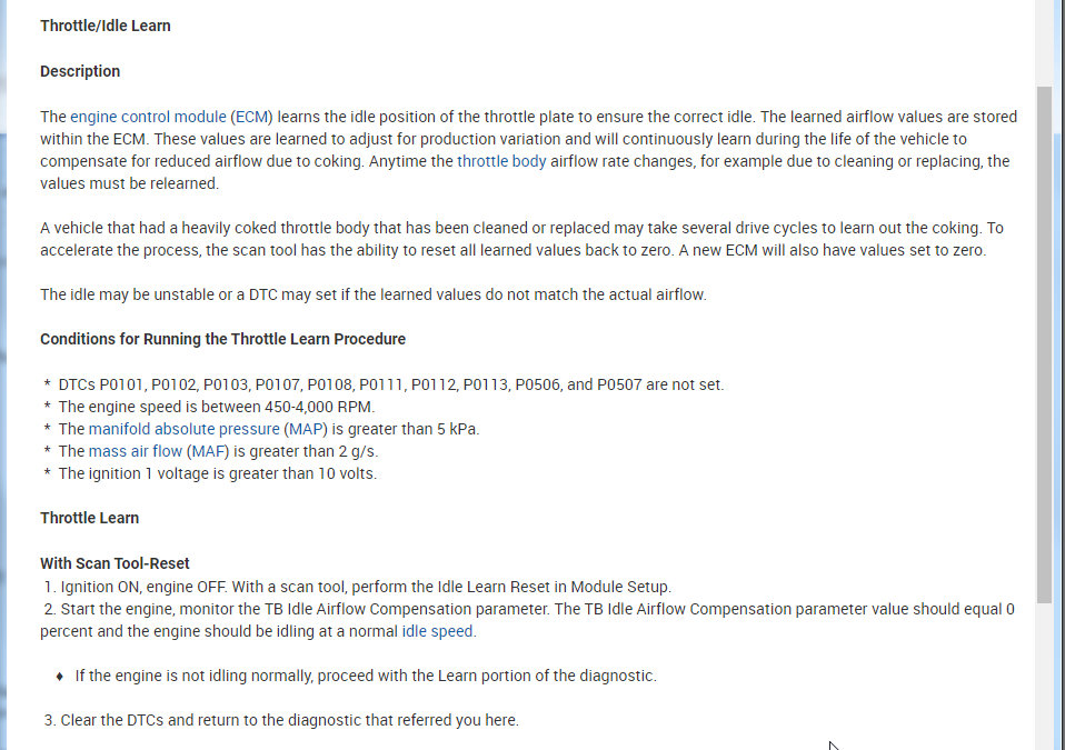

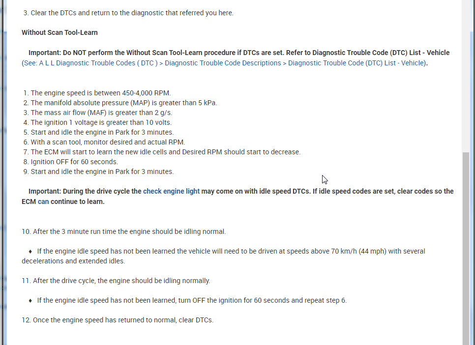

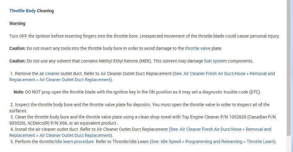

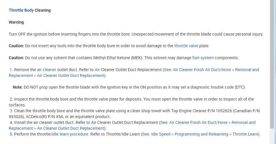

You vehicle does not have one as the PCM controls the idle through the throttle body. I attached the info on this plus how to clean it and relearn the throttle if this is what you are looking for.

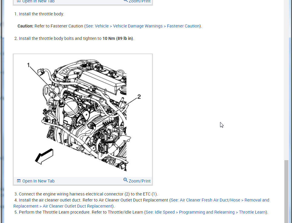

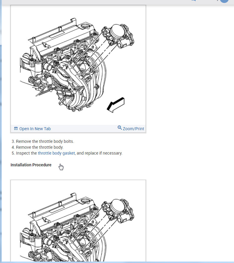

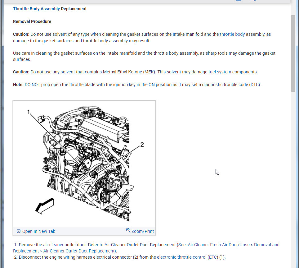

Lastly I attached below the process on how to replace the throttle body as well. Let us know if you are looking for some different info. Thanks
