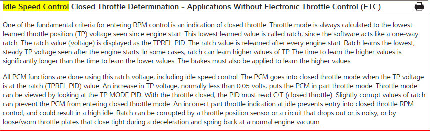

Hello again
Have you tested or inspected the throttle position sensor or throttle body? I've attached a picture below.Hope this helps and let me know.Thanks again for using 2CarPros.
