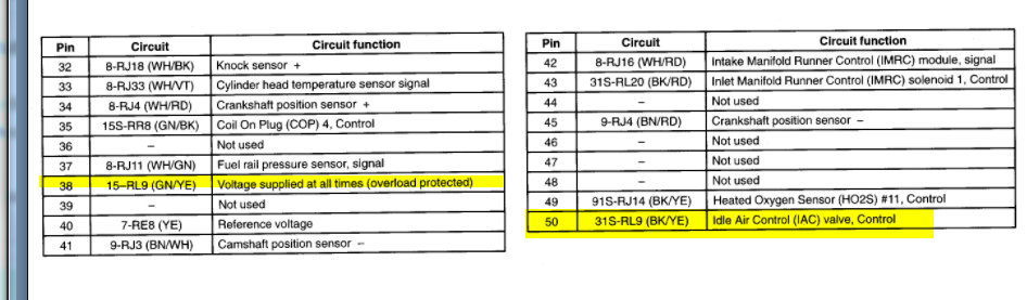

Hi, can someone help me find the ecu pinout for my car? i need to check the wire from IAC to the ECU if it has a good connection. i already have new IAC valve.
May 10, 2021 at 1:02 AM

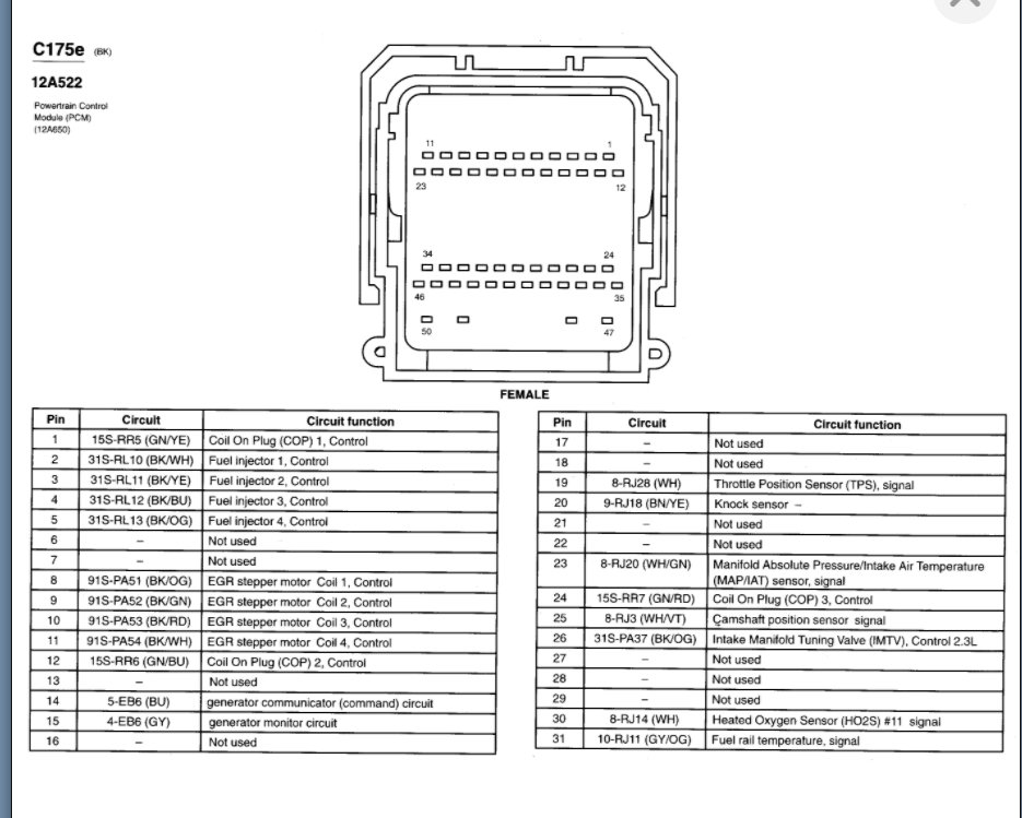

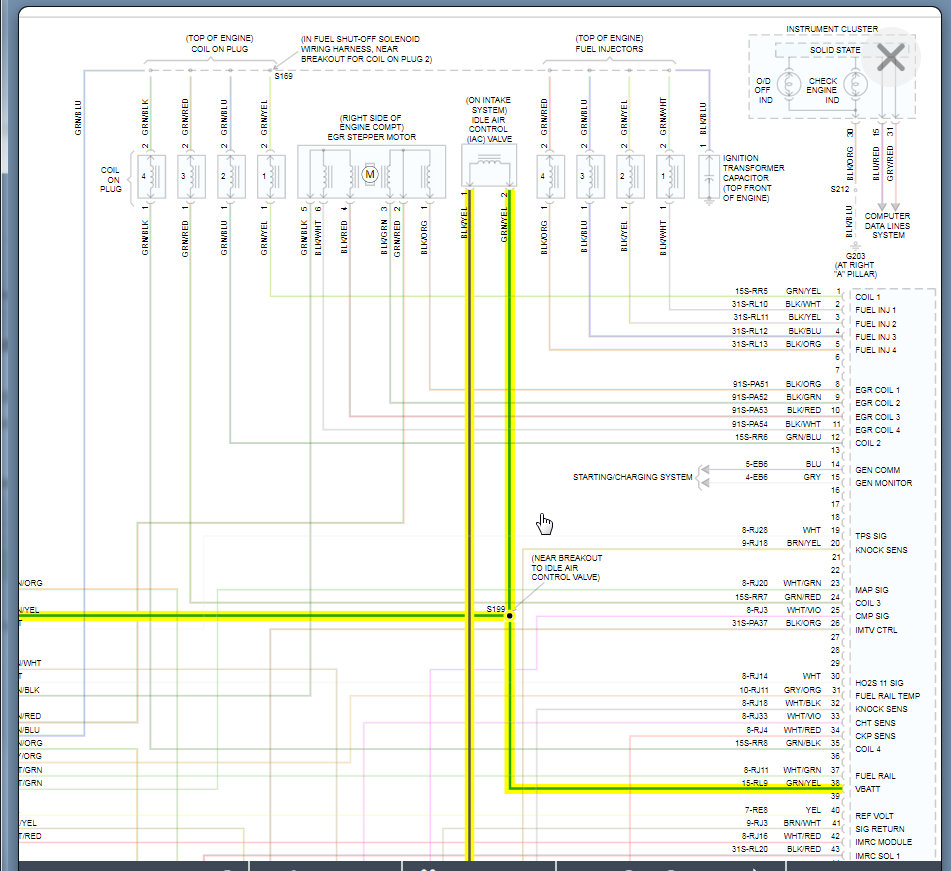

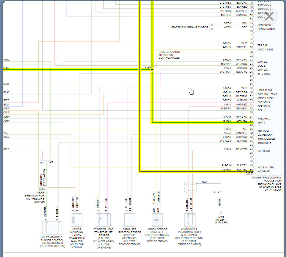

I am attaching the wiring diagram and pin out chart of the ECM. It is pin 38 and 50 of the C175E connector.
Please run through this material and let us know if you have other questions. Thanks.
