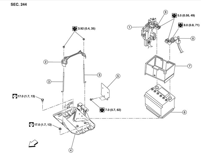

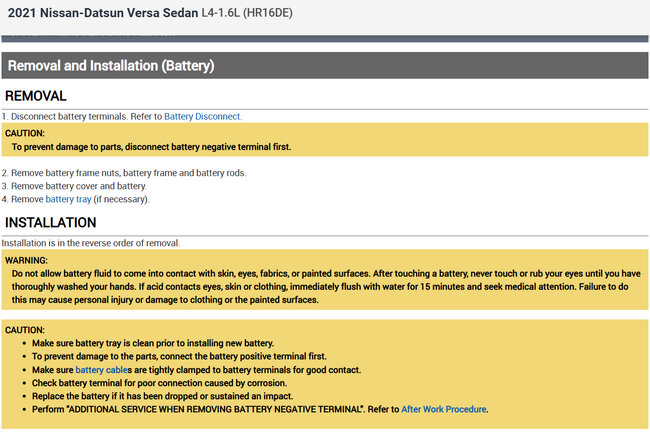

To me, the battery sounds bad which might be intermitted so I would get a new battery first which should be replaced every four years anyway. For the "clunking sound" please start a new thread. Also, when you say you need to push the start button multiple times before it will start, does the engine crank over (starter) or no? Also, do you have a check engine or battery warning light on? Please go over these videos so we can be closer to fixing it for you.
https://www.youtube.com/watch?v=6YRW8fyNudY&t
and
https://www.youtube.com/watch?v=lXLJbuAZ4CE
Here is how to change the battery out. Please go over these guides and get back to us.
