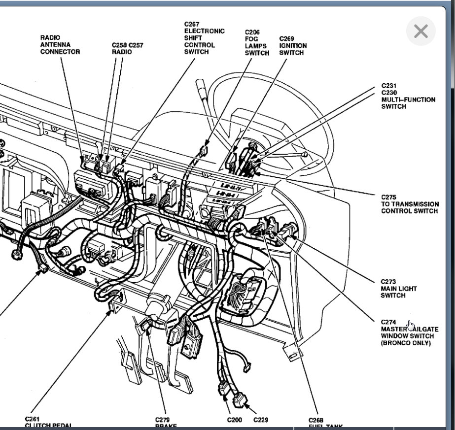

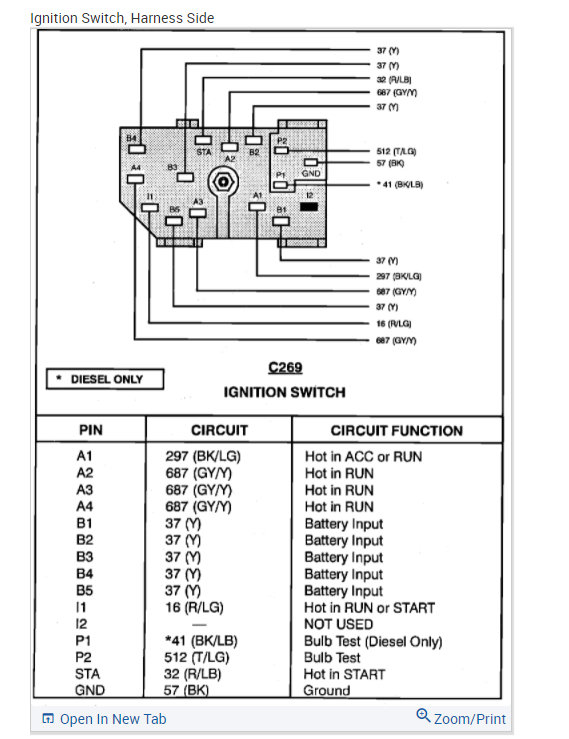

My brother broke a key in the ignition. Then he tried drilling it out. He shattered the housing for the ignition cylinder. So now I'm trying to install a push button and toggle switch. But I can't find the ignition wire harness in this old truck. If it was a carbureted truck I would have already had it done, but it's fuel injected so I have to actually do it right instead of doing it the redneck way.
May 21, 2021 at 10:49 PM
The ignition switch on this vehicle should be in the column close to the cylinder.

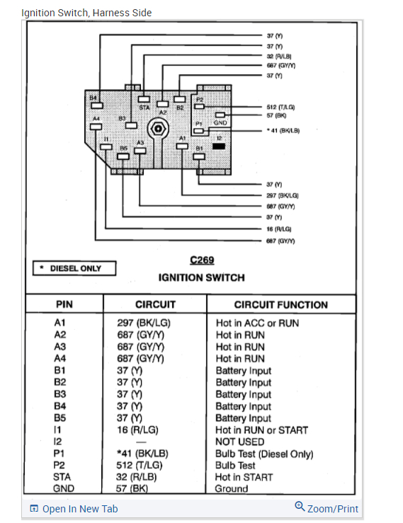

I attached the location of it and the connector view so you can see what it looks like and what each wire does so you can wire up your replacements.
Please let us know if you need other info. Thanks
