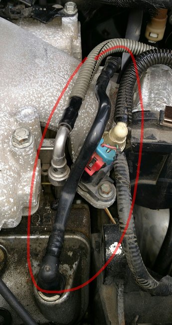

I have a part that is easy to replace, but I do not know what it is called in order to order one. It is circled in red in the picture. Any help would be appreciated!

If it is the part with the electrical connector? that is your canister purge solenoid. What scares me is your trying to to replace something you do not even know what it is called. How do you know it is bad?

It broke at the elbow. It is easy to pull off and put a new one on. I just do not know what it is. It is the black line.

Looks like a PCV hose to me,
But I'm not familiar with them there planetary vehicles!

If you go to parts dot com they have dealer parts diagrams on there with part numbers it looks like its a breather or pcv hose

PCV Foul air tube. Looks like GM part number 12590670 if the book is correct.
