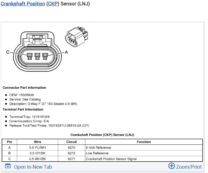

Hi, please show me how to know signal pole and earth pole on 3 wires crankshaft position sensor.

Sure, here is the crankshaft connector view that shows which each of the wiring positions are inside the connector. Check out the images (below). Let us know if you need anything else.
