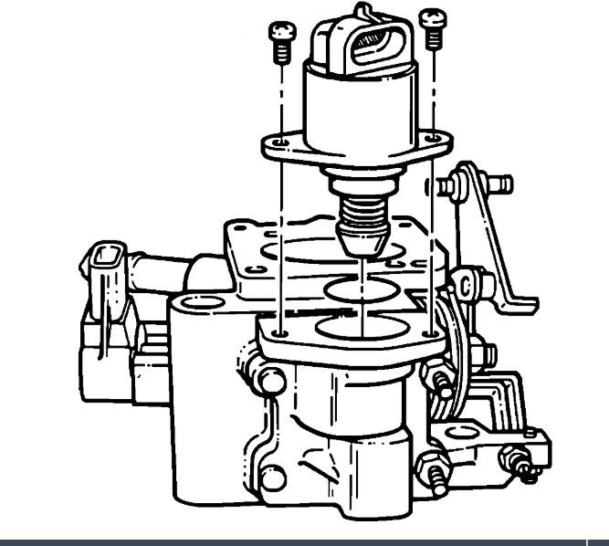

Where is the idle air control valve located on the car listed above?

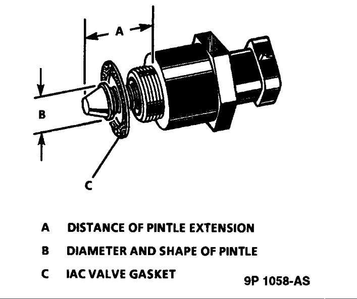

The IAC is on the throttle body. I attached pictures and the procedure for you for the replacement.
https://www.2carpros.com/articles/how-to-replace-an-idle-speed-control-motor-iac
Let me know if you have any other questions.
REMOVAL:
1. Disconnect the idle air control (IAC) valve electrical connector.
2. Remove the IAC valve attaching screws.
3. Remove the IAC valve assembly.
CAUTION: On IAC valves that have been in service, DO NOT push or pull on the old IAC valve pintle. The force required to move the pintle may damage the threads on the worm drive.

NOTE: If installing a new IAC valve, be sure to replace with an identical part. IAC valve pintle shape and diameter are designed for specific application.

1. If installing a new IAC valve, measure the distance between the tip of the pintle and the mounting flange.
If greater than 28 mm, use finger pressure to slowly retract the pintle. The force required to retract the pintle of a new valve will not cause damage to the valve.

3. Install the IAC valve assembly.
4. Install the IAC valve attaching screws, and tighten to 3.0 Nm (27 in lb).
5. Connect the IAC valve electrical connector.
