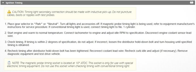

Sending you the procedure from "Prodemand"
See if you checked timing like they show it.
See picture/ screenshot below

I am using a conventional timing light. The idle speed is not adjustable. I warmed the engine to normal operating temperature, and remoxed the coolant sensor lead and check the timing. The rest is as described in my question when I changed the distributor. I also removed the front cover and inspected the time marks and the belt. all was as it was stated in my Hanes manual. I replaced the timing belt about three or four years ago.

were you able to get the base timing set correctly before you plugged the coolant sensor back in and was it idling okay at that point?
Ignition timing with the coolant sensor plugged in and at operating temperature should be twenty to thirty degrees BTDC at 2000 RPM. Not ATDC. You may want to recheck that the distributor is not off one tooth when you put the new one in. I think base timing (coolant sensor unplugged) should be around ten degrees.

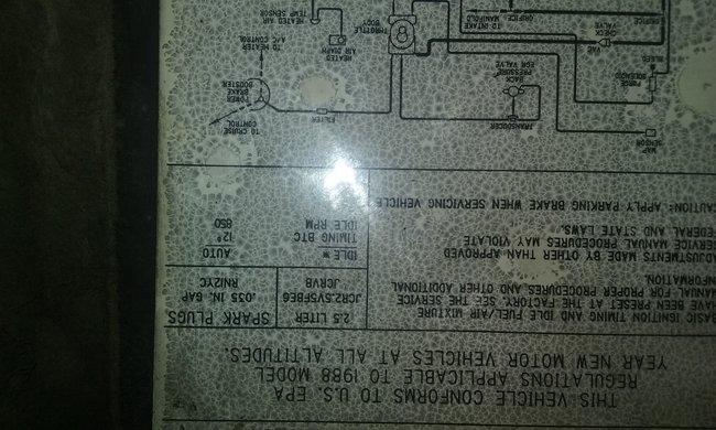

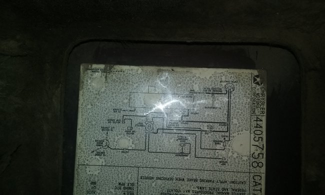

052361
  • 98 POSTS
This is the emissions sticker underneath the hood.
Oct 25, 2016 at 11:59 AM

The smell of gas is probably because the engine is misfiring due to the timing being off so much, So you're saying that the timing was jumping around with the coolant sensor unplugged? (at base timing) and 12 degrees BTDC?
also can you send me a full picture of that tag under the hood, i'd like to see those sensor lines and vacuum lines.
I'm wondering if the distributor is in there, off one tooth on the camshaft. The base timing shouldn't be that far out. And also I think I see that the distributor has a vacuum advance on it? am I correct about that?

There are no vacuum line to the distributor. So I dont think I have a vacuum advance. I wii post a better image of the tag.
