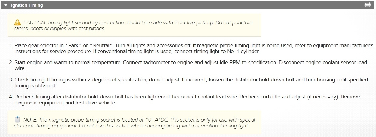

Sending you the procedure from "Prodemand"
See if you checked timing like they show it.
See picture/ screenshot below

I am using a conventional timing light. The idle speed is not adjustable. I warmed the engine to normal operating temperature, and remoxed the coolant sensor lead and check the timing. The rest is as described in my question when I changed the distributor. I also removed the front cover and inspected the time marks and the belt. all was as it was stated in my Hanes manual. I replaced the timing belt about three or four years ago.

were you able to get the base timing set correctly before you plugged the coolant sensor back in and was it idling okay at that point?
Ignition timing with the coolant sensor plugged in and at operating temperature should be twenty to thirty degrees BTDC at 2000 RPM. Not ATDC. You may want to recheck that the distributor is not off one tooth when you put the new one in. I think base timing (coolant sensor unplugged) should be around ten degrees.
Also, check and make sure you got all the air out of the coolant system. The coolant sensor cannot read air pockets that may get trapped in there.
