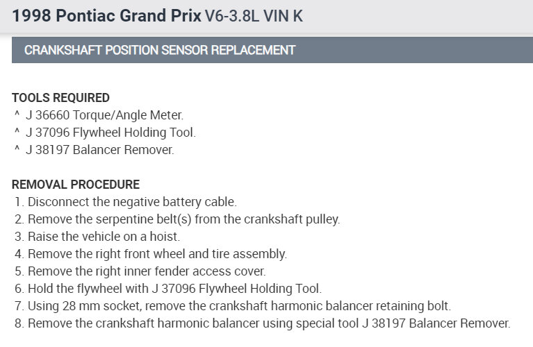

How come I'm not getting fire from my ignition control module?
Sep 4, 2023 at 6:24 PM
  • 55,627 POSTS

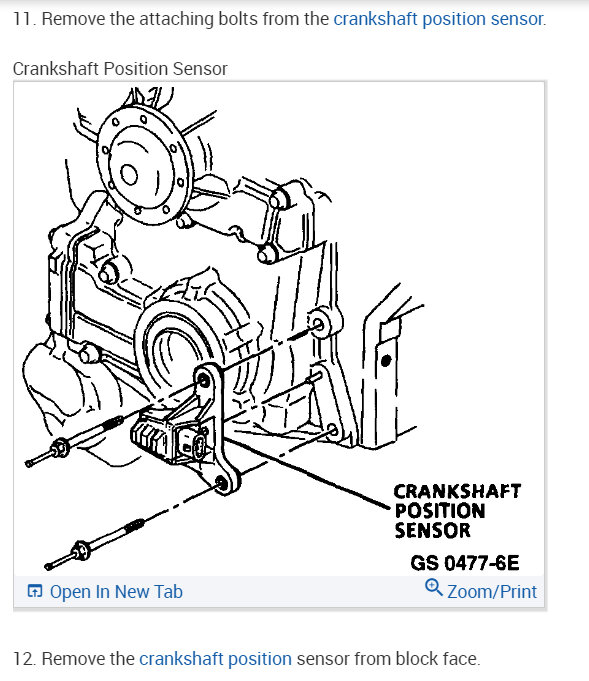

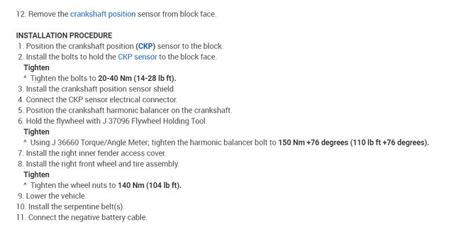

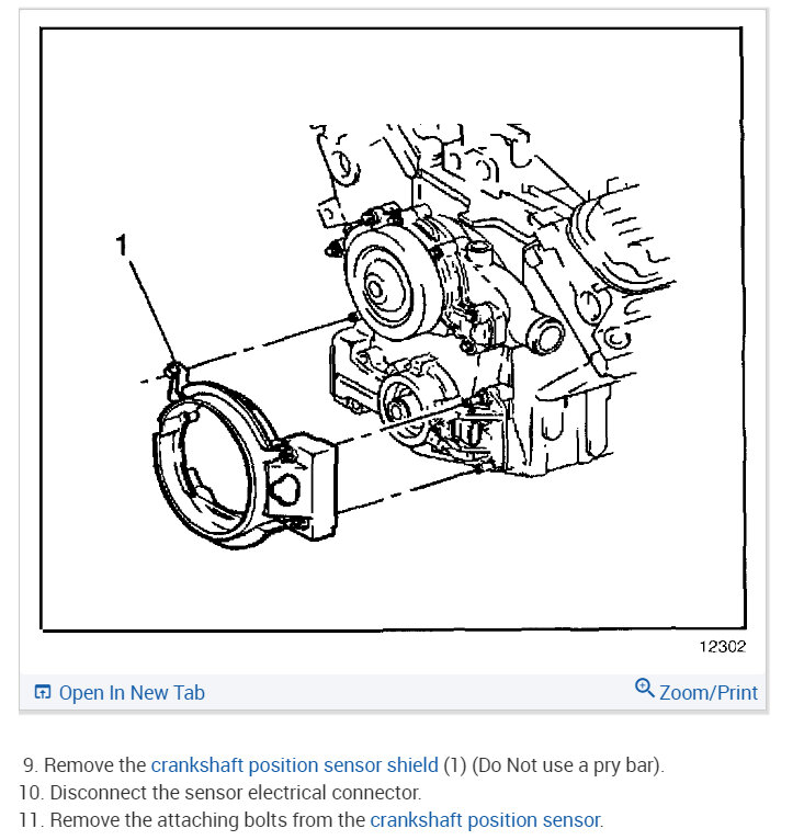

It is common for the crankshaft position sensor to go out and cause this problem. Here is the location and how to change it out. Check out the images (below). Please let us know if you need anything else to get the problem fixed.
