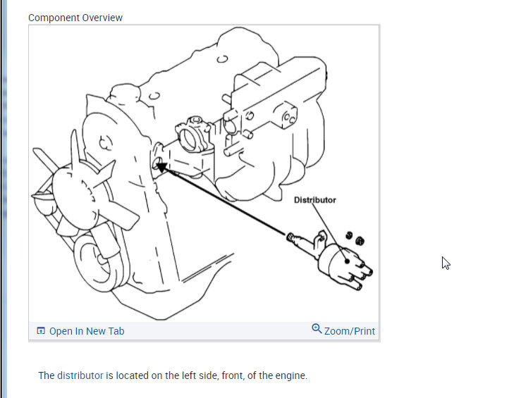

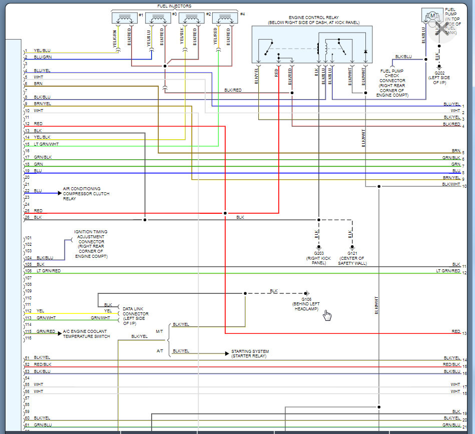

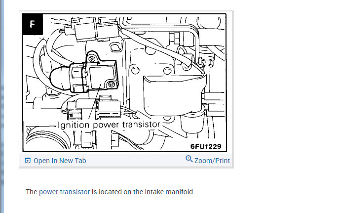

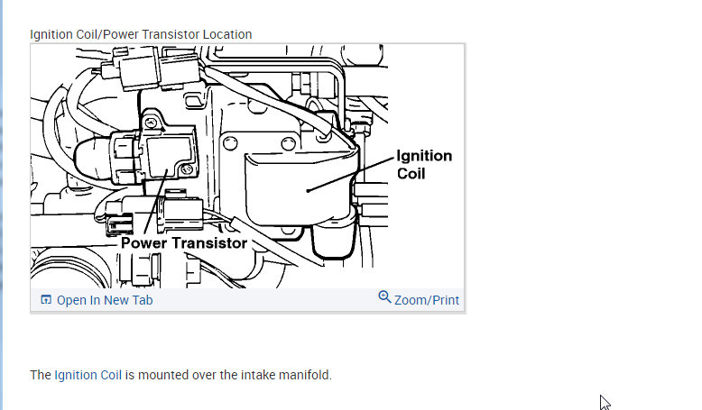

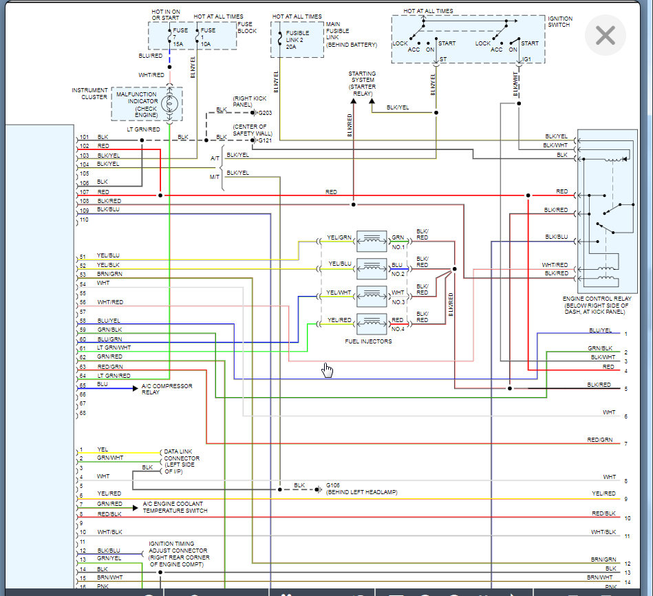

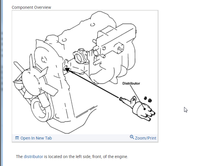

Where is the ICM located?
1994 MITSUBISHI MIGHTY MAX
100,000 MILES • 2.4L • 4 CYL • 2WD • AUTOMATIC
PACIFICISLANDER
  • 239 POSTS

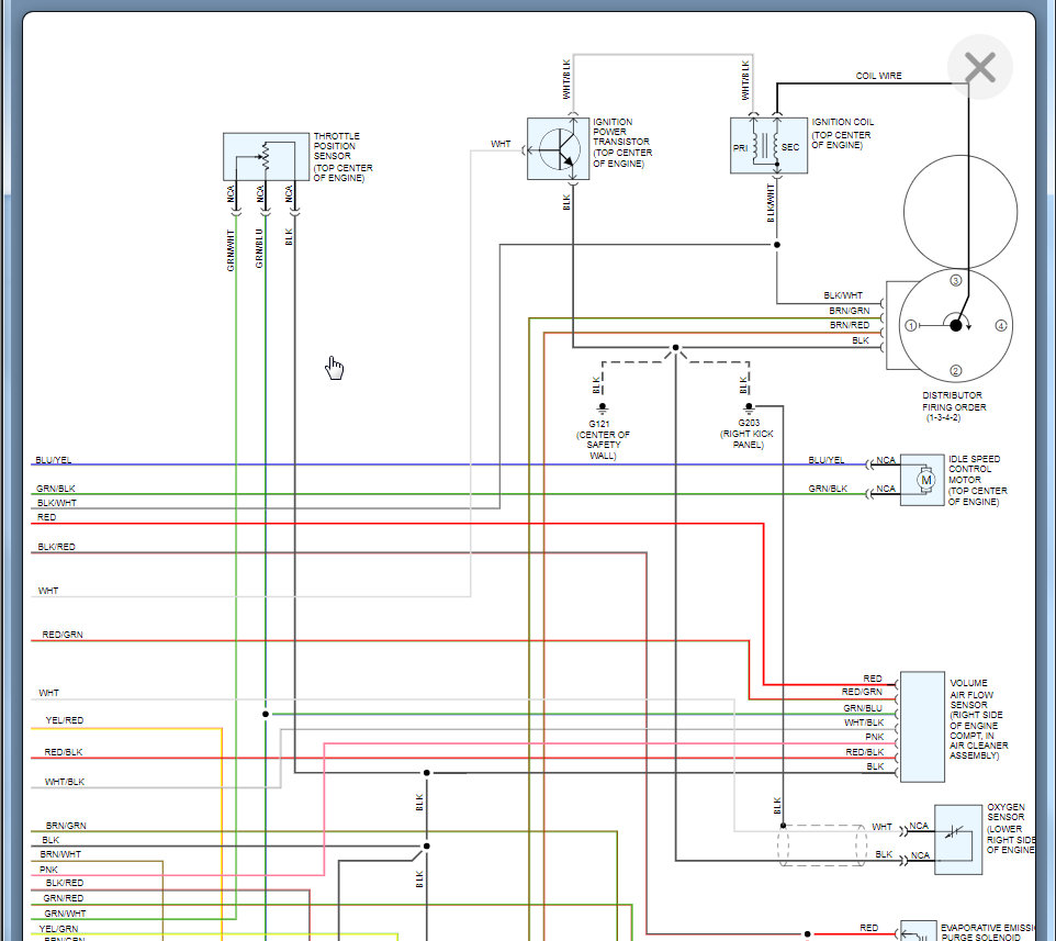

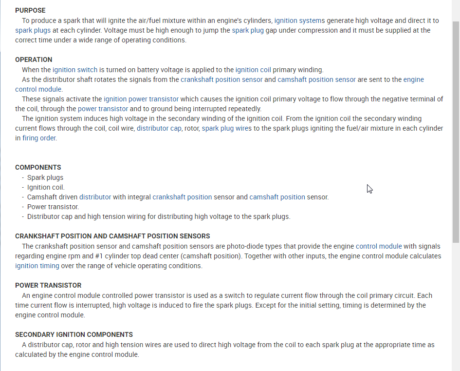

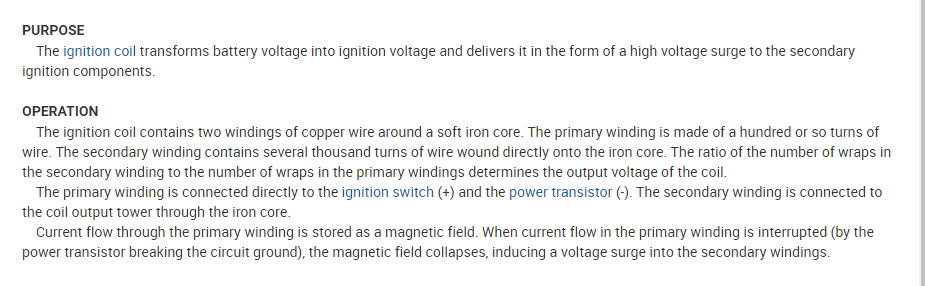

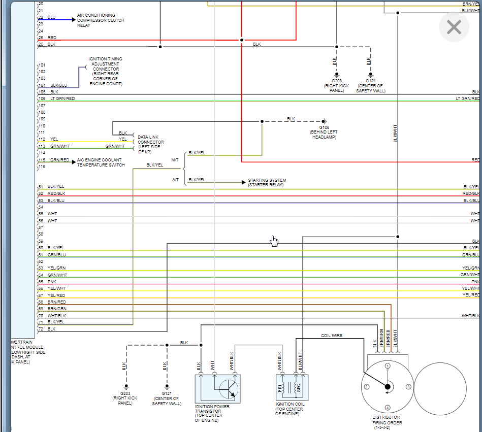

Need to know where is the ICM and components of the distributor to include the location of the ballast resistor.
I'm having problems with the ignition circuit. much appreciated.
May 3, 2021 at 7:27 PM

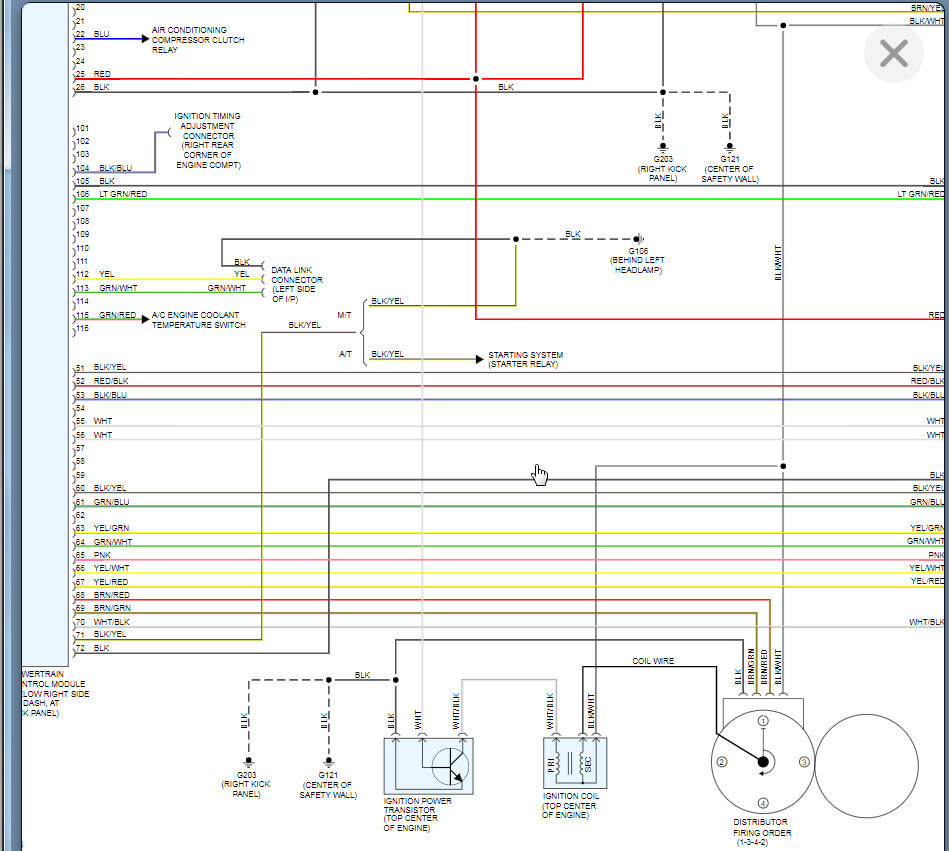

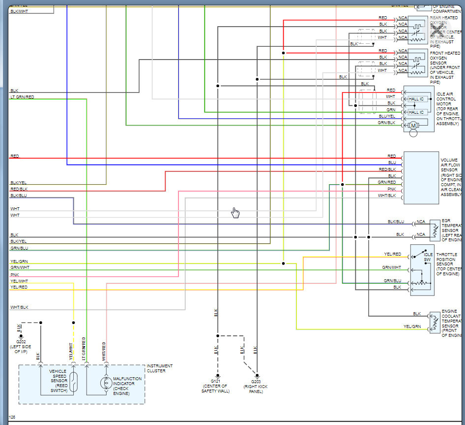

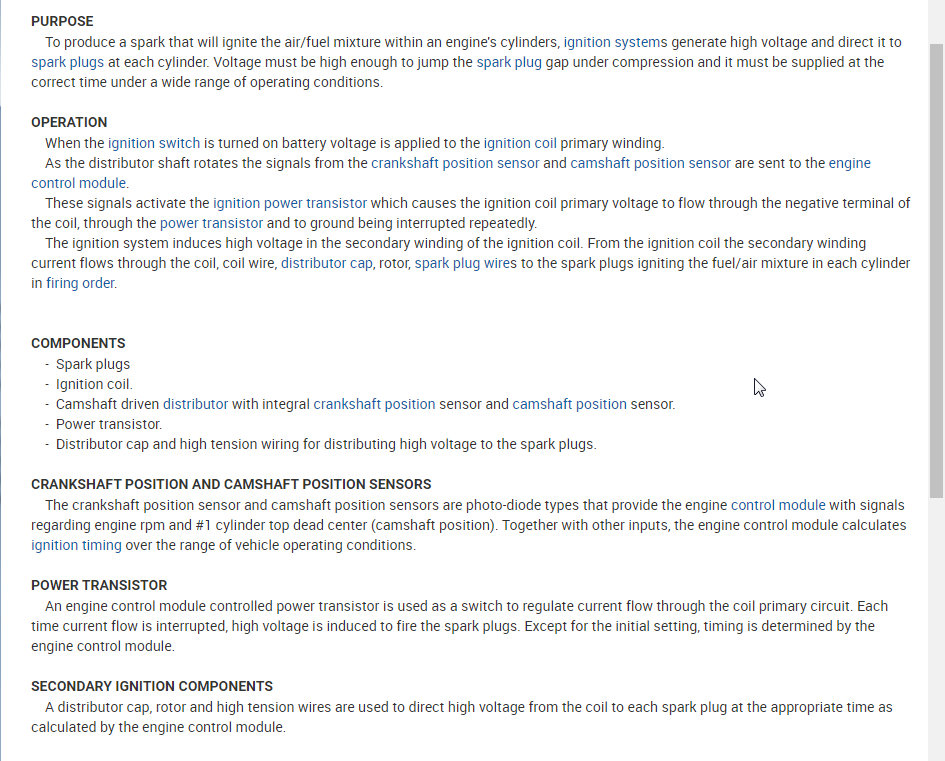

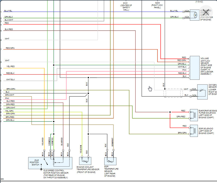

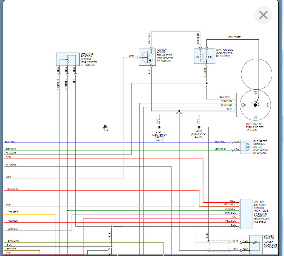

I am attaching all the info on this ignition system. Please run through this and let us know what other info you need.
Below is the info including the wiring diagrams. Thanks
May 4, 2021 at 10:43 AM
PACIFICISLANDER
  • 239 POSTS
Thank you very much, this is exactly what I need to troubleshoot the culprit. thanks

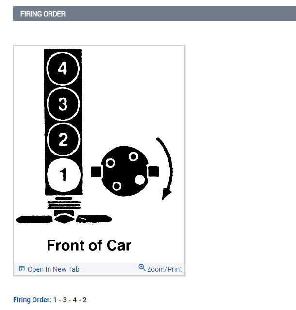

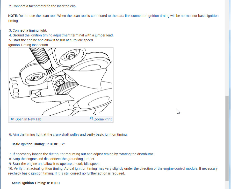

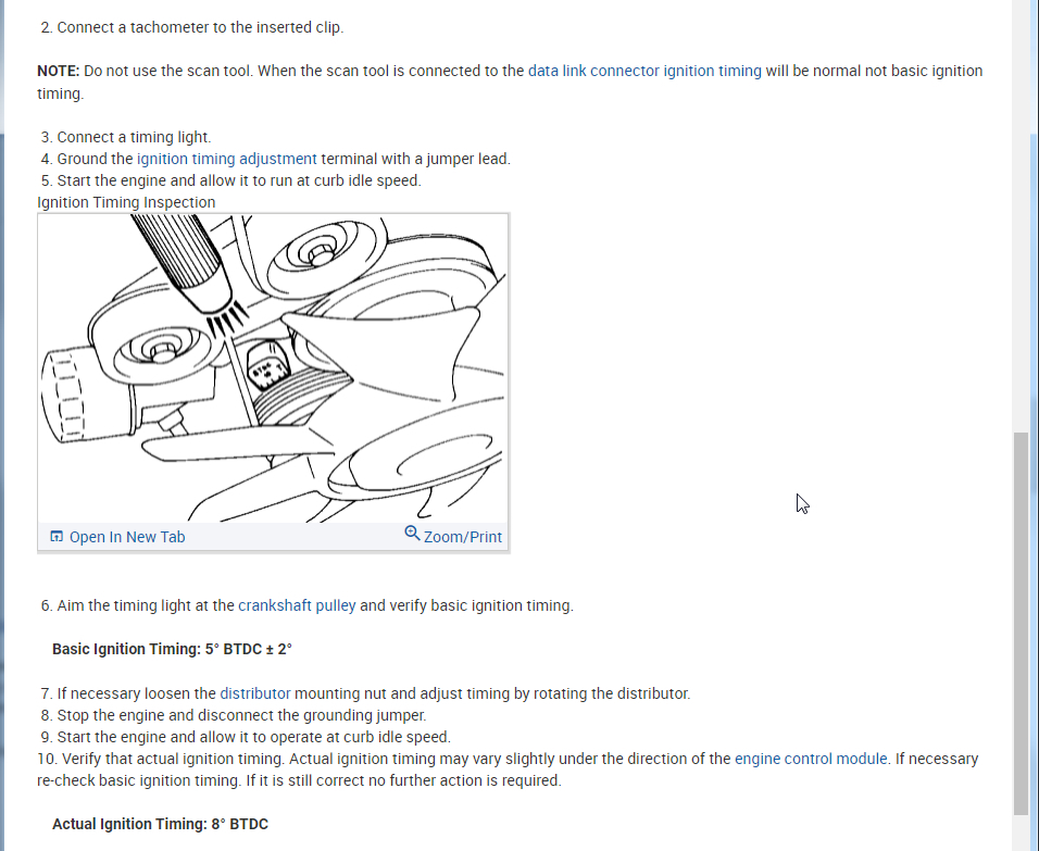

Can I have the firing order and ignition timing?
May 4, 2021 at 6:33 PM
Please see the attached document. Let us know if you need other info. Thanks
May 5, 2021 at 4:07 AM
PACIFICISLANDER
  • 239 POSTS

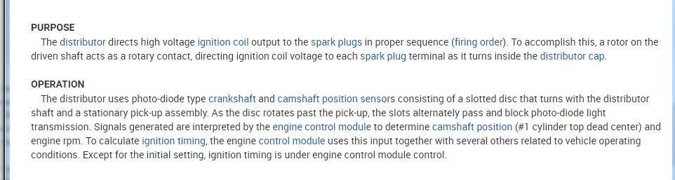

also need ignition timing BTC or ATDC.
May 5, 2021 at 11:03 AM
Timing specs are attached below. Thanks
May 5, 2021 at 11:11 AM
PACIFICISLANDER
  • 239 POSTS
Thank you very much Mr.KASEKENNY1. appreciated it. now I'm ready to deal with it.

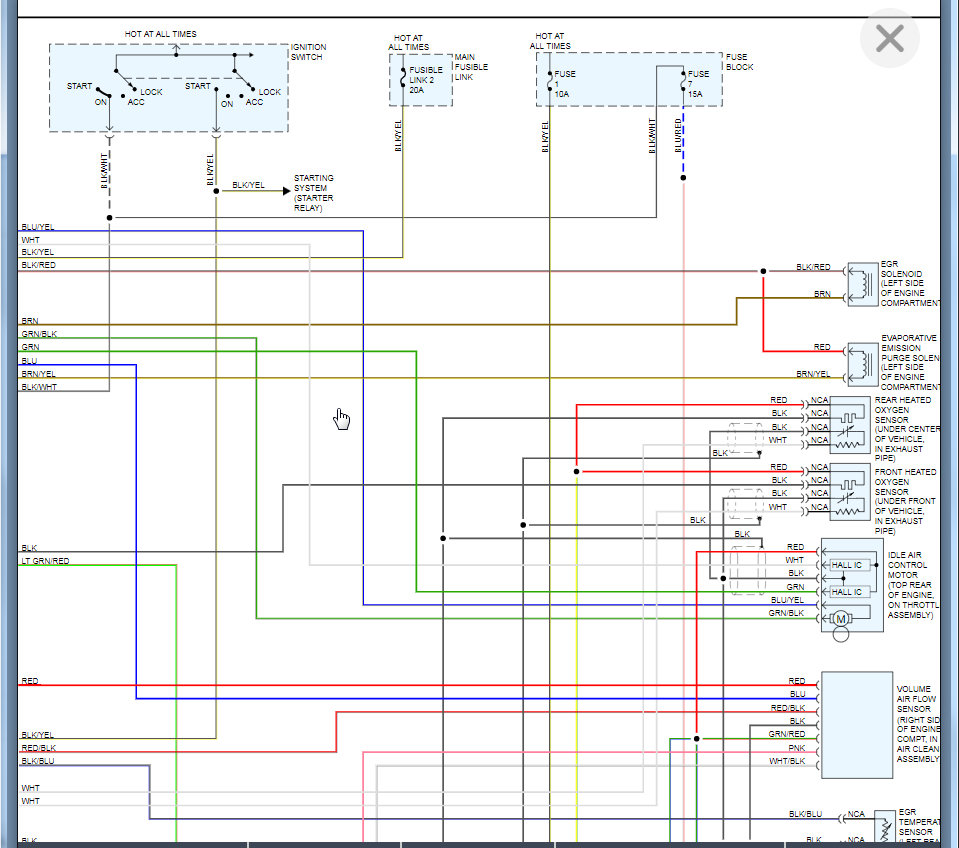

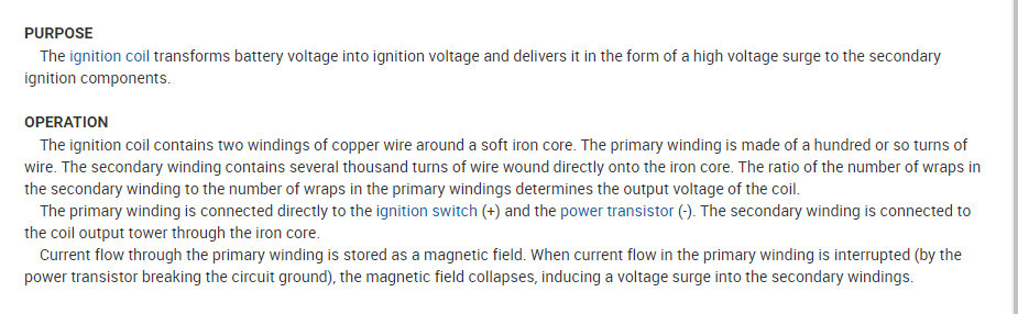

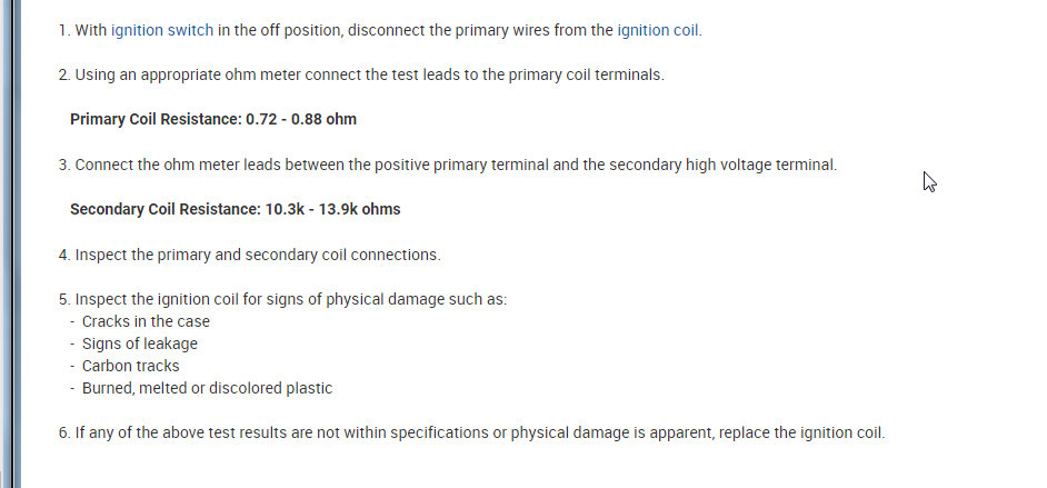

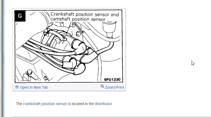

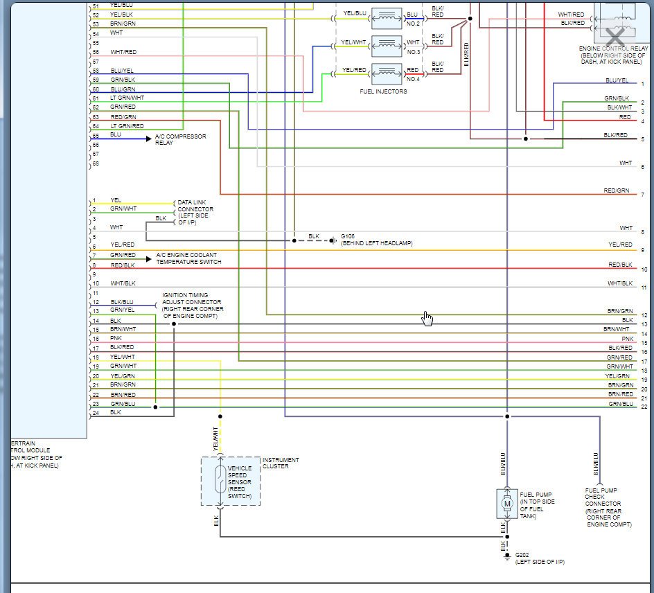

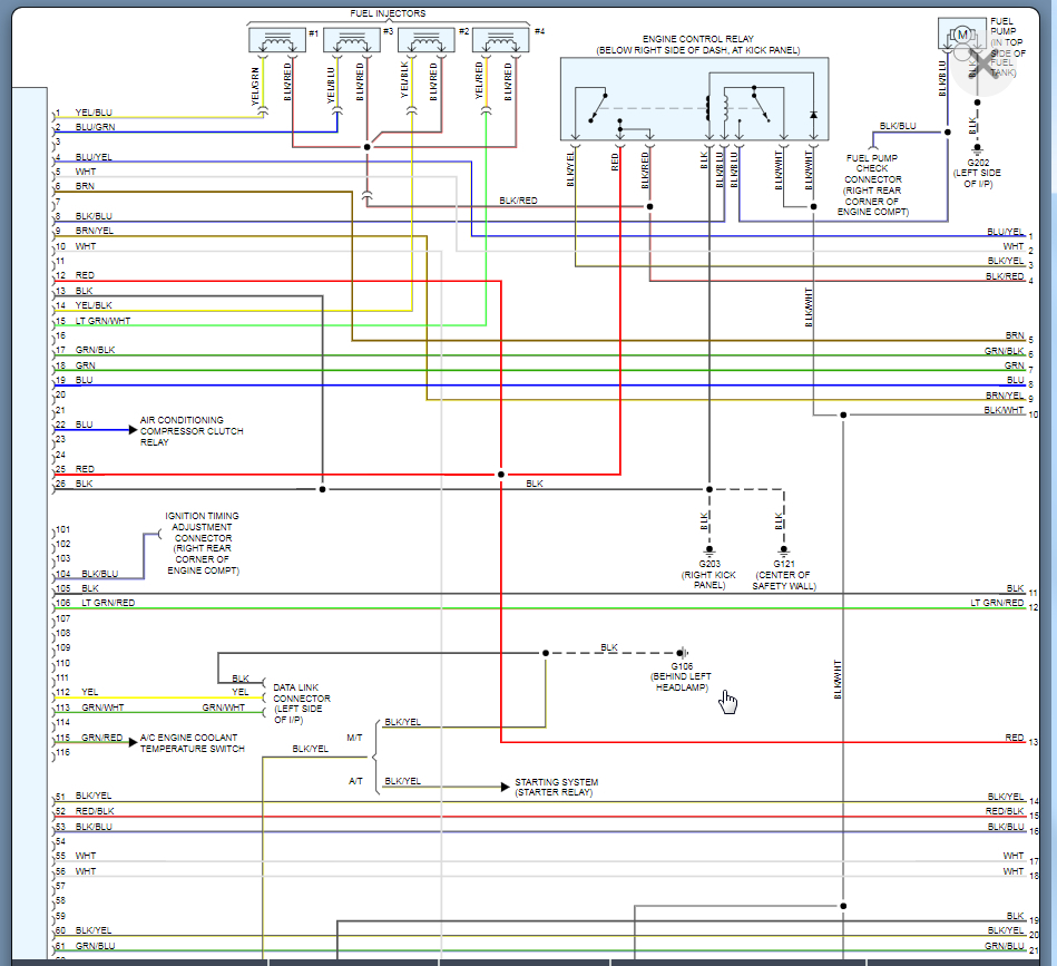

I need the resistances of Pri/Sec windings of the coil and is the ignition control module/crankshaft position sensor in the distributor.
May 11, 2021 at 1:53 PM
PACIFICISLANDER
  • 239 POSTS

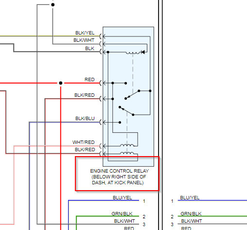

And the engine control relay. Thank you
May 11, 2021 at 6:39 PM

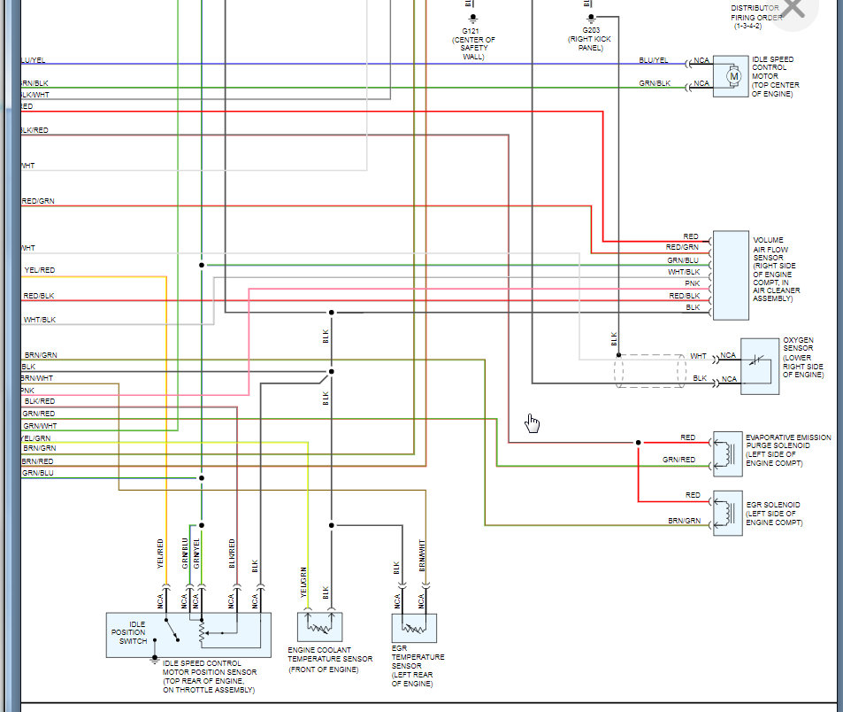

I am attaching each of the items you are requesting. The relay did not have much info but on the wiring diagram it gives a general location. Let us know if you still need more. Thanks
May 12, 2021 at 11:09 AM
PACIFICISLANDER
  • 239 POSTS

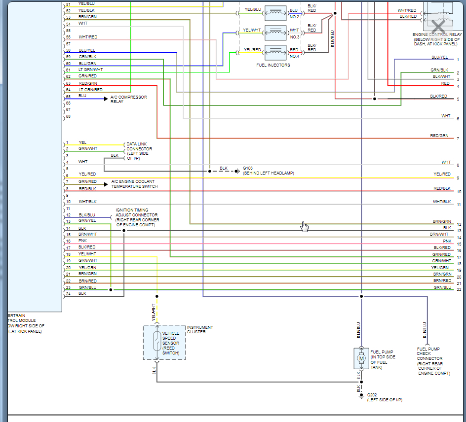

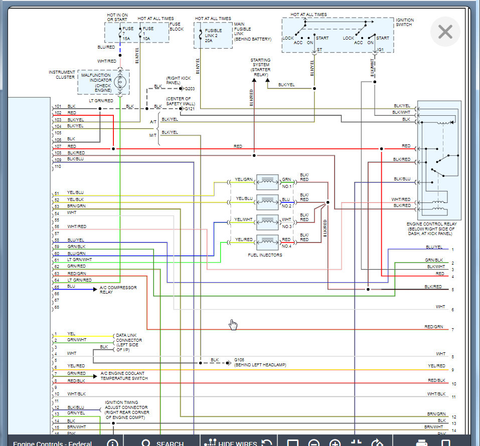

Thank you very much Mr KASEKENNY1, it's the PCM not giving out 5 volts to the crankshaft/camshaft position sensor.
May 14, 2021 at 5:46 AM
PACIFICISLANDER
  • 239 POSTS

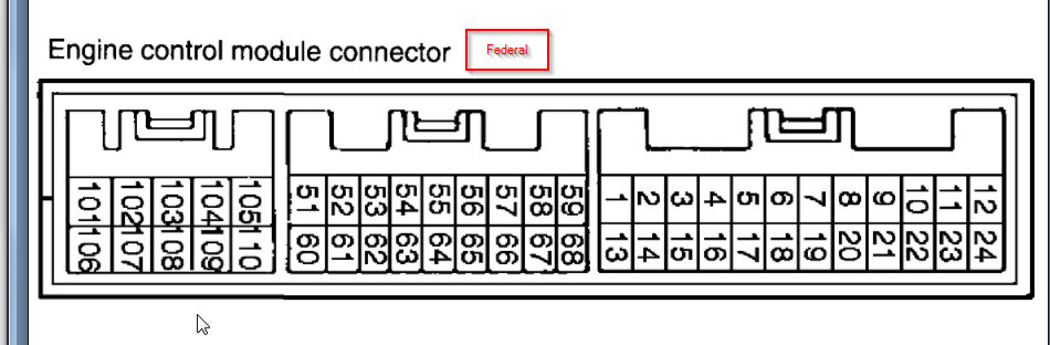

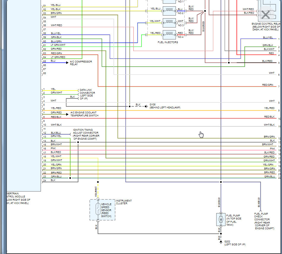

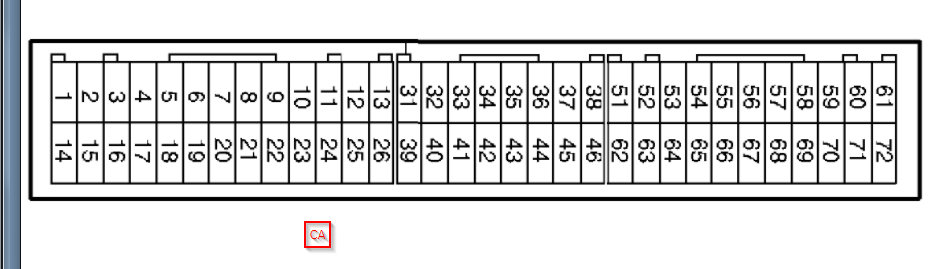

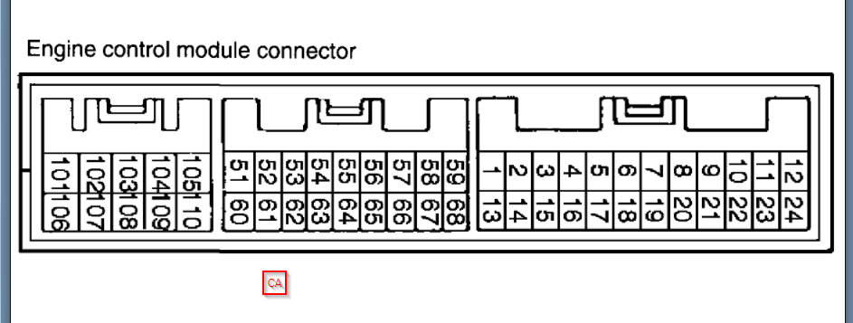

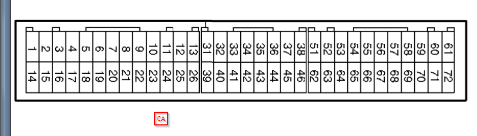

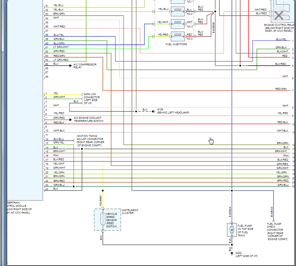

Also can I have a picture of the wiring connector facing the PCM?
May 14, 2021 at 10:40 AM
Sure. The only thing is, the manual doesn't give us the call outs for each pin. They give us the layout but not the chart to go with it.
So I included the complete wiring diagram for the PCM so you can see what each pin goes to and then you can identify which pin that is in the connector.
The first pinouts and wiring diagrams are for CA emissions. The rest are Federal Emissions depending on which you have.
May 15, 2021 at 11:36 AM
