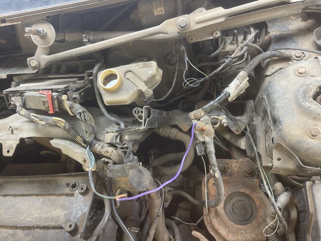

Hi, please may I get the diagram for the IBM / IBS I have a broken wire living the sensor from the negative terminal. I need to know where it goes into the bcm so I can trace and join.

That small broken wire leaving the negative-terminal IBS/BMS sensor should be traced into the local rear battery harness first. Do not assume it runs directly to a BCM pin. Can you please upload an image of the problem so I can see it? Ken

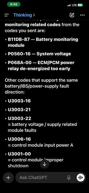

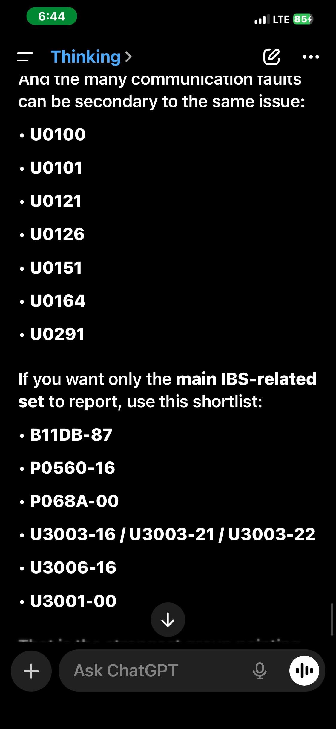

B11D-87. P0560-21. P068A-00. U3003-16. U3003-21. U3003-21. U3003-22

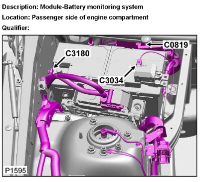

Here is an image that can help. Check out the images (below). Let us know what you find.

This image does not resemble mine.

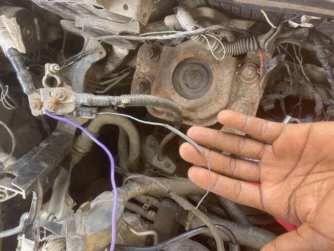

ANDRIN ATEM
  • 410 POSTS
I need to understand where this broken ins sensor wire connects to, am searching to find the other end wire, can’t see, which is why I requested a diagram to guide me.

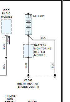

  • 55,433 POSTS
Those are ground wires, so that wire will go to the battery monitoring sensor. Check out the images (below). Let us know if you need anything else.

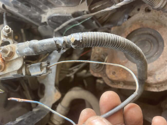

ANDRIN ATEM
  • 410 POSTS
You still don’t understand what I need. That broken piece of wire, leaves the battery monitoring module attached to the negative terminal of the battery, leaving that ibs sensor, where does it connect to? I don’t need ground connections. On that image above, shows both the sensor and the broken wire.

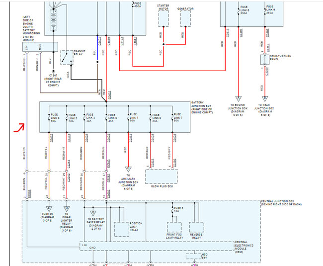

  • 55,433 POSTS
Okay, I found it, it goes to the central fuse box behind the right side of the dash. Check it out. Check out the images (below).

ANDRIN ATEM
  • 410 POSTS
You got it right this time. I can see same color goes all the way to the central junction gate box behind right passenger side.
