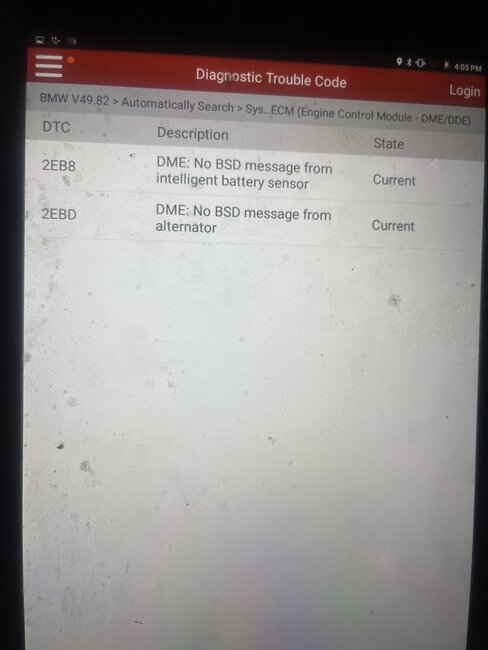

IBS 2EB8 codes?
2009 BMW 550I

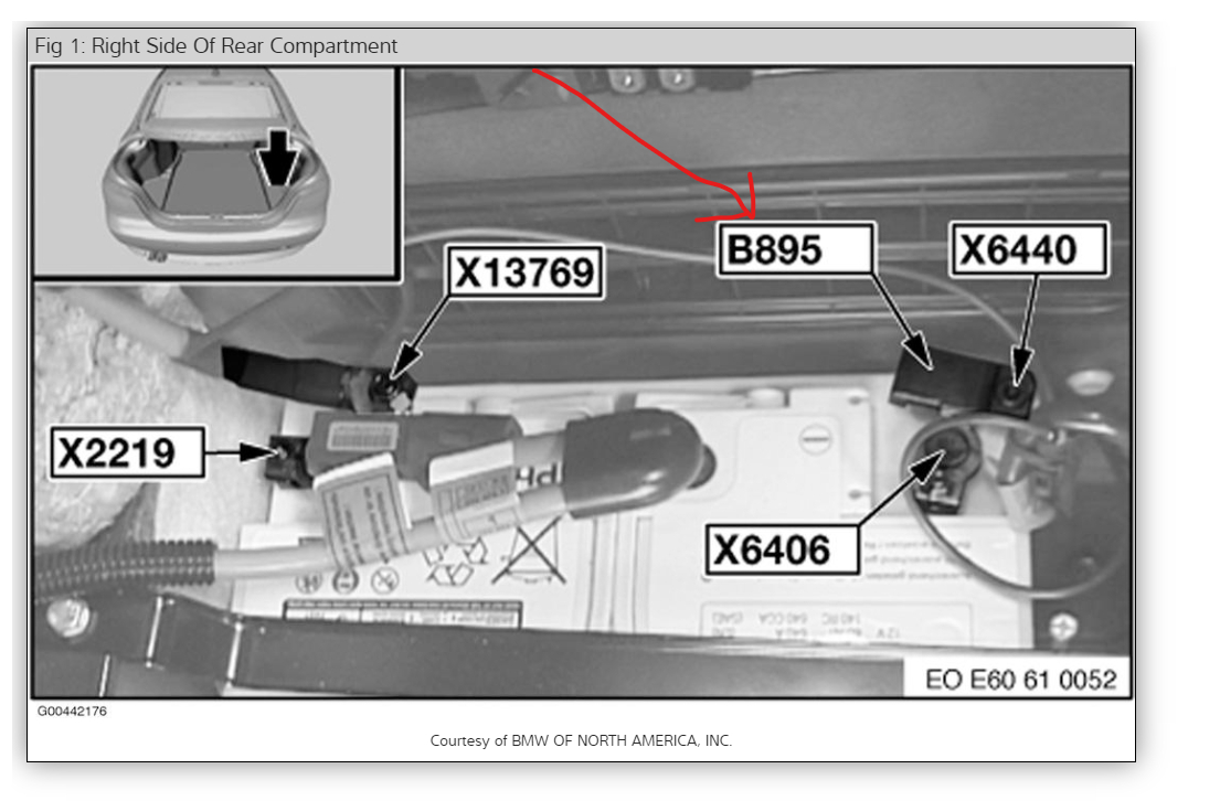

changed it because I was getting a code for it but I am still getting these codes.

Yep, the battery sensor being bad can cause both of these codes here is how to fix it
Repair instruction
Notes on intelligent battery sensor (IBS)
REP-ALG-RAF0161-6112IBS - V.19
Note! Do not connect the charger to the 12 V charging socket
The 12 V charging socket is supplied with voltage by the rear power distribution box via relay. This relay drops out after terminal 15 OFF. This means that a battery maintainer connected at the 12 V charging socket will be disconnected from the battery. Only charge the battery via the jump start terminal. Only then can the voltage supply be registered by the vehicle.
Warning! Danger of destruction in event of mechanical strain
Do not introduce any additional connections at the battery negative terminal.
Do not modify the grounding cable. The ground cable also serves heat dissipation.
Do not establish any connection between the IBS and the sensor screw.
Do not use force when disconnecting the terminal cover from the battery terminal:
Do not pull on the ground cable.
Do not place any tools under the IBS to lever off the terminal cover.
Do not use IBS connections as levers.
Use a torque wrench and set tightening torque in accordance with repair instructions.
Do not release or tighten down sensor screw (Torx screw).
Avoid contact between IBS and ground.
Warning! Danger of destruction to IBS and wiring upon battery replacement. The IBS and wiring can be destroyed by mechanical strain upon battery replacement. Therefore, avoid mechanical strain.
The size (capacity) of the battery required for the car is coded in the Car Access System (CAS).
Use the battery size (capacity) installed standard upon battery replacement.
Recode the Car Access System (CAS) when installing a battery with a different capacity.
Register battery replacement via service functions in diagnostic system.
Delete fault code entries in the Digital Engine Electronics (DME) associated with battery replacement.
Always proceed in accordance with the repair instructions.
Note: Battery draining possible in spite of the intelligent battery sensor IBS being fault-free.
A battery can be drained (e.g., with lights or radio switched on) even when the IBS functions perfectly in conjunction with power management.
For this reason, only exchange the IBS when there is a corresponding fault code entry! Clear the codes once the repair is complete. Check out the images (below). Please let us know if you need anything else to get the problem fixed.

I replaced it twice, same results.

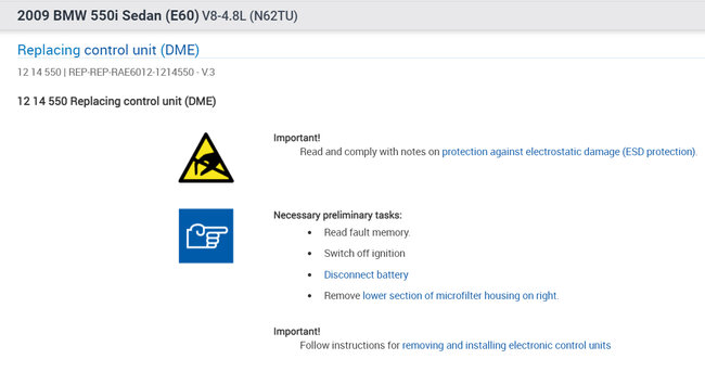

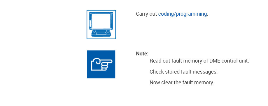

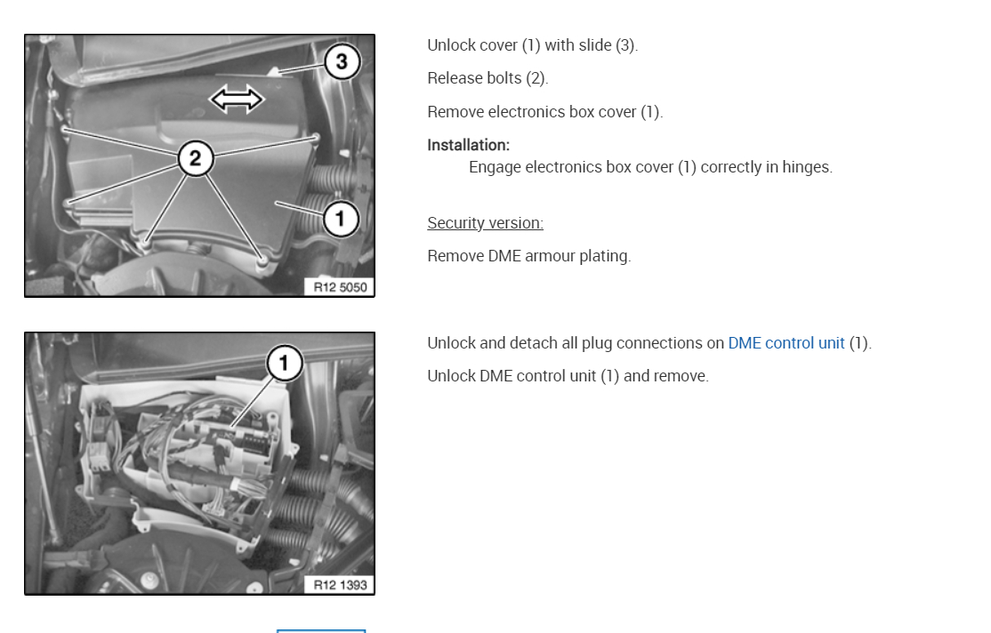

What is the voltage at the battery? If okay I would replace the DME control with a rebuilt unit, you can get a preprogrammed unit by searching Google or Ebay. Here is the location so you can change it out. Check out the images (below). Please let us know what happens.

I really doubt the computer has gone bad.
Jan 31, 2023 at 3:04 AM
  • 55,433 POSTS
I think it is the DME because it is not sensing the correct voltage which creates the trouble code.
