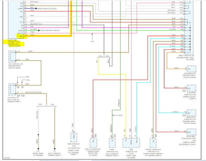

I took my car to a parts retailer; they hooked up their OBD-Ii scanner to see why the engine light and anti-skid light were on.
The scanner did not connect. Can you tell me and hopefully show a picture of where the fuse is for this or how the fuse is labeled?
May 8, 2024 at 10:32 PM
  • 110,194 POSTS

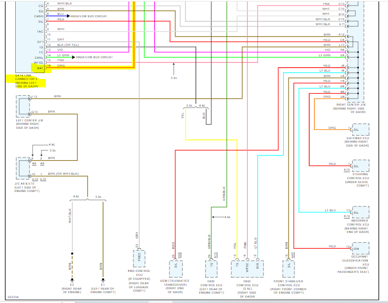

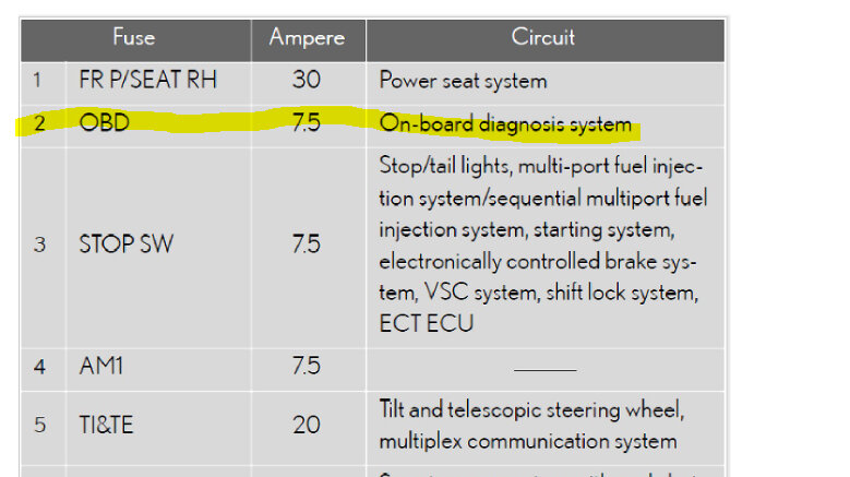

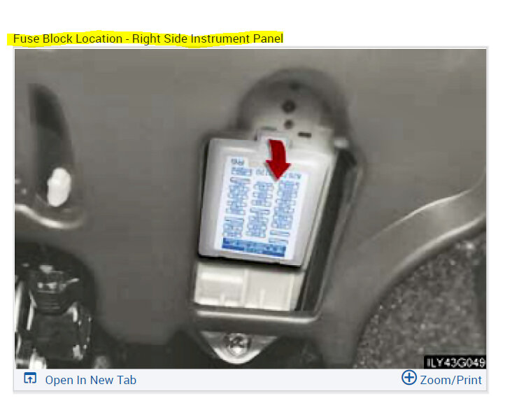

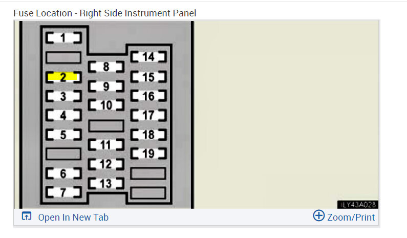

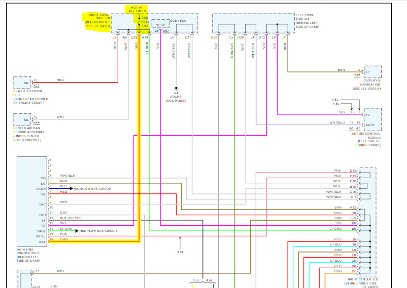

As far as the fuse is concerned, it is on the right side of the dash. It is fuse 2 (7.5A) and should have power at all times.
If you check pin 16 at the data link connector, it should have battery voltage.
If you look below, I attached the wiring schematic, the legend of fuses for the fuse box I'm referring to, and the fuse to check.
