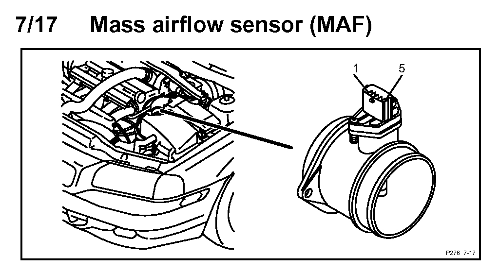

Where is the IAT sensor located at in detail please?

The IAT on this vehicle isn't a separate component. The intake air temperature sensor is integrated into the mass air flow (MAF).
Here is a link that shows in general how to replace one:
https://www.2carpros.com/articles/how-to-replace-a-mass-air-flow-sensor-maf
_________________________
The MAF sensor is integrated into the air intake tube between the air filter box and the throttle body. See pic 1.
To remove it, simply disconnect the electrical connector and then there are two bolts (one on each side of the sensor) that need to be removed. Remove the bolts and sensor.
Install is the reverse of removal.
