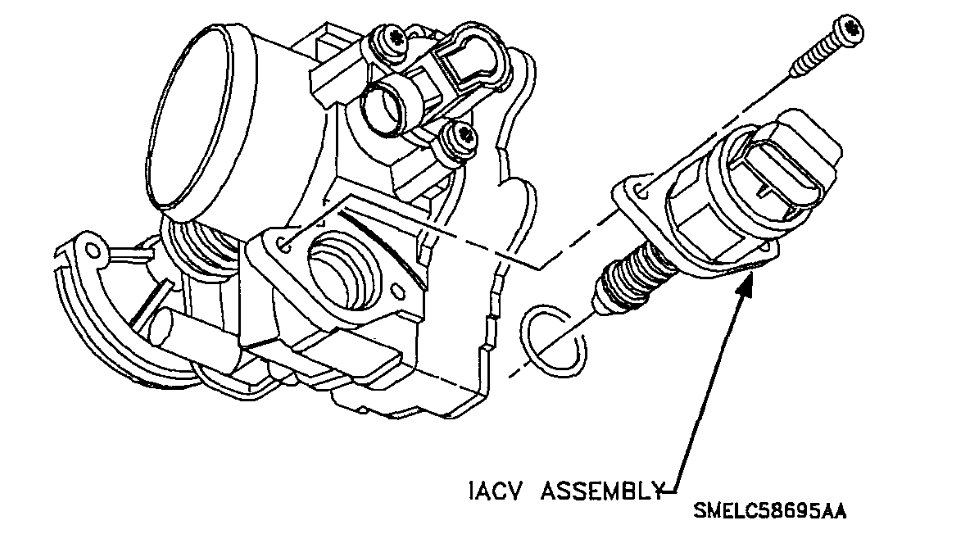

IACV changed cleaned and car still stalls. ECTS new. Everything is new. Still does it after I took it to Firestone for motor mount change.

Did you just clean the IAC valve or replace it? It cannot be cleaned as the area that is carboned up is not accessible.

^ IAC System.
