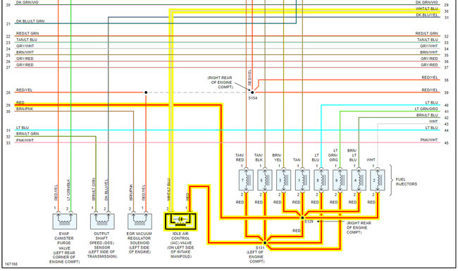

Went to clean the IAC and discover there is no wiring harness pigtail, and I can't find where to hardware the new pigtail. please help me!
Oct 14, 2021 at 6:02 AM
Good morning,

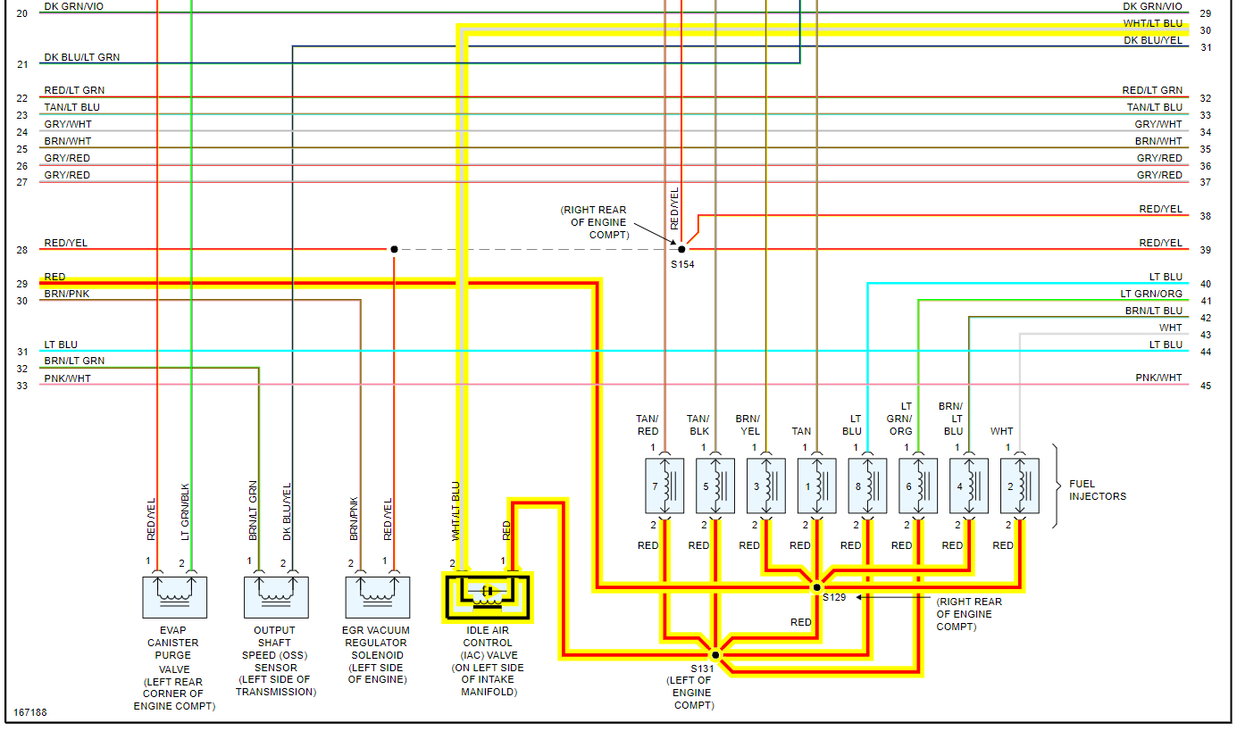

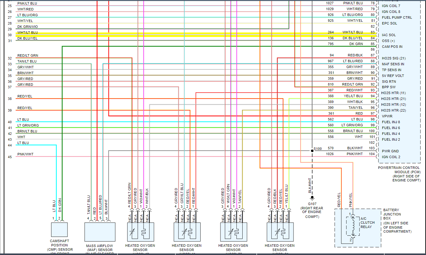

I attached the wiring diagram of the IAC for you below. It shows the color wires for the solenoid.
https://www.2carpros.com/articles/how-to-replace-an-idle-speed-control-motor-iac

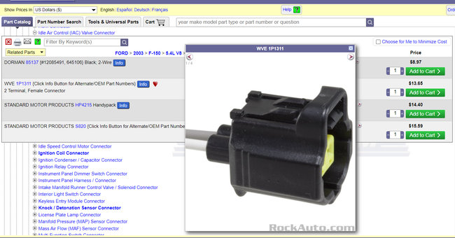

I also attached the connector available from Rock Auto for the end of the harness.
Let me know if you have any other questions.
Oct 14, 2021 at 6:41 AM
BOBBY ROE II
Thanks so much for the quick reply the diagram saved me a lot of time that I just don't have... found the correct wires, spliced in and now it's good to go. Once again I appreciate it, worked out great!
