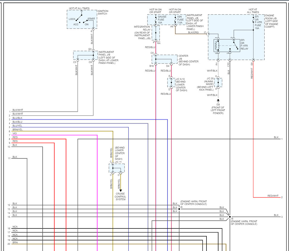

IAC Valve wiring diagram needed?
2002 TOYOTA COROLLA
230,000 MILES
IBRAH1098IB

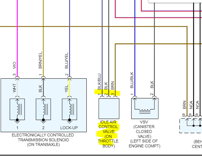

want to know which color goes to each pin. It's a 3 pin IAC.

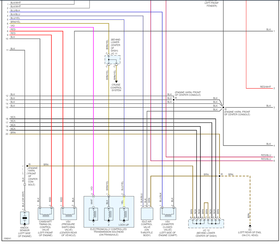

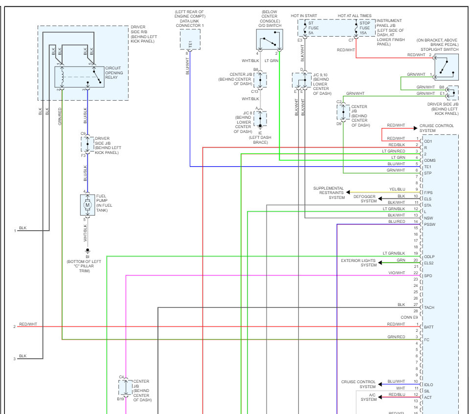

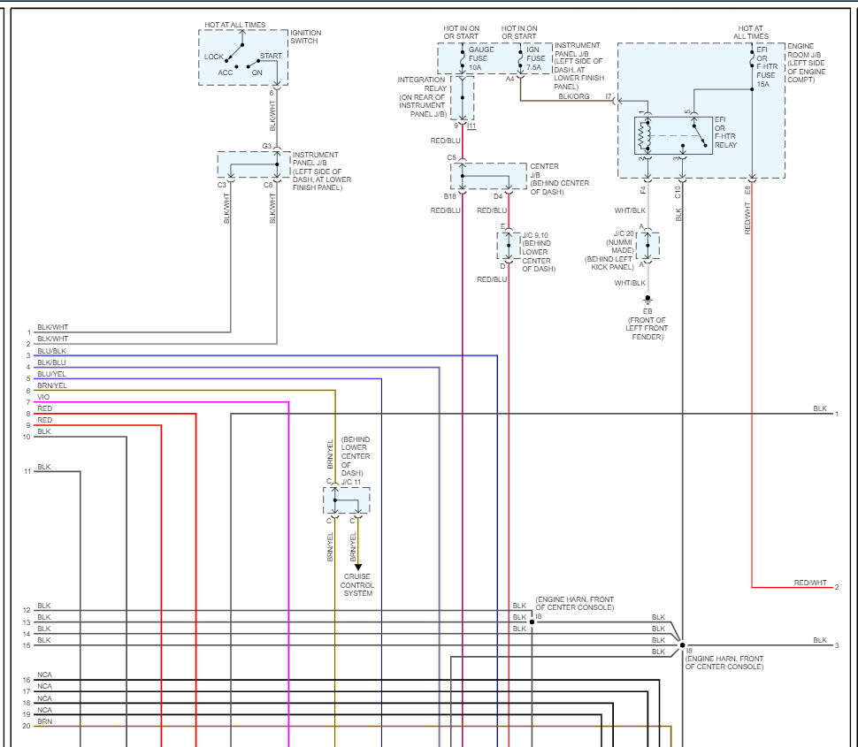

Yes, the wiring diagrams show three wires to the IAC motor. Here are the wiring diagrams which are included in the engine wiring. I also included a guide to help you test the connections as well.
Please check out the images below and let me know if you need anything else.
Feb 14, 2023 at 3:58 AM
  • 110,240 POSTS

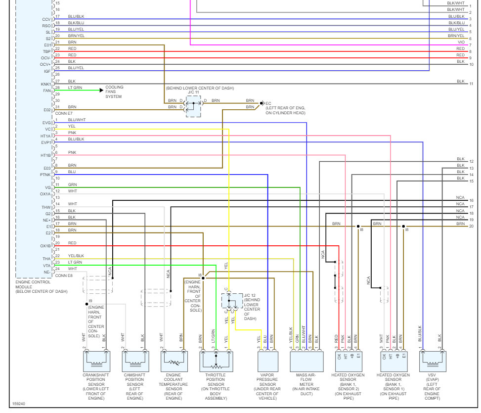

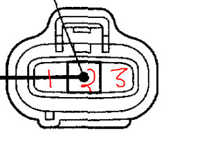

I tried finding a pic that showed specifics but was unable. So, I had to do it this way.
If you look at pic 1, the schematic indicates the wire color and pin it goes to. Pic 2 is the connector view. I numbered the connectors.
