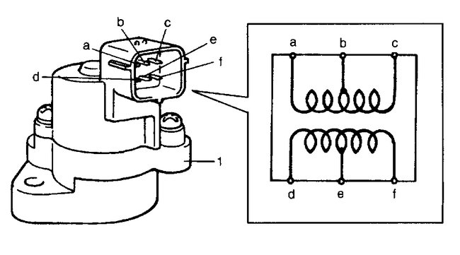

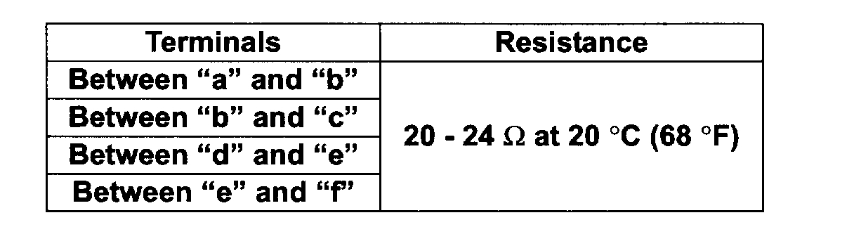

Good day, does the IAC valve cause a vehicle to hard start? Could it be the ignition switch causing the vehicle to hard start? Most parts were changed in the vehicle as mentioned before {battery, camshaft sensor, neutral/park safety switch, ignition coil packs, plugs, engine temperature sensor, even the starter was serviced}. I was told to check the resistance of the IAC valve which is 16 ohms as well as the IAC valve does not move back and forth when tested. I am at a lost here, as I feel I am spinning top in mud.

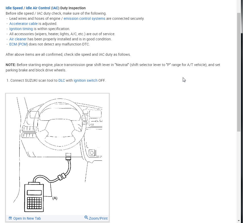

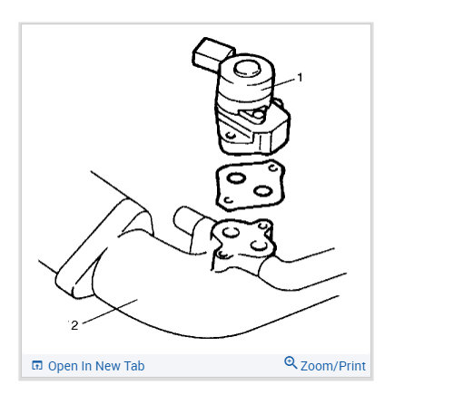

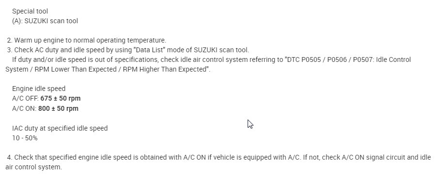

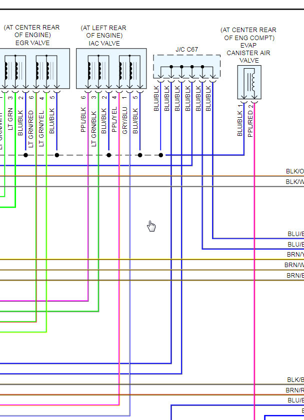

If you want to test the idle air control valve, here are the directions for on vehicle testing. The attached pictures correlate with the directions.

IDLE AIR CONTROL (IAC) VALVE ON-VEHICLE INSPECTION
1. Disconnect connector from IAC valve (1).
IAC Valve Resistance
pic 1
pic 2
2. Check each coil of IAC valve for resistance. If resistances is out of specification, replace.
3. Remove IAC valve (1) from intake collector.
4. Connect connector to IAC valve (1).
5. Check that plunger of IAC valve (1) moves once and then stops as soon as ignition switch is turned OFF.
If plunger of IAC valve (1) does not operate at all, check wire harnesses for open and short. If wire harnesses are in good condition, replace IAC valve (1) and recheck.
