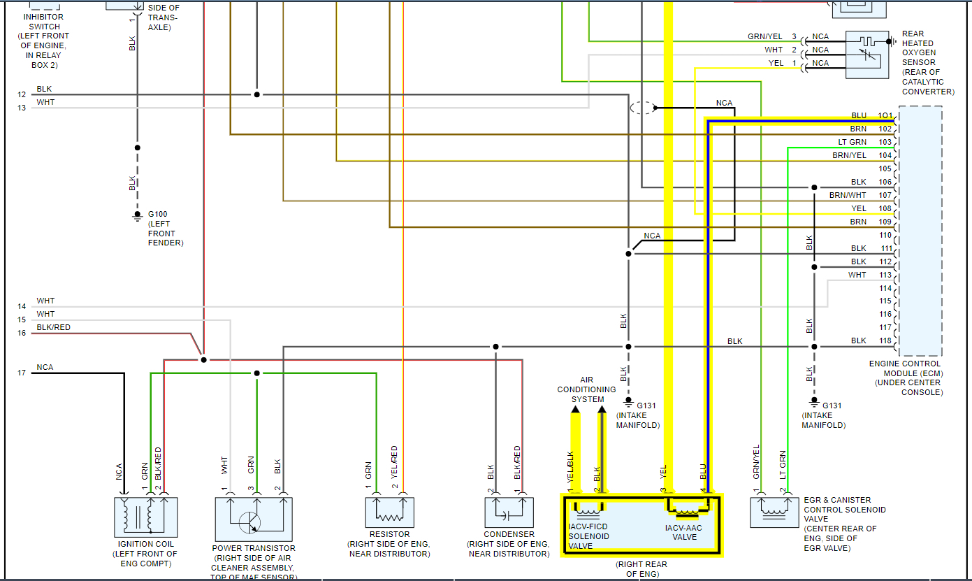

Help, I have the car listed above that has an IAC code that refuses to clear. I believe the IAC is perfectly fine because the code has been there for over 6 years and has no trouble starting or accelerating, but none of my code readers will make the code go away. I've never had a code stay stuck like this. I've seen them come back after starting the vehicle but this ones stuck and it has got me stuck. any help is useful.

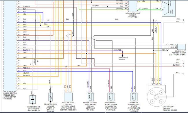

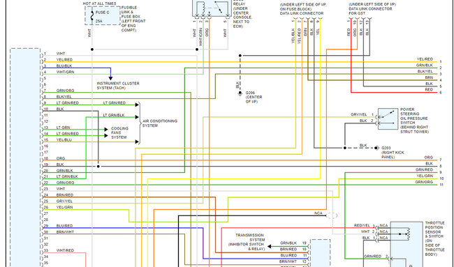

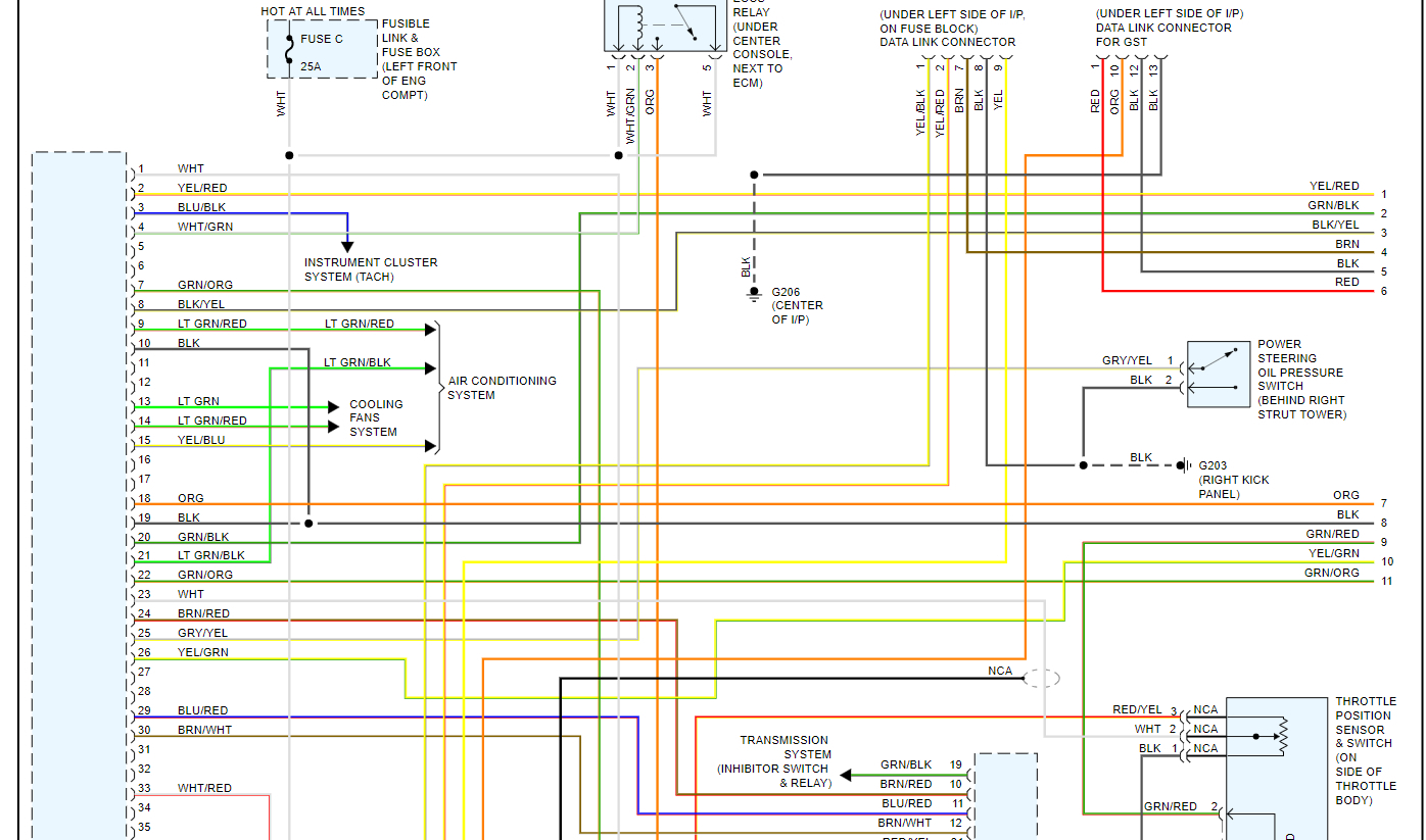

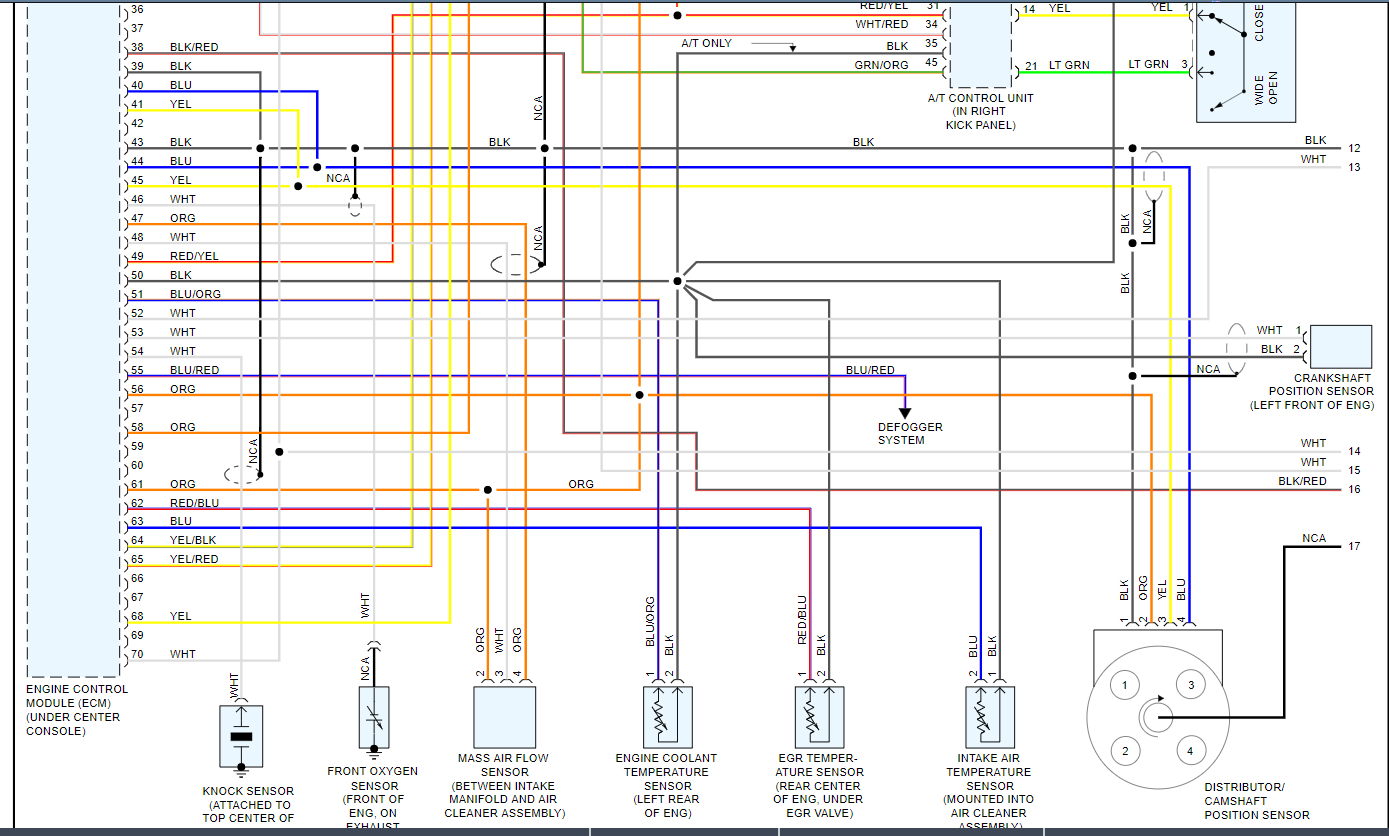

I attached the flowchart for you of the code below.

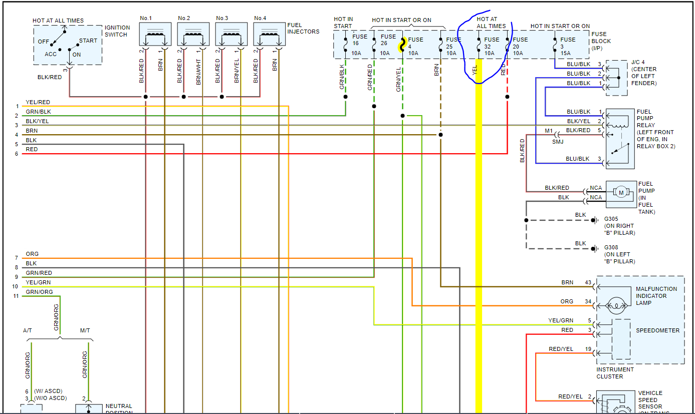

I also attached the wiring diagram of the system. Check the fuse I circled for power to the valve itself.
IACV-AAC VALVE

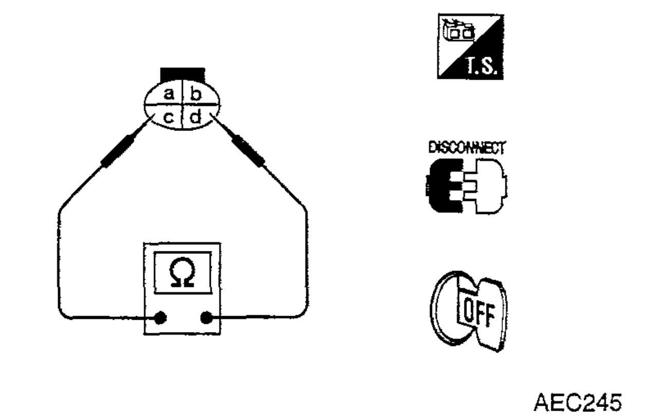

Disconnect Idle Air Control Valve-Auxiliary Air Control Valve (IACV-AAC) valve harness connector
^ Check IACV-AAC valve resistance.
Resistance: Approximately 10 ohms
^ Check plunger for seizing or sticking.
^ Check for broken spring.
