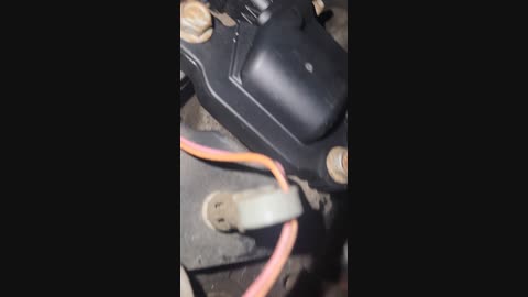

JT856
  • 7 POSTS
Well, now my car doesn't want to start now... I'm not sure if it's the ignition coil harness wire lead or not really sure what could be the problem. Was driving and my car had lost power and had to park on the side of the road where i was at and then it shut off and it didn't want to start up no more.

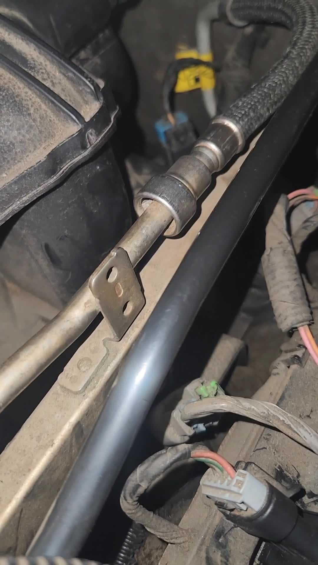

Is it possible to remove the hose? And how can i remove it? And the other thing, is that the fuel pressure regulator? i had codes for cylinder 1 and 2 code 302 (1 and 2 ) and code 523 ( oil pressure sensor) the sensor is new.

Are you referring to the fuel supply hose? There's more than one design shown for your truck. If your fuel pump assembly has three ports, or tubes, there should be a pressure regulator on the fuel rail on the engine. Most of the time that rail will have a pressure test port.
The pumps shown all appear to have the pressure regulator built into that assembly, so the regulator is in the tank. Then there's a chance there is no test port by the engine. In that case you remove the supply hose and insert a special hose with a temporary test port on it. All fuel pressure test kits include a lot of different fittings including that special hose. You can find this kit at any auto parts store that rents or borrows tools. In my city they make you buy the tool, then you get a full refund when you take it back. If you choose to keep a tool, you still take it back, then they order or give you a brand new one.
This is the way GM fuel pumps typically fail. Chrysler fuel pumps almost always fail to start up, leaving you sitting in the driveway or parking lot. They can often be started by banging on the bottom of the gas tank, but that's just a temporary fix. Once they do start up, they practically never quit while you're driving.
GM fuel pumps almost always start up, then they quit or run slower during the drive cycle. If you let them sit and cool down for a few hours, they may start again and run long enough to get you home.
When you disconnect a fuel supply hose, it is easy to misinterpret the fuel you see spraying out. Typical pressure is around 50 psi, give or take. Just five pounds is plenty to spray you in the face, but a lot of GM engines won't start or will stall if the fuel pressure is as little as five pounds too low. Normally when diagnosing a crank / no-start condition, if it's caused by low fuel pressure, it will be way more than just five pounds too low, so there won't be confusion as to whether that is the cause.
A fast way to skip these tests is to open the fresh air supply tube and spray in some starting fluid. If the no-start is fuel-related, the engine will run for a few seconds on that fluid.
I still would check for spark. If that is missing, too much starting fluid will wash the oil film off the cylinder walls. That just adds one more variable, (low compression), to the problem.
At the very beginning of your video, you're looking at what is likely the fuel supply hose. You need a very inexpensive special tool to release those. They come in various designs, but all include a collar that goes around the metal pipe, then it is slid into the metal barrel. You'll likely need to push the rubber hose further onto the metal pipe while inserting that tool. The collar will lift up the barbs, or hooks, that hold the barrel onto the metal pipe. Once the hooks are retracted, just slide the hose off.
I'm not sure what I was seeing at the end of the video. It looks like an older Chrysler-style fuel filter with no rubber hose attached at the nipple. Was that for something else?
