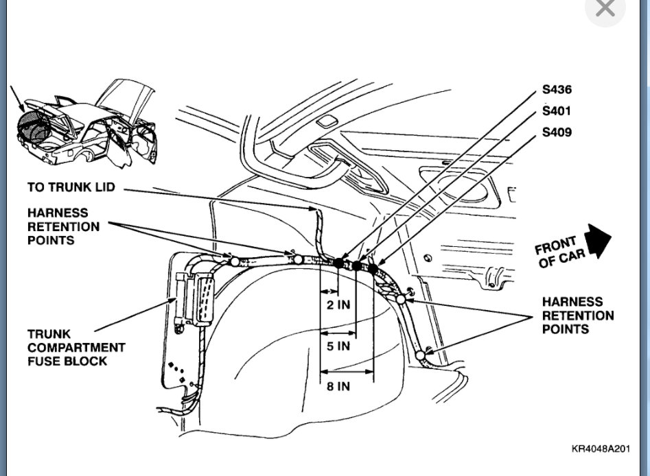

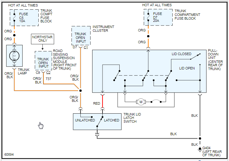

I need to know where the extra plug goes in the trunk for the lid that automatic closer on the 'car listed above. there's one plug that plugs in at the bottom and there's one hanging. what is that plug for?
Nov 29, 2020 at 7:34 AM
I attached the info on this pull down latch. It looks like you have a connector from the fuse and one to the latch. Can you get pictures of the connector and the wires that are on it and we can try and identify where it goes? Thanks
