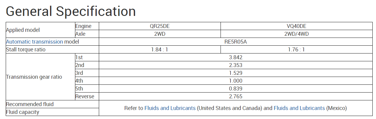

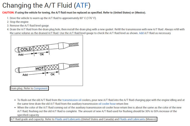

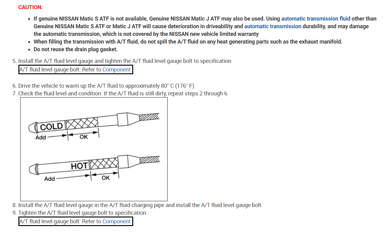

Hello, I need step by step instructions on how to change the transmission oil.
Thank you
May 23, 2021 at 10:00 PM
Experienced Mechanic
55,649 POSTS
Here is a guide to help you step by step with instructions in the diagrams below to show you how on your car with fluid type and capacity:
This video shows the job being done on a similar car but the process is the same:
https://youtu.be/FglBsUEOSEk
