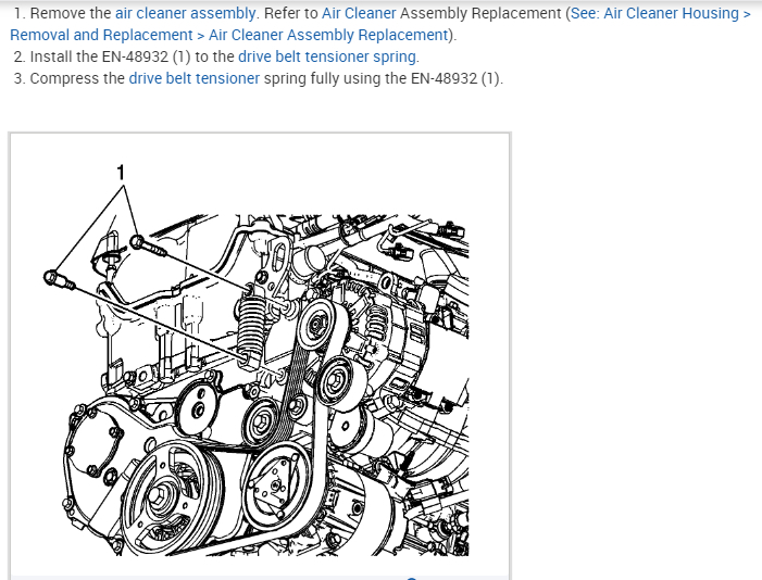

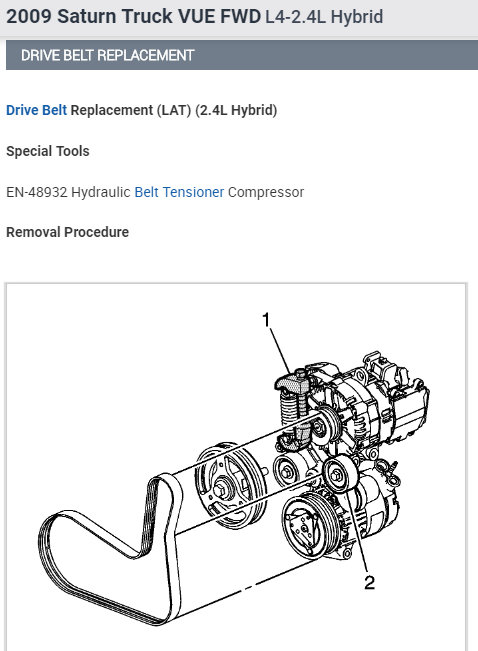

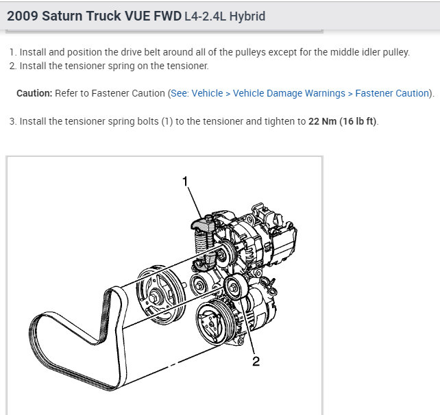

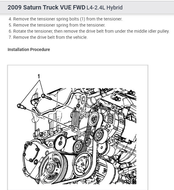

I was trying to put a new serpentine belt on my car, but I am having a hard time. Can anybody help me?

Hello, I'm Danny.
Here is a tutorial showing what is involved for removal/install:
I've attached below a step-by-step set of pictures for your specific car.Hope this helps and thanks for using 2CarPros.
