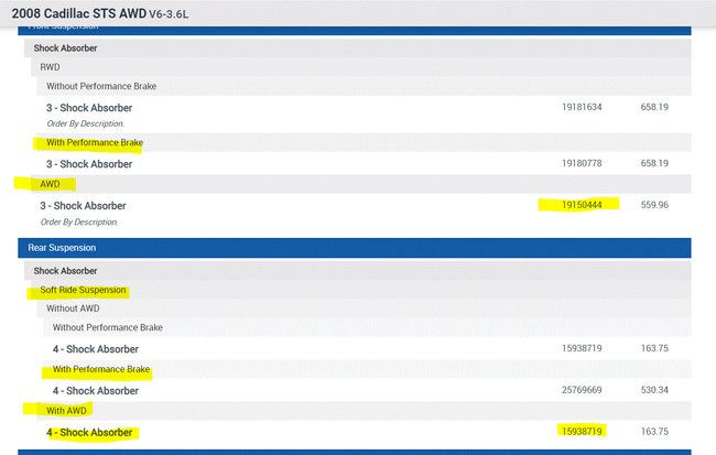

As far as the shocks, I had to determine if you have performance brakes, and you do. RPO code JE5 is the indicator (see pic 1 which is your pic I copied). And yes, it is a soft ride system.

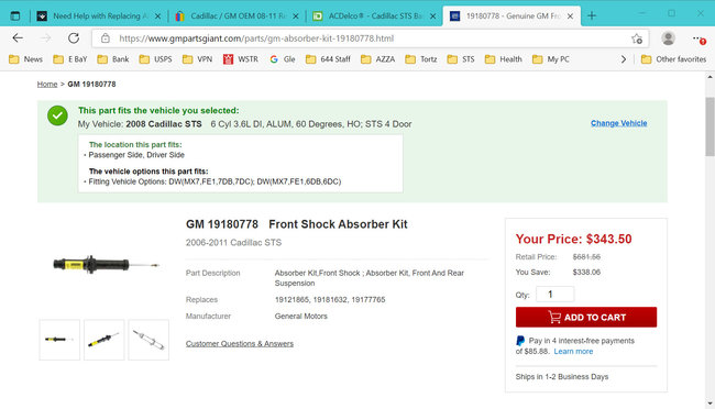

If you look below, I attached a portion from the manual and highlighted the OEM part numbers for both the front and rear shocks. (Pic 2) Interestingly, there is a big difference in price between the AWD rear shock and the 2wd rear shock. The good news is the AWD is much less expensive. LOL
Let me know if this helps and if you have other questions.

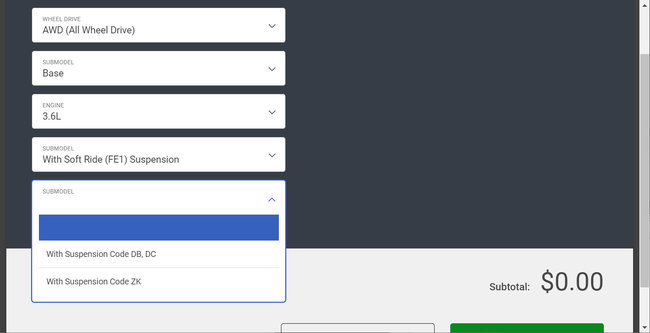

can you tell me what the Sub model with suspension code is, apparently there is two for my 2008 AWD STS.
With suspension code DB,DC.
with Suspension code ZK.
this is on Carid.com:
https://www.carid.com/2008-cadillac-sts-suspension-parts/acdelco-gm-original-equipment-shocks-and-struts-69966384.html?parentsubmodel[]=WHEEL+DRIVE|AWD+%28All+Wheel+Drive%29
Dec 7, 2021 at 9:18 AM

I looked up the Highlighted Shock number you gave, and that number is GM 19150444
it's the Wrong Shock for my car. it's a Magnetic Shock I do not have FE3 RPO code
or magnetic shock.
I have Soft Ride SUSP(FE1), SUSP(7DB), RPO Codes.
Can you check for another SHOCK for MY 2008 STS AWD 3.6?
The closest one I found is 19180778, 19121865, 19177765, GM 540-601.

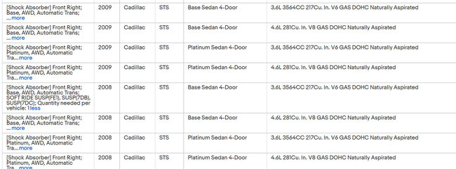

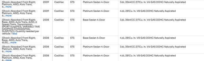

The second Pic is from Ebay and the fitment chart for the GM 540-601.
The Third pic shows the fitment for GM 19150444 Magnetic Shock.
I'm pretty sure that's the wrong one.

That is the only thing my manual is identifying. Could you provide me with the VIN number of the vehicle?

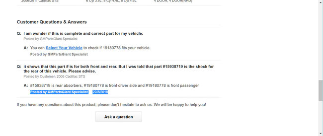

I had the strut assembly off when finding out the last shocks I purchased were not the right ones. I do not want to make that mistake again... I believe the magnetic shocks have wires too and none of my front or rear had none.
here are the correct rear shocks I purchased, GM OEM 08-11 Rear-Shock Absorbers 15938719.
Feb 7, 2022 at 11:37 AM
  • 110,194 POSTS
The ones listed above appear to be the correct ones based on the RPO. However, when I used your VIN number, it comes up with an FE3 sport suspension.
I don't feel your RPO list would be wrong. Something has to be mixed up at the GM parts giant. Have you already ordered the ones you listed?
