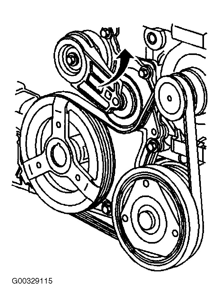

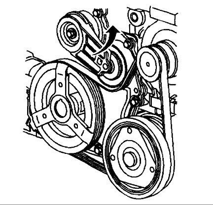

I want to know how to put a serpentine belt on

I really need to see a picture.

Raise and support the vehicle.
Remove the front fender liner.
Rotate the drive belt tensioner counter-clockwise to release the spring tension.
Remove the drive belt.
Image (Click to make bigger)

There you go.
