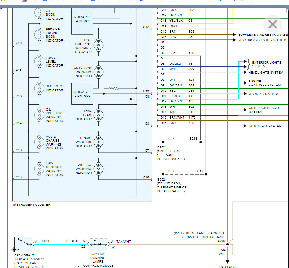

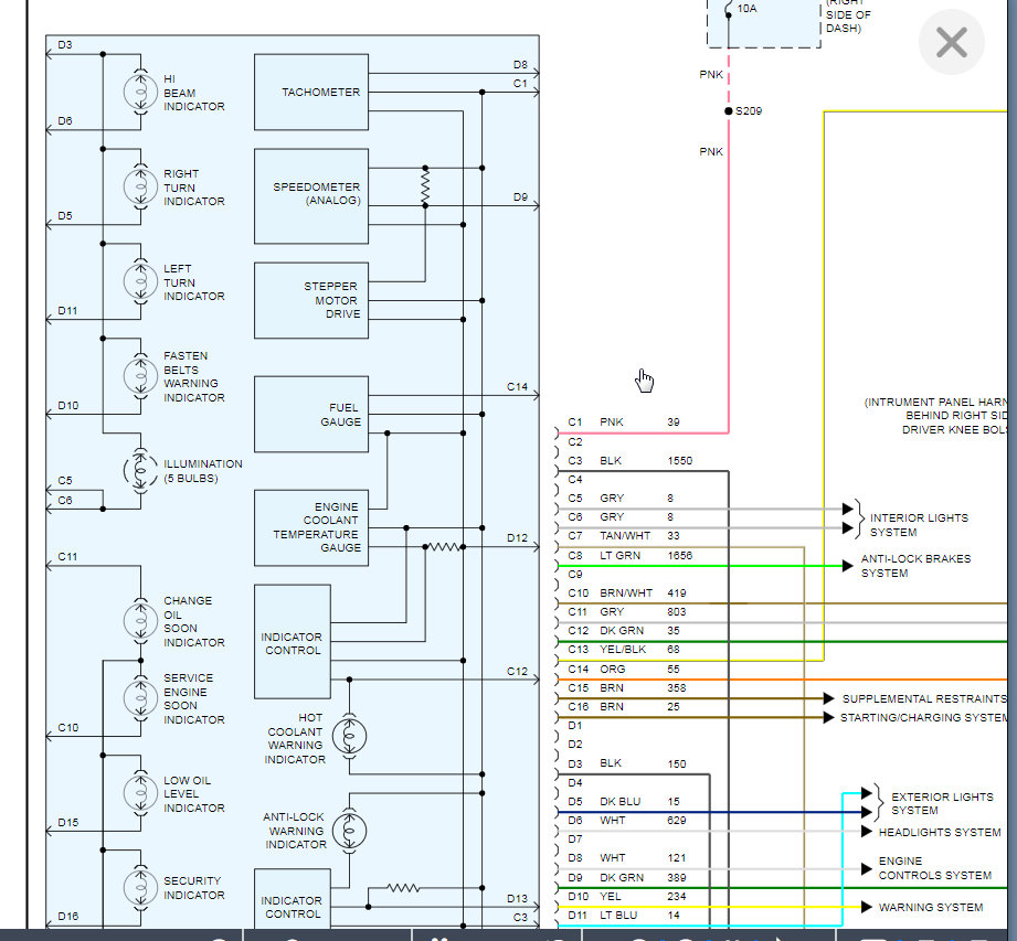

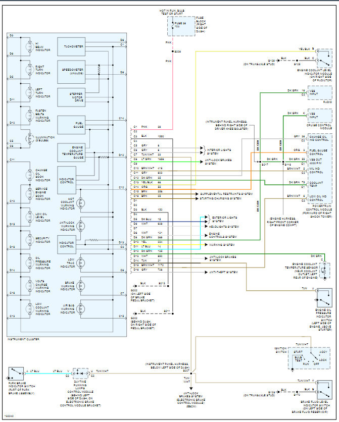

I don't have the diagram for the 2002 due to it not being offered in the USA as you stated and we only have manuals for USA vehicles. However, I attached the diagram for the 2001 as it is the same due to not making any changes.
Hopefully that helps. Let me know how you make out. Thanks
