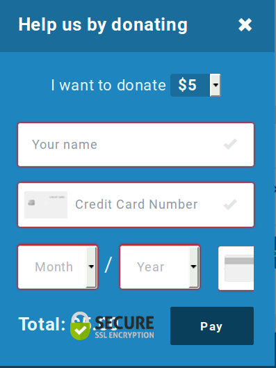

Thank You for everything... I tried to donate but the field to the right of Month will not expand so that I may enter info. See image, and show to webmaster.

Opps...I mean "Year"
Feb 21, 2017 at 7:38 PM
  • 55,399 POSTS
Thanks for the image we have our tech guy working on that now. Can you tell us what device and browser you are using?
Best, Ken
Feb 24, 2017 at 3:56 AM
SILLYBOY
  • 18 POSTS
Firefox 51.0.1
Ubuntu Mate 16.04
