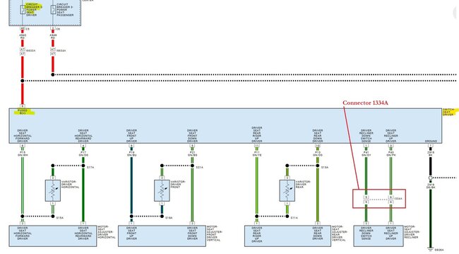

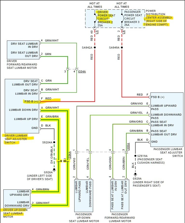

Question: My lumbar support in the driver’s seat has been inoperable since the dealership replaced it in 2020 or 2021. Could this be a potential source of the parasitic drain causing the various issues I am experiencing?
Mar 12, 2025 at 5:53 AM
AL514
  • 5,639 POSTS
They replaced the lumbar actuator with a new one and it still didn't work, and they let the vehicle go like that? Its possible, but with burnt wires I would be more concerned with fire hazards, The wiring diagrams show the driver's seat with adjustments is powered by a circuit breaker, so as soon as the current flow is low enough, such as when turning the key off, the circuit breaker is going to close again and power will be restored to those circuits. I do see a connector for the lumbar section of the seat, connector 1334A if you want to disconnect it, or unplug the entire seat switch and see if your battery draw disappears.
Here are the wiring diagrams for the driver seat, the 2nd is the OEM diagram.
This is a guide on battery draws, there is method of checking for low voltage drop across fuses (in the millivolt range (mv). This is a better method than pulling fuses, just having a meter set on DC volts, low setting and looking for any very low reading can indicate current flowing through that fuse, this requires the vehicle being prepared first though.

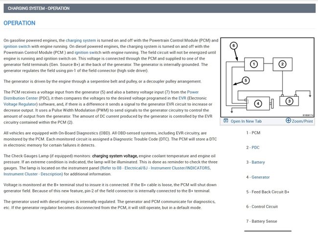

I finally got my car back up and running, and the voltage was at 14.5 volts. The mechanic reviewed all the information I provided and didn’t find any other issues except for the blown fuse block. The next day, I drove for three hours, and the voltage remained steady at 14.5 volts both going and coming back. However, the following day, when I started the car, the voltage read 13.1 volts. While driving, the voltage remained constant at 13.1 volts, even when I pressed the gas pedal. When I released the gas pedal, the voltage would go back to 14.5 volts, and it would return to 13.1 volts when I came to a full stop. And it seem like every time i start my car up my battery voltage is lower than before.

With the voltage at 14.5v, that's a pretty normal level for a newer vehicle, charging system voltages are higher now. But I would suspect there still may be an underlying issue, especially since there was a burnt wire as well. There might be a wire somewhere that's intermittently making contact with either the exhaust pipe or the body. Some shorts to ground are not always apparent, I have seen many that are not fully short to ground all the time, where the insulation on a wire is partially exposed and not making contact all the time. So, when you say the voltage is lower every time you start the vehicle, do you mean you're noticing a lower charging system voltage directly at the battery, or are you checking it at the B+ stud on the alternator?
I would see if there were a difference in voltage at the battery vs the alternator output stud, if there's a difference in voltage levels, there could be an issue with the wiring between the two. I would also check the voltage level from battery negative to the engine block and frame/body. Thats a voltage drop test on the ground side, it should read very close to 0-volts.

I would put a multimeter on it and check it at the battery + and alternator + post, to be sure it charging correctly, that looks a bit strange to me, granted these more modern charging system will vary the voltage depending on different conditions, but I don't like the way it's changing like that. It looks like when you're coming to a stop the alternator is raising the voltage level, possibly if the battery current sensor or ECM is seeing a low voltage condition somewhere, when it's not actually the case, I will go over service info on this and get back to you, can you provide the vin # so we can check this specific vehicle.

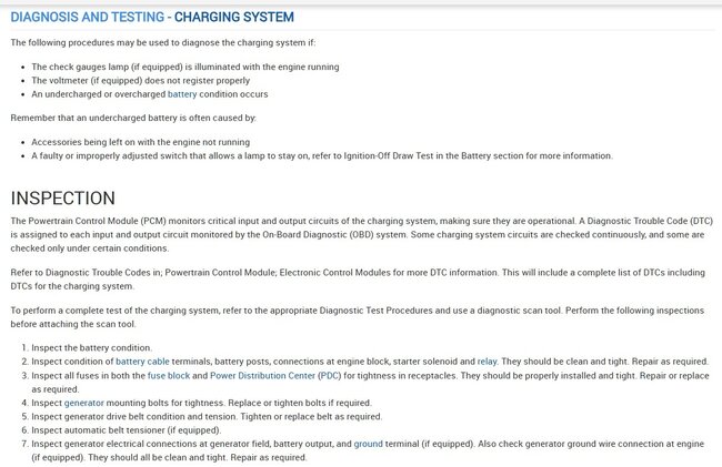

That fluctuation amount is okay, the voltage does seem to be a little bit high, I would think if you have most the electrical loads off, (ie A/C, rear defrost, blower motor, etc.) it should come down if just cruising at light throttle, to maybe around 13.7v range. Here is some service info on the charging system and operations. I would check it with a multimeter to make sure the voltmeter on the cluster is correct. I don't see any warning lights on the cluster in the video, it may have been that the ECM needed to relearn some strategies since I'm sure the mechanic had the battery disconnected at some points, which might explain the higher fluctuations you were seeing previously.
Check the battery voltage before starting the vehicle and see what the static resting voltage is at, then check it at idle and 2,500 RPMs with a multimeter on the battery. That way you can be sure the cluster reading is correct. If he replaced the entire fuse block, there may have been high resistance internally, I have seen the solder cracked and broken inside a fuse box that would make contact when it was hot then as it cooled off the solder joint would open back up causing issues.

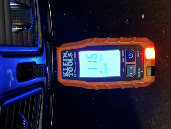

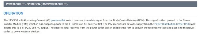

I plugged an outlet voltage tester into the 115-volt outlet, and it indicated an open ground. Is it possible that the ground issue is specific to this outlet?
Mar 27, 2025 at 10:40 PM
AL514
  • 5,639 POSTS

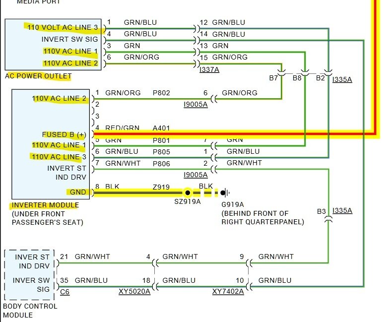

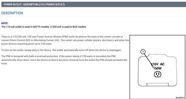

These AC voltage outlets are controlled by their own AC Inverter modules, does this still have to do with the flickering dash lights? The charging system voltage fluctuations are normal. Is that a home circuit outlet tester?

This is a wiring diagram of the AC voltage inverter in your vehicle, along with the operations. You can see the Body Control Module sends out an enable signal as well as monitors the AC voltage inverter module, so I would have the Body Control module scanned for any trouble codes, before assuming there is a fault with the inverter, The BCM will set trouble codes if it sees something wrong with the inverter. Since the AC inverter is powered by a DC voltage feed, a home outlet tester may not read or measure the same as it would a home outlet, where there is a positive, neutral and ground wire, whereas with the inverter in the vehicle is not putting out any AC voltage on the module's ground wire. Vehicles are designed to run on a DC voltage, and in fact, sometimes when an Alternator fails (such as a diode fails internally) the Alternator will start to put out AC voltage spikes which can actually damage modules in the vehicle that are designed to only run on DC voltage, in this case a 12volt DC feed.
If the AC outlet in the vehicle is not working when you plug in something that runs on AC voltage, then the module needs to be diagnosed, its power (fuse) and ground would need to be checked. But again you would almost always see a code stored in the BCM due to a fault. Are you still having the issue with the Instrument Cluster flickering ?
