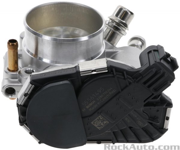

Today i thought I would clean the throttle body. The vehicle was running fine but a little slow. So, i took everything apart to remove the throttle body from the vehicle. After i remove the throttle body i thought let me replace the throttle position sensor while it's out of the vehicle.
I saw a plastic cover on the side of the throttle body. It looked like the throttle position sensor was underneath there. So, i remove the metal clips on the side to see what was underneath. As soon i remove the metal clips the cover is stuck and will not come off. It looked like it was an electronic throttle body. I did not see any throttle position sensor under the cover. So, i put the metal clips back on and clean the throttle body.
Reinstall the throttle body into the vehicle. I made sure connectors are tight and clean with no damage to wires. After i did all of that and everything is back together i start the vehicle and my check engine light is on. I got codes p0122 and p0223. I read all the info stating why the code could be on but i did not attempt to replace anything yet. I don't know what i could have done wrong.
I took apart the throttle body again and made sure everything was installed back on the throttle body correctly. The only thing i can see is that the plastic cover isn't tight like it used to be and all the metal clips are on tight. I also made sure to install the cover lining it with the metal contacts inside.
Reinstall throttle body for the second time. All codes are still on and i can't even drive the vehicle now because the pedal cannot accel.
Do you think i damaged the throttle body because i try to remove that plastic cover? This really made me lose my mind now...
Around the mileage throttle body's go bad are usually between 60k to more. I am at the mileage to replace it anyhow. But i did not think i would damage it by removing it to clean it. Little did i know the cover would not have a throttle position sensor under there.
Here is a photo of what mine exactly looks like. If i was to replace it would this fix the issue? Also, for reference here is the throttle position sensor i bought from rock auto. But i honestly think it's no use for my vehicle.

I did some research, and I might have to relearn my throttle body because I shouldn't have taken it apart to clean it and by doing that, I have confused the computer so idle will not smooth out. Is there any idea I can do a throttle body relearn without using an expensive scan tool? I do have the scanner to reset the codes. I try to reset the codes but they would not erase the throttle position sensor codes.

I removed my throttle body in my car listed above (LT model) to clean the whole throttle body assembly. I might have damaged the throttle body because I try to open the electronic plastic cover and now it will not close tight with the metal tabs on it. I know now I did something wrong because after reinstalling the throttle body I got two codes p0122 and po223. The engine idles and shakes rough, and I can hardly accel the pedal driving. I checked all my work and made sure connections were clean and tight but now the computer cannot understand the throttle body, so I am getting these two throttle position sensor codes.
Should I just replace the throttle body? I think I damaged it because with an electronic throttle body you cannot open the throttle plate and pry open the plastic cover. Someone from A GM Dealer told me I had a throttle position sensor, but I do not because it's built in.
If I do replace the throttle body, can you tell me what relearn I can do after I replace it? I would appreciate it because I was about to buy a new throttle body thinking I damage it. I looked all over google and there are relearns, but I hope I don't need an expensive scan tool to relearn the throttle body. I do have a scanner to reset the codes. I try to reset codes but that didn't do anything. I hope someone can help me. I know I shouldn't have taken it apart. The vehicle was running fine before but I wanted to clean it and now I cannot even drive it.

Joe. The connector checks out fine and the wires are fine. I was able to get a reference voltage of 5v and the other pins were around 0v to 5v with the connector connected. I also checked the pins connected at idle with wide-open throttle. All are near the value you told me they should be.
I now think I might have damaged the throttle position sensor trying to take it off and the internal parts got bent inside. I cannot remove the sensor because it's tightly placed on the throttle body assembly. So, I assume GM built the TPS with the assembly so to replace the sensor I would need a throttle body assembly. Should I just replace it since all the electrical side checks out good?
