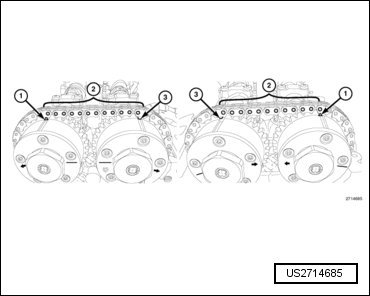

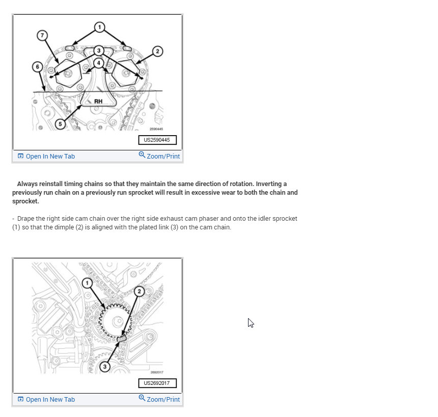

I see conflicting procedures for reinstalling timing chain on rear cylinder
2011 VOLKSWAGEN ROUTAN
88,800 MILES • 3.6L • 2WD • AUTOMATIC
JBIRDLEBOUGH
  • 8 POSTS

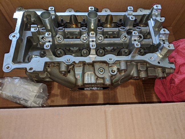

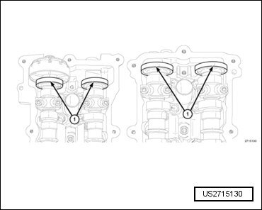

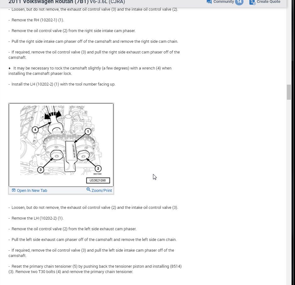

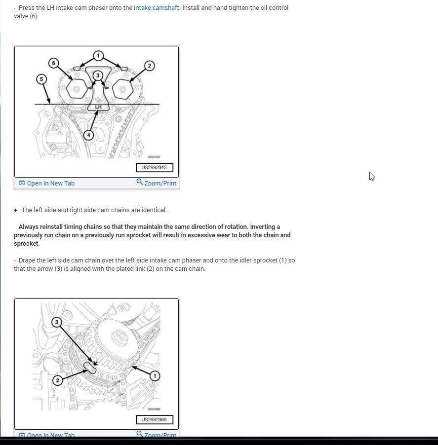

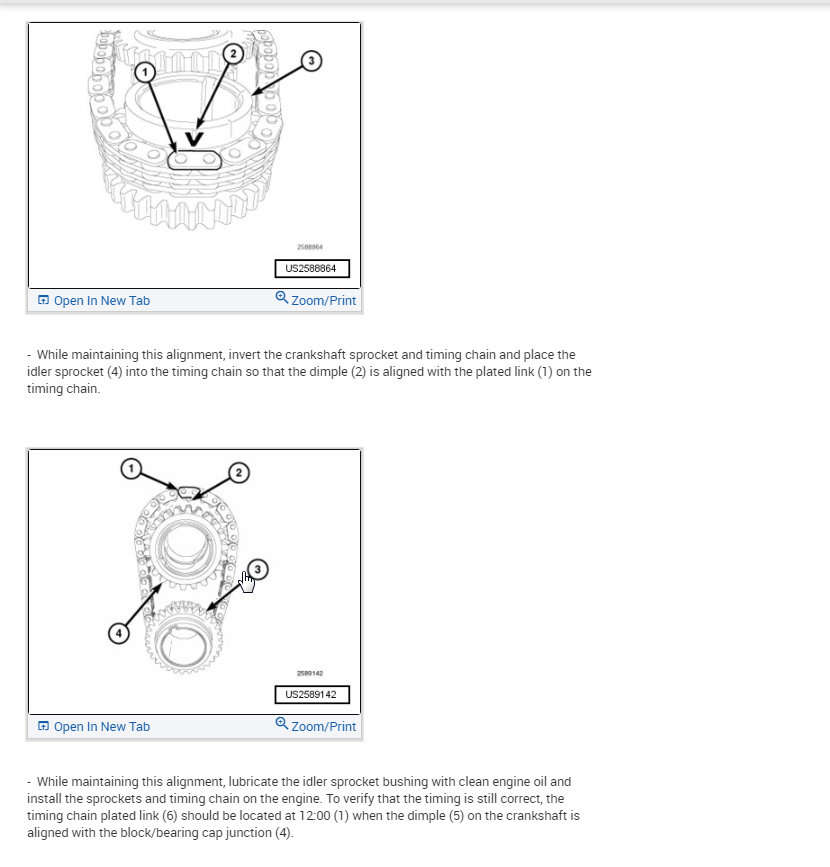

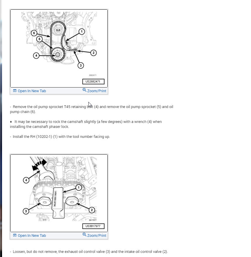

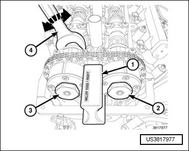

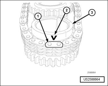

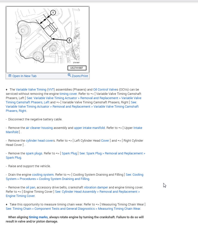

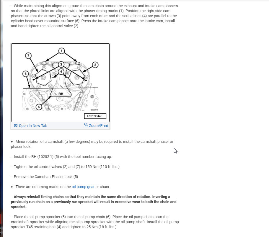

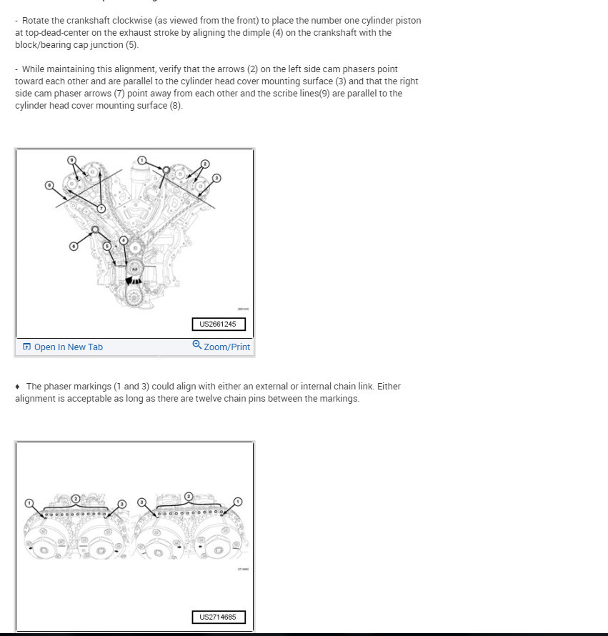

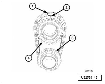

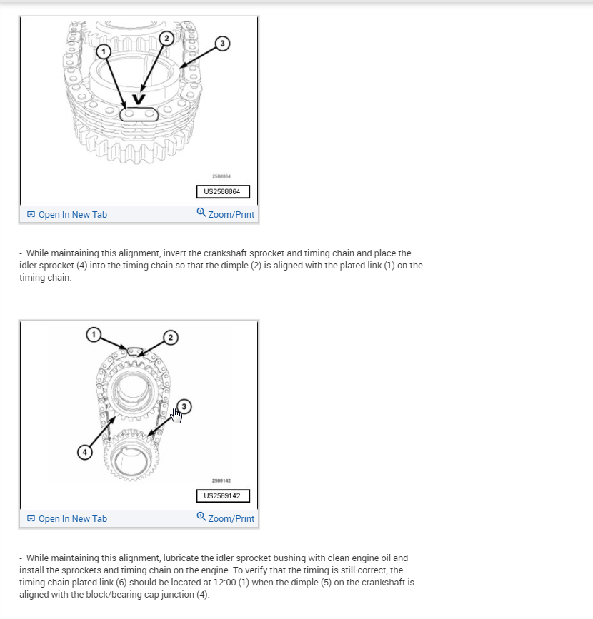

I have rear head reinstalled, cams in with holes up, i previously marked the chain at the 2 slots in the cam VVT, so know correct way it faces front and where those two marks match the VVT cam gears. Problem is there is no marking on the other end, in fact no marks on the timing chain. I have the engine crank at dot on the left side (TDC) position. There are marks on the lower drive gear shaft two arrows one for left and one for right, but no marks to reference them so were not sure if the chain is on the lower sprocket correctly. I see some videos that show black colored link (3) that 2 are for the slots and 1 matches the lower arrow. But not on this engine. One manual does not even reference lower marked link. So question if I have crank at TDC mark and I have cam gear slots matching marks on chain and cam clamp does it matter if the arrows are not lined up as long as 12 pins between, no slop in chain? Very confusing for the SW guy trying to fix his wife's van. Second question is, if chain needs to be marked on the lower link how many pins from the other links so I have accurate reference point to work from? Appreciate the help.
Feb 18, 2020 at 6:40 AM
  • 110,240 POSTS
The timing chain should be plated to identify specific links. Is this a new chain? Let me know that. However, here are the directions I have for alignment and removal and replacement. The attached pics correlate with the directions.

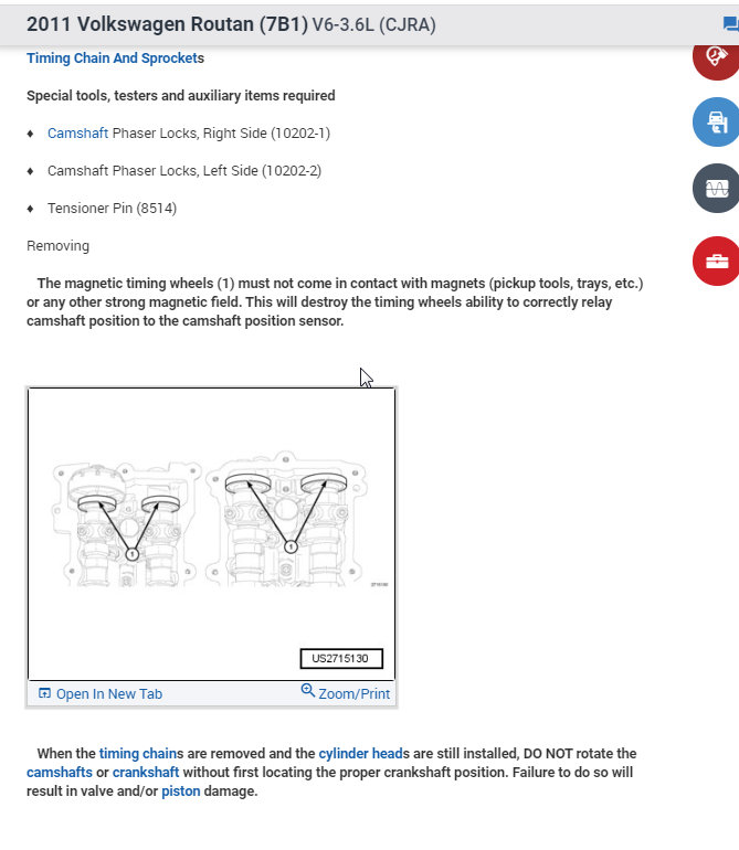

Special tools, testers and auxiliary items required
Camshaft Phaser Locks, Right Side (10202-1)
Camshaft Phaser Locks, Left Side (10202-2)
Tensioner Pin (8514)
Removing
The magnetic timing wheels (1) must not come in contact with magnets (pickup tools, trays, etc.) or any other strong magnetic field. This will destroy the timing wheels ability to correctly relay camshaft position to the camshaft position sensor.
pic 1
When the timing chains are removed and the cylinder heads are still installed, DO NOT rotate the camshafts or crankshaft without first locating the proper crankshaft position. Failure to do so will result in valve and/or piston damage.

The Variable Valve Timing (VVT) assemblies (Phasers) and Oil Control Valves (OCVs) can be serviced without removing the engine timing cover. Refer to => [ Variable Valve Timing Camshaft Phasers, Left ] See: Variable Valve Timing Actuator > Removal and Replacement > Variable Valve Timing Camshaft Phasers, Left and => [ Variable Valve Timing Camshaft Phasers, Right ] See: Variable Valve Timing Actuator > Removal and Replacement > Variable Valve Timing Camshaft Phasers, Right.
- Disconnect the negative battery cable.
- Remove the air cleaner housing assembly and upper intake manifold. Refer to => [ Upper Intake Manifold ] .
- Remove the cylinder head covers. Refer to => [ Left Cylinder Head Cover ] and => [ Right Cylinder Head Cover ] .
- Remove the spark plugs. Refer to => [ Spark Plug ] See: Spark Plug > Removal and Replacement > Spark Plug.
- Raise and support the vehicle.
- Drain the engine cooling system. Refer to => [ Cooling System Draining and Filling ] See: Cooling System > Procedures > Cooling System Draining and Filling.
- Remove the oil pan, accessory drive belts, crankshaft vibration damper and engine timing cover. Refer to => [ Engine Timing Cover ] See: Cylinder Head Assembly > Removal and Replacement > Engine Timing Cover.
Take this opportunity to measure timing chain wear. Refer to => [ Measuring Timing Chain Wear ] See: Timing Chain > Component Tests and General Diagnostics > Measuring Timing Chain Wear.
When aligning timing marks, always rotate engine by turning the crankshaft. Failure to do so will result in valve and/or piston damage.

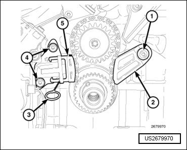

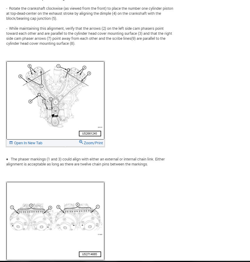

- Rotate the crankshaft clockwise (as viewed from the front) to place the number one cylinder piston at top-dead-center on the exhaust stroke by aligning the dimple (4) on the crankshaft with the block/bearing cap junction (5).
- While maintaining this alignment, verify that the arrows (2) on the left side cam phasers point toward each other and are parallel to the cylinder head cover mounting surface (3) and that the right side cam phaser arrows (7) point away from each other and the scribe lines(9) are parallel to the cylinder head cover mounting surface.
Pic 3

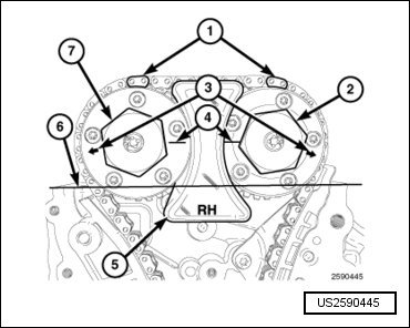

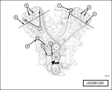

The phaser markings (1 and 3) could align with either an external or internal chain link. Either alignment is acceptable as long as there are twelve chain pins between the markings.

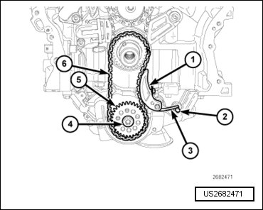

pic 4

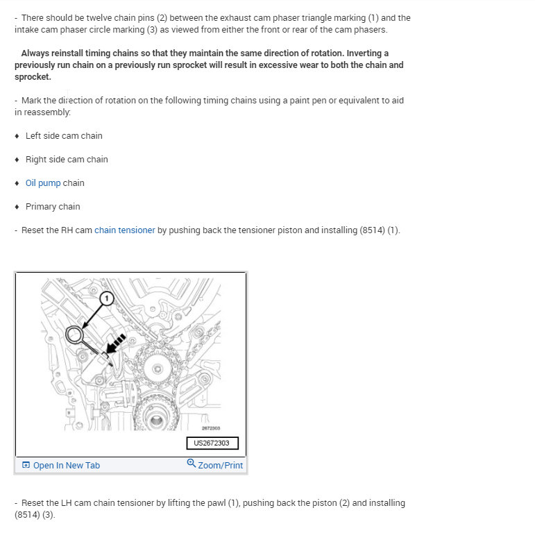

- There should be twelve chain pins (2) between the exhaust cam phaser triangle marking (1) and the intake cam phaser circle marking (3) as viewed from either the front or rear of the cam phasers.
Always reinstall timing chains so that they maintain the same direction of rotation. Inverting a previously run chain on a previously run sprocket will result in excessive wear to both the chain and sprocket.
- Mark the direction of rotation on the following timing chains using a paint pen or equivalent to aid in reassembly:
Left side cam chain
Right side cam chain
Oil pump chain
Primary chain

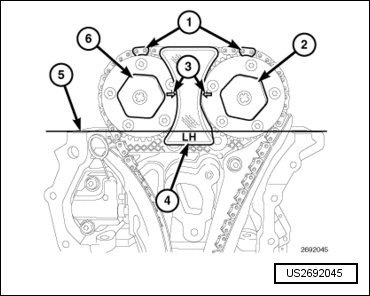

- Reset the RH cam chain tensioner by pushing back the tensioner piston and installing (8514) (1).

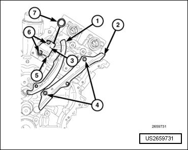

- Reset the LH cam chain tensioner by lifting the pawl (1), pushing back the piston (2) and installing (8514) (3).

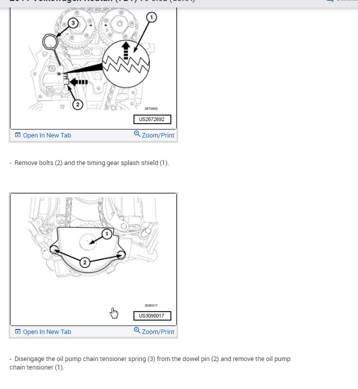

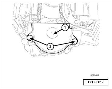

- Remove bolts (2) and the timing gear splash shield (1).
pic 7

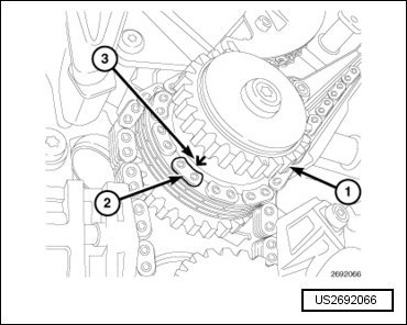

- Disengage the oil pump chain tensioner spring (3) from the dowel pin (2) and remove the oil pump chain tensioner (1).
pic 8
- Remove the oil pump sprocket T45 retaining bolt (4) and remove the oil pump sprocket (5) and oil pump chain (6).
It may be necessary to rock the camshaft slightly (a few degrees) with a wrench (4) when installing the camshaft phaser lock.
- Install the RH (10202-1) (1) with the tool number facing up.
pic 9
- Loosen, but do not remove, the exhaust oil control valve (3) and the intake oil control valve (2).
- Remove the RH (10202-1) (1).
- Install the LH (10202-2) (1) with the tool number facing up.
pic 10
- Loosen, but do not remove, the exhaust oil control valve (2) and the intake oil control valve (3).
- Remove the LH (10202-2) (1).
- Remove the oil control valve (2) from the left side exhaust cam phaser.
- Pull the left side exhaust cam phaser off of the camshaft and remove the left side cam chain.
- If required, remove the oil control valve (3) and pull the left side intake cam phaser off of the camshaft.

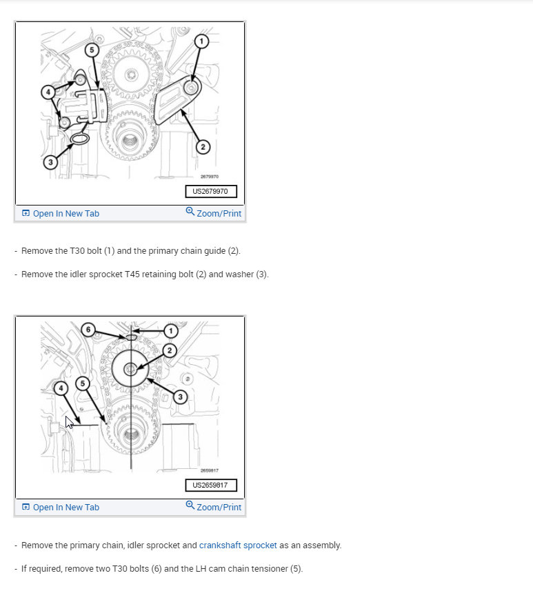

- Remove the T30 bolt (1) and the primary chain guide (2).
- Remove the idler sprocket T45 retaining bolt (2) and washer (3).
pic 12
- Remove the primary chain, idler sprocket and crankshaft sprocket as an assembly.

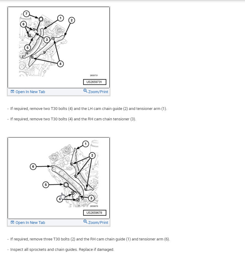

- If required, remove two T30 bolts (6) and the LH cam chain tensioner (5).
pic 13

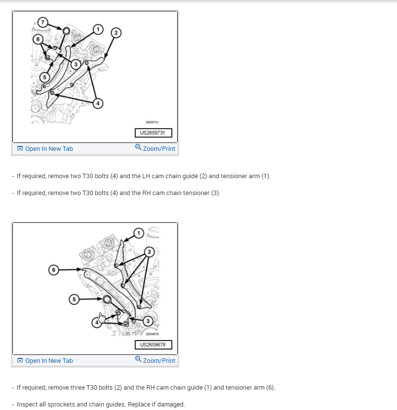

- If required, remove two T30 bolts (4) and the LH cam chain guide (2) and tensioner arm (1).
- If required, remove two T30 bolts (4) and the RH cam chain tensioner (3).
pic 14
- If required, remove three T30 bolts (2) and the RH cam chain guide (1) and tensioner arm (6).
- Inspect all sprockets and chain guides. Replace if damaged.

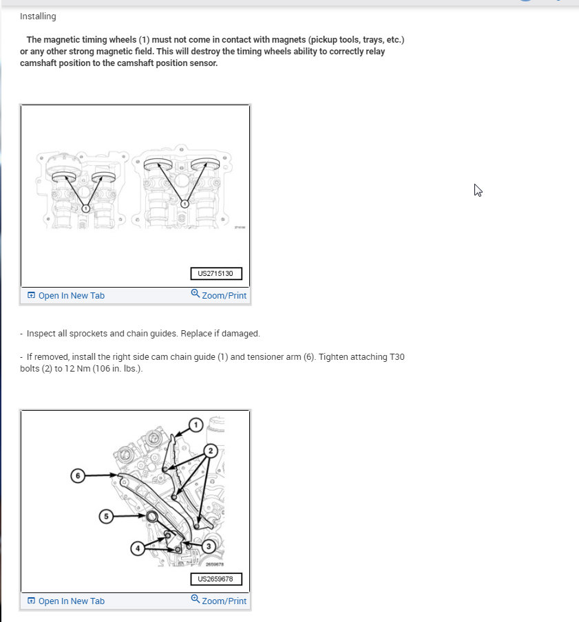

Installing
pic 15
- If removed, install the right side cam chain guide (1) and tensioner arm (6). Tighten attaching T30 bolts (2) to 12 Nm (106 in. lbs.).
pic 16

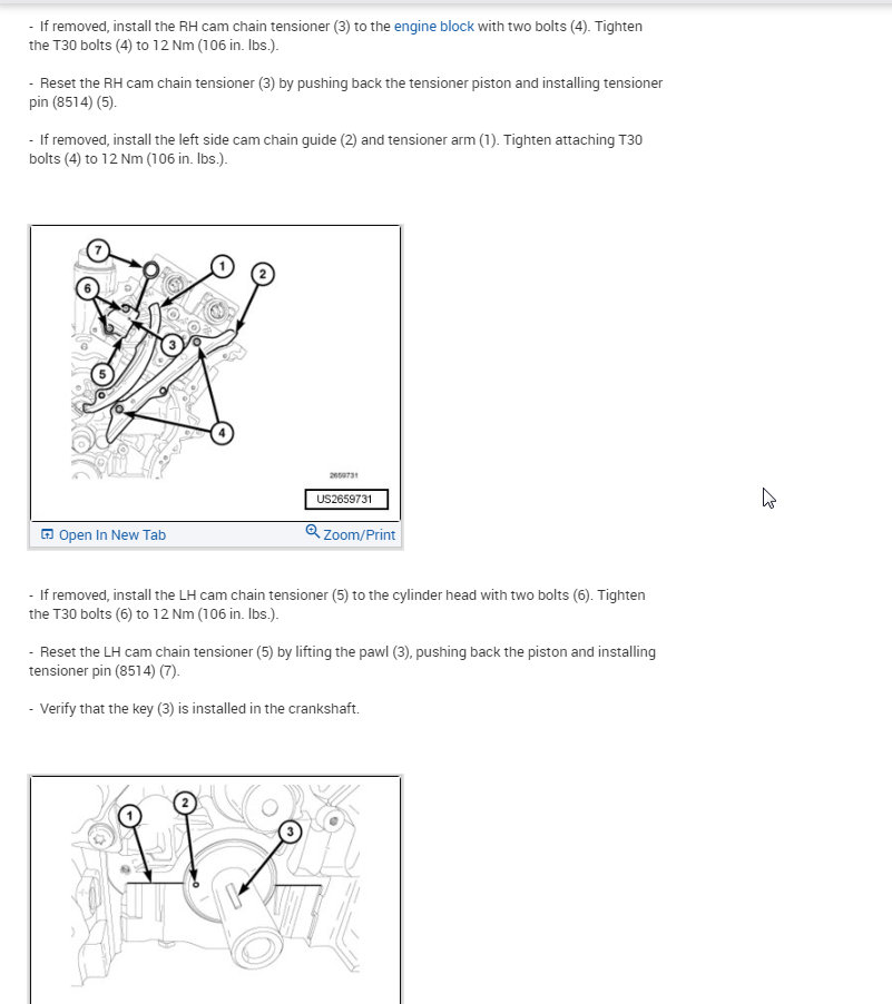

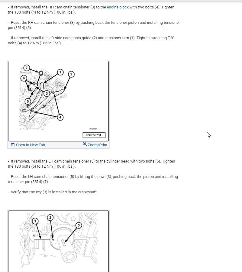

- If removed, install the RH cam chain tensioner (3) to the engine block with two bolts (4). Tighten the T30 bolts (4) to 12 Nm (106 in. lbs.).
- Reset the RH cam chain tensioner (3) by pushing back the tensioner piston and installing tensioner pin (8514) (5).
- If removed, install the left side cam chain guide (2) and tensioner arm (1). Tighten attaching T30 bolts (4) to 12 Nm (106 in. lbs.).
pic 17
- If removed, install the LH cam chain tensioner (5) to the cylinder head with two bolts (6). Tighten the T30 bolts (6) to 12 Nm (106 in. lbs.).

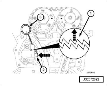

- Reset the LH cam chain tensioner (5) by lifting the pawl (3), pushing back the piston and installing tensioner pin (8514) (7).

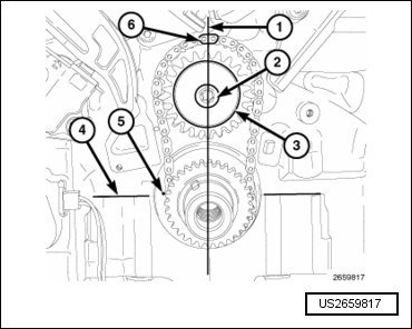

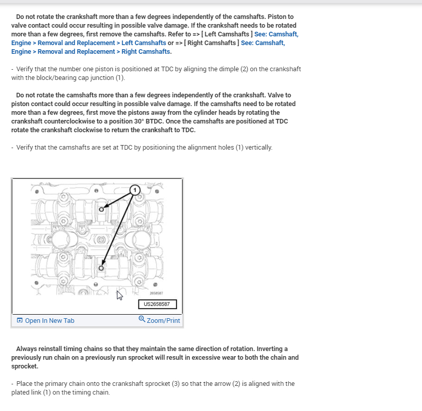

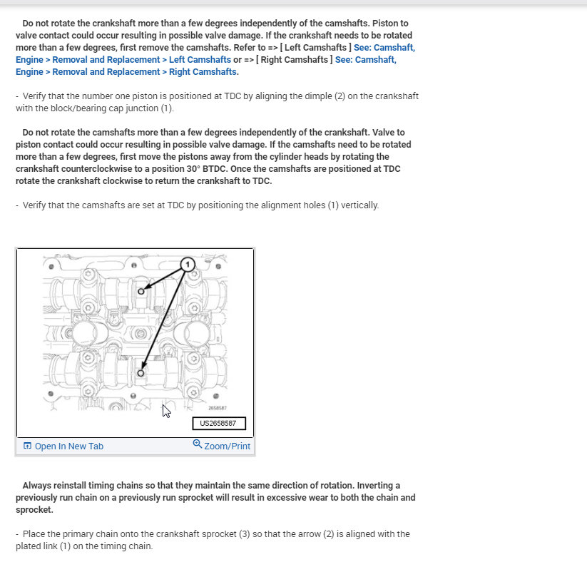

- Verify that the key (3) is installed in the crankshaft.
pic 18
Do not rotate the crankshaft more than a few degrees independently of the camshafts. Piston to valve contact could occur resulting in possible valve damage. If the crankshaft needs to be rotated more than a few degrees, first remove the camshafts. Refer to => [ Left Camshafts ] See: Camshaft, Engine > Removal and Replacement > Left Camshafts or => [ Right Camshafts ] See: Camshaft, Engine > Removal and Replacement > Right Camshafts.

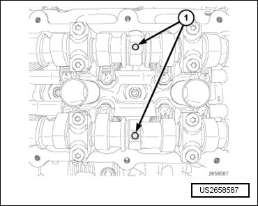

- Verify that the number one piston is positioned at TDC by aligning the dimple (2) on the crankshaft with the block/bearing cap junction (1).
Do not rotate the camshafts more than a few degrees independently of the crankshaft. Valve to piston contact could occur resulting in possible valve damage. If the camshafts need to be rotated more than a few degrees, first move the pistons away from the cylinder heads by rotating the crankshaft counterclockwise to a position 30° BTDC. Once the camshafts are positioned at TDC rotate the crankshaft clockwise to return the crankshaft to TDC.
- Verify that the camshafts are set at TDC by positioning the alignment holes (1) vertically.
pic 19

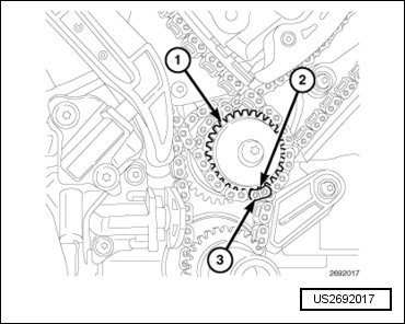

- Place the primary chain onto the crankshaft sprocket (3) so that the arrow (2) is aligned with the plated link (1) on the timing chain.
pic 20
- While maintaining this alignment, invert the crankshaft sprocket and timing chain and place the idler sprocket (4) into the timing chain so that the dimple (2) is aligned with the plated link (1) on the timing chain.
pic 21
- While maintaining this alignment, lubricate the idler sprocket bushing with clean engine oil and install the sprockets and timing chain on the engine. To verify that the timing is still correct, the timing chain plated link (6) should be located at 12:00 (1) when the dimple (5) on the crankshaft is aligned with the block/bearing cap junction (4).
pic 22

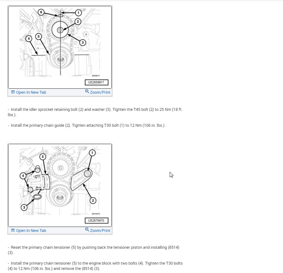

- Install the idler sprocket retaining bolt (2) and washer (3). Tighten the T45 bolt (2) to 25 Nm (18 ft. lbs.).
- Install the primary chain guide (2). Tighten attaching T30 bolt (1) to 12 Nm (106 in. lbs.).
pic 23
- Reset the primary chain tensioner (5) by pushing back the tensioner piston and installing (8514) (3).
- Install the primary chain tensioner (5) to the engine block with two bolts (4). Tighten the T30 bolts (4) to 12 Nm (106 in. lbs.) and remove the (8514) (3).
- Press the LH intake cam phaser onto the intake camshaft. Install and hand tighten the oil control valve (6).
pic 24
The left side and right side cam chains are identical.

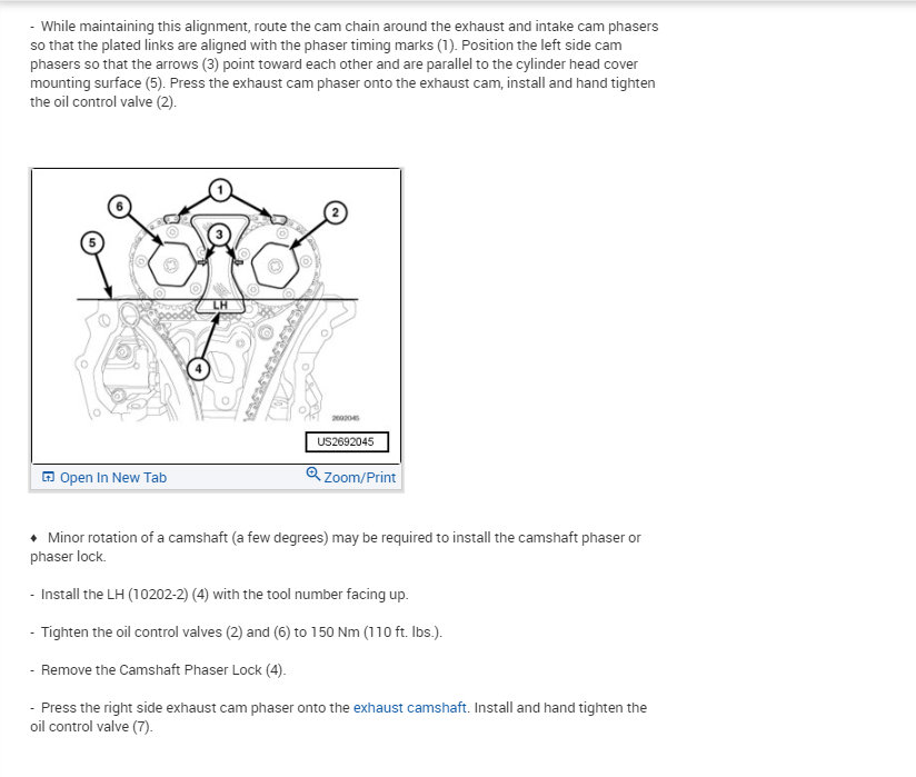

- Drape the left side cam chain over the left side intake cam phaser and onto the idler sprocket (1) so that the arrow (3) is aligned with the plated link (2) on the cam chain.
pic 25
- While maintaining this alignment, route the cam chain around the exhaust and intake cam phasers so that the plated links are aligned with the phaser timing marks (1). Position the left side cam phasers so that the arrows (3) point toward each other and are parallel to the cylinder head cover mounting surface (5). Press the exhaust cam phaser onto the exhaust cam, install and hand tighten the oil control valve (2).
pic 26

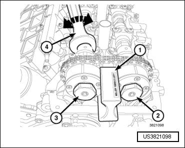

Minor rotation of a camshaft (a few degrees) may be required to install the camshaft phaser or phaser lock.
- Install the LH (10202-2) (4) with the tool number facing up.
- Tighten the oil control valves (2) and (6) to 150 Nm (110 ft. lbs.).
- Remove the Camshaft Phaser Lock (4).
- Press the right side exhaust cam phaser onto the exhaust camshaft. Install and hand tighten the oil control valve (7).

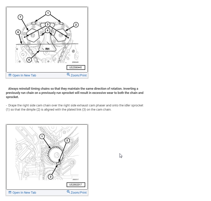

- Drape the right side cam chain over the right side exhaust cam phaser and onto the idler sprocket (1) so that the dimple (2) is aligned with the plated link (3) on the cam chain.
pic 28
- While maintaining this alignment, route the cam chain around the exhaust and intake cam phasers so that the plated links are aligned with the phaser timing marks (1). Position the right side cam phasers so that the arrows (3) point away from each other and the scribe lines (4) are parallel to the cylinder head cover mounting surface (6). Press the intake cam phaser onto the intake cam, install and hand tighten the oil control valve (2).
pic 29
- Install the RH (10202-1) (5) with the tool number facing up.
- Tighten the oil control valves (2) and (7) to 150 Nm (110 ft. lbs.).
- Remove the Camshaft Phaser Lock (5).

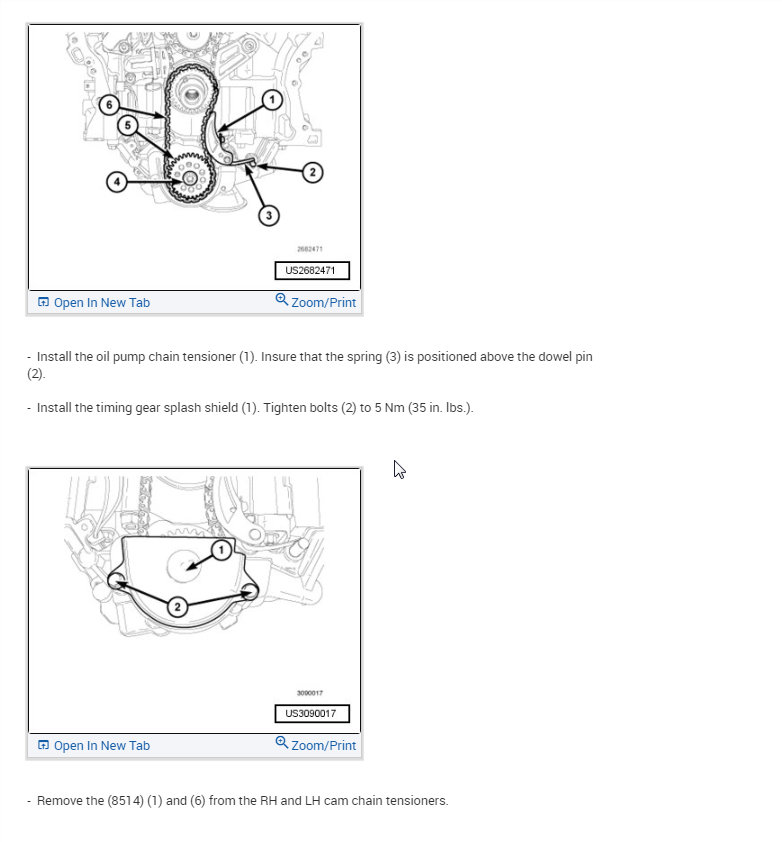

- Install the oil pump chain tensioner (1). Insure that the spring (3) is positioned above the dowel pin (2).
- Install the timing gear splash shield (1). Tighten bolts (2) to 5 Nm (35 in. lbs.).
pic 31
- Remove the (8514) (1) and (6) from the RH and LH cam chain tensioners.

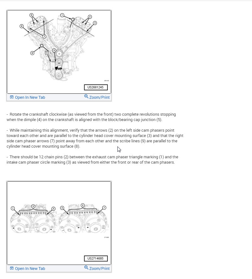

- Rotate the crankshaft clockwise (as viewed from the front) two complete revolutions stopping when the dimple (4) on the crankshaft is aligned with the block/bearing cap junction (5).
- While maintaining this alignment, verify that the arrows (2) on the left side cam phasers point toward each other and are parallel to the cylinder head cover mounting surface (3) and that the right side cam phaser arrows (7) point away from each other and the scribe lines (9) are parallel to the cylinder head cover mounting surface (8).
- There should be 12 chain pins (2) between the exhaust cam phaser triangle marking (1) and the intake cam phaser circle marking (3) as viewed from either the front or rear of the cam phasers.
pic 33

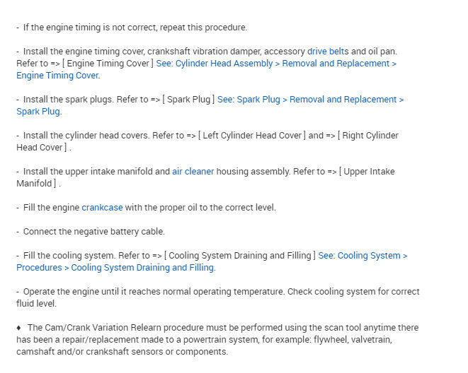

- If the engine timing is not correct, repeat this procedure.
- Install the engine timing cover, crankshaft vibration damper, accessory drive belts and oil pan. Refer to => [ Engine Timing Cover ] See: Cylinder Head Assembly > Removal and Replacement > Engine Timing Cover.
- Install the spark plugs. Refer to => [ Spark Plug ] See: Spark Plug > Removal and Replacement > Spark Plug.
- Install the cylinder head covers. Refer to => [ Left Cylinder Head Cover ] and => [ Right Cylinder Head Cover ] .
- Install the upper intake manifold and air cleaner housing assembly. Refer to => [ Upper Intake Manifold ] .
- Fill the engine crankcase with the proper oil to the correct level.
- Connect the negative battery cable.
- Fill the cooling system. Refer to => [ Cooling System Draining and Filling ] See: Cooling System > Procedures > Cooling System Draining and Filling.
- Operate the engine until it reaches normal operating temperature. Check cooling system for correct fluid level.
The Cam/Crank Variation Relearn procedure must be performed using the scan tool anytime there has been a repair/replacement made to a powertrain system, for example: flywheel, valvetrain, camshaft and/or crankshaft sensors or components.

Let me know if this helps answer any of your questions.
Feb 18, 2020 at 9:10 AM

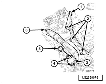

This is actually a Chrysler van just re-badged as a VW. So here is the process needed to install the timing chains on this one.
It is a lengthy process so let me know if there are questions. Thanks
Feb 18, 2020 at 9:21 AM
JBIRDLEBOUGH
  • 8 POSTS

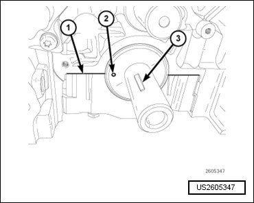

Thanks Joe, the original timing chain has no markings. Phasor has slot, and 12 pins between slots. Engine at crank is at TDC. other documentation suggested that there are arrows on the cam gear shaft which I found, and described that there are three plated links one that matches where the arrows are. On my chain no marks. So I set crank to TDC, left hand phasors with slots up to marks on caps and arrows pointing at each other, right hand same thing phasors slot up to marks on caps, arrows pointer away, lines parallel to block. So I am consistent with your process I think. Key take away is crank TDC, slots up, arrows and lines as described. Sound like I can install the timing cover. The other questions are do you apply sealant on the timing cover or block? can you install the balancer seal on the timing cover before installing the cover or must you install timing cover then install seal for balancer. One other odd question is what is the bolt hole on the exhaust output, I know there are 2 bolts for cross over pipes, 4 for catalytic converter, 2 for power steering pump mount, but can't figure out what that hole is it's tapped, but was it used for wiring harness tree or something else. It's next to the hex plug on top of right hand head. Between cylinder 1 and 3.
Feb 18, 2020 at 9:47 AM
  • 110,240 POSTS

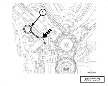

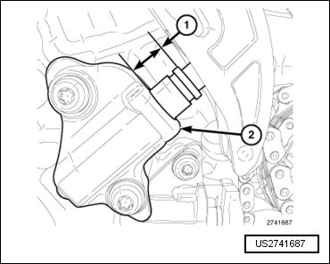

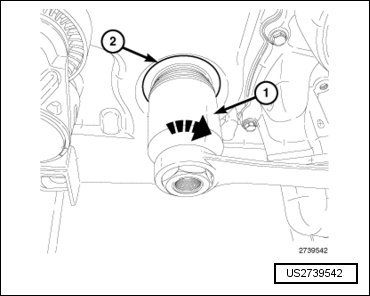

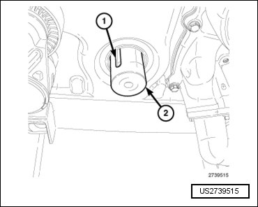

I copied your picture and circled a point on it. Is that what you are referring to?
As far as the timing, it sounds like you have it correct. However, before you put the cover on it, turn the engine by hand several revolutions to confirm nothing is making contact internally. If it stops and you can't turn it any further, do not force it.

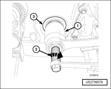

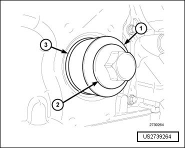

As far as the crank seal, if you follow standard procedure, it will be installed after the cover is on. The install tool uses the crankshaft threads to seat it.
Here are the directions for the seal. The attached pictures correlate with the directions

Front Crankshaft Oil Seal
Vehicle Engine, Cooling and Exhaust Engine Seals and Gaskets Front Crankshaft Seal Service and Repair Removal and Replacement Front Crankshaft Oil Seal
FRONT CRANKSHAFT OIL SEAL
Seal Remover (8511)
Front Crankshaft Seal Installer (10199)
Removing
- Remove the accessory drive belt and the crankshaft vibration damper. Refer to => [ Vibration Damper ] .
- Install the sleeve (2) from seal remover (8511) around the flywheel key (1) and onto the nose of the crankshaft.
pic 1
- Screw seal remover (8511) (1) into the front crankshaft oil seal (2).
pic 2
- Install the extractor screw (2) into the seal remover (8511) (1). Hold the seal remover stationary and tighten the extractor screw against the sleeve until the front crankshaft oil seal (3) is removed from the engine timing cover.
pic 3
Installing
pic 4
- Position the front crankshaft oil seal (3) into place on the engine timing cover.
- Align the front crankshaft seal installer (10199) (1) to the flywheel key on the crankshaft and against the front crankshaft oil seal (3).
Only tighten the crankshaft vibration damper bolt until the oil seal is seated in the cover. Overtightening of the bolt can crack the front timing cover.
- Install and tighten the crankshaft vibration damper bolt (2) until the crankshaft oil seal is seated in the engine timing cover.
- Install the crankshaft vibration damper and accessory drive belt. Refer to => [ Vibration Damper ] .
Note: Make sure to lubricate the new seal with oil before installing the balancer.
As far as sealant, if you have no gasket, yes, use a good RTV sealant and put about a 1/8" bead around the cover before installing. Also, make sure to follow the directions on the product you select. And always make sure the surfaces are clean and dry. Make sure not to cut into the surface.
Feb 18, 2020 at 12:01 PM
