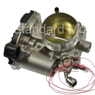

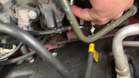

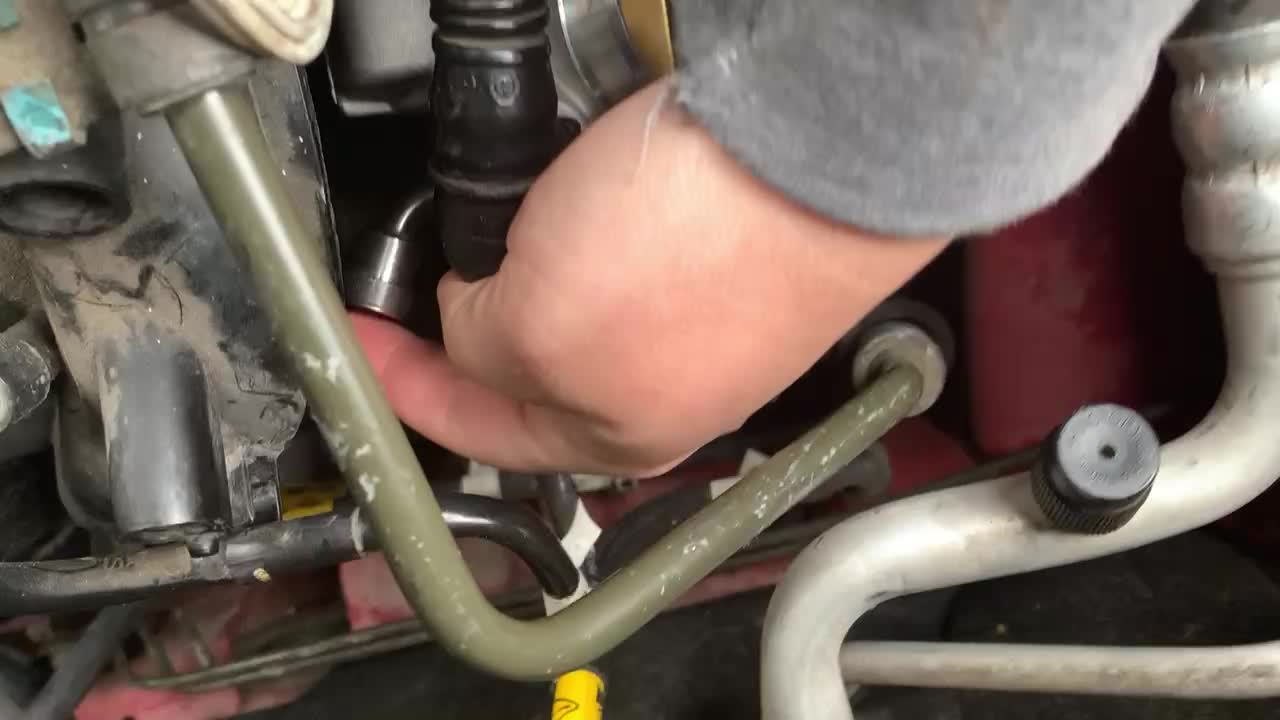

The hose goes from the throttle body to the water reservoir and i don't know what it's called to look up the part. The connector on the end of the hose broke off now i'm guessing i need to replace the whole hose because it loose torn as well. Please help!

The video did not show much as you moved the phone around and we could not see anything.

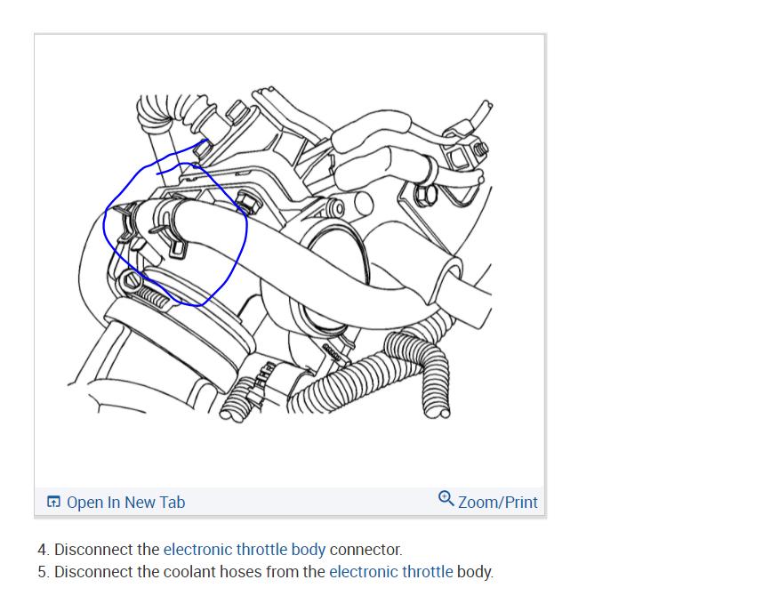

I attached a picture of the throttle body. Is the hose I circled the hose you need? It is called a throttle body coolant hose from the throttle body to the surge tank.

Thanks for your quick response. No actually the hose is attached from the part of the throttle body i circled to the water reservoir.

Okay, great. That is still the same hose since you have 2 at the throttle body.
This is not a hose a parts store will have. You will need to go to a Chevrolet dealership parts department for the hose.
