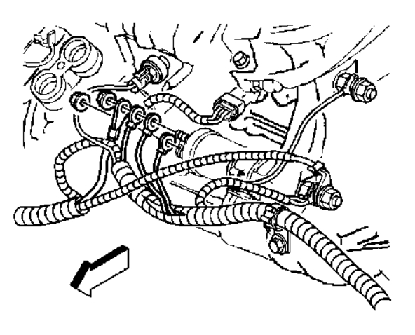

Starter wiring diagram needed?
2008 SATURN AURA
190,000 MILES • 3.5L • V6 • 2WD • AUTOMATIC
KBSCHOFIELD7
  • 6 POSTS
I just need help figuring out which bolt the red wire goes to on the starter and which one the green one goes to on starter.
Sep 14, 2025 at 8:20 AM
  • 55,433 POSTS
So all wires go to the large lug and the purple wire goes to the small lug. This images show the wiring. Check out the images (below). Let us know if you need anything else.
