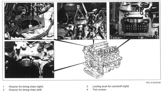

Hi.i have the car listed above with a code p0015. no one knows what I’m talking about. I can’t find any videos so I want to help people like me with this problem. Code is camshaft adjuster magnet but is not located in the front of the cams.
I replaced, camshaft position sensor crank shaft position sensor mass airflow sensor,spark plugs,air filters,starter,value covers,oil change,but after all that. Hard start. Not consistent and sometimes cuts off while driving.what do I need? I love my car. Please help and the virus is not helping.

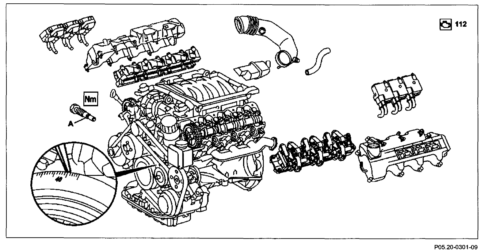

The P0015 is the OBD-II generic code indicating the engine control module (ECM) has determined that the exhaust camshaft timing for bank 1 is more retarded than what the ECM has commanded it to be. The over-retarded timing condition can be during the advancing or retarding phase. This is caused by a bad camshaft actuator which is common here is how you can change it out. Also the stalling can be caused by a dirty throttle bore. here is a guide on how to fix that as well:
Camshaft and timing chain replacement instructions.
Remove

2 Remove spark plugs
NOTE: To ensure that the engine can be easily cranked when drawing in the timing chain, and to avoid the timing chain jumping across. Remove only once spark plug of each cylinder.
3 Remove cylinder head covers
- Air cleaner mounted on vehicle
- Air cleaner positioned at engine side
4.1 Remove fan shroud
NOTE: Not Model 211.061/065/070, 230.475
4.2 Remove electric fan
5 Position engine to 40 degrees after TDC of first cylinder.

6 Remove chain tensioner
7 Remove camshaft position sensor
8 Crank engine in direction of rotation until the link for separating the timing chain is easily accessible
NOTE: Timing chain is separated one chain link next to the copper plate (on right). See new timing chain.
9 Remove camshaft bearing bridge on right
10 Install holding bush (3) onto camshaft on right
NOTE: Screw in bolts (4) only until they touch.
11 Attach retaining devices (1, 2) for timing chain to right and left cylinder head
12 Separate timing chain
CAUTION: Cover over timing case recess with a clean cloth. Parts which have dropped into the timing case recess, must be removed.
NOTE: To pull out the old timing chain, connect the old chain to the new timing chain.
