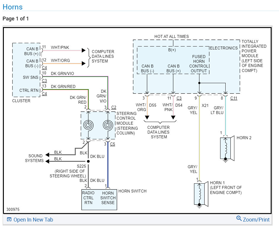

The horn and the buttons on the steering wheel stopped working, can I get the wiring diagrams?
2009 DODGE CALIBER
150,000 MILES • 2.0L • 4 CYL • 2WD • AUTOMATIC
W002MIA
I would like to fix them but i don't have any diagrams. if anyone can help, i would really appreciate it.
thank you
Sep 13, 2023 at 2:08 AM
  • 55,423 POSTS

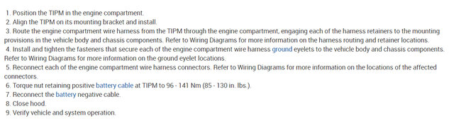

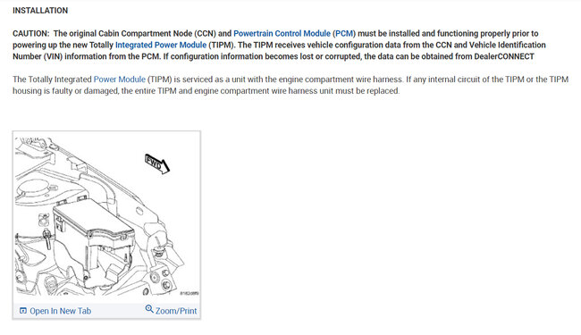

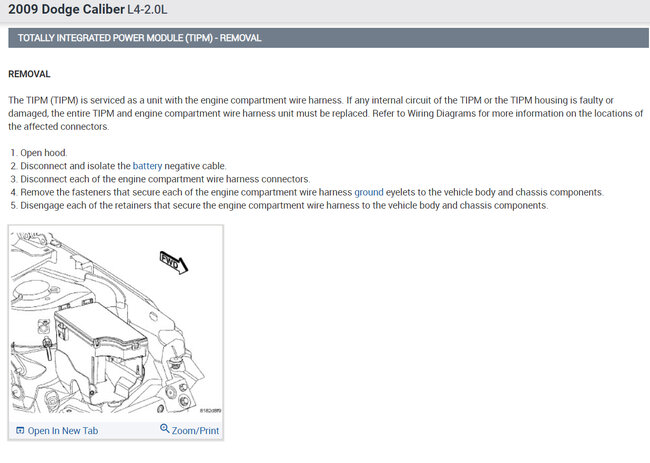

Sure, I have seen the TIPM go out and cause this problem FYI. Here are the horn wiring diagrams and I have included how to change out the TIPM in case you need it, it is easy to replace because it-self learns. Check out the images (below). Please let us know what you find.
