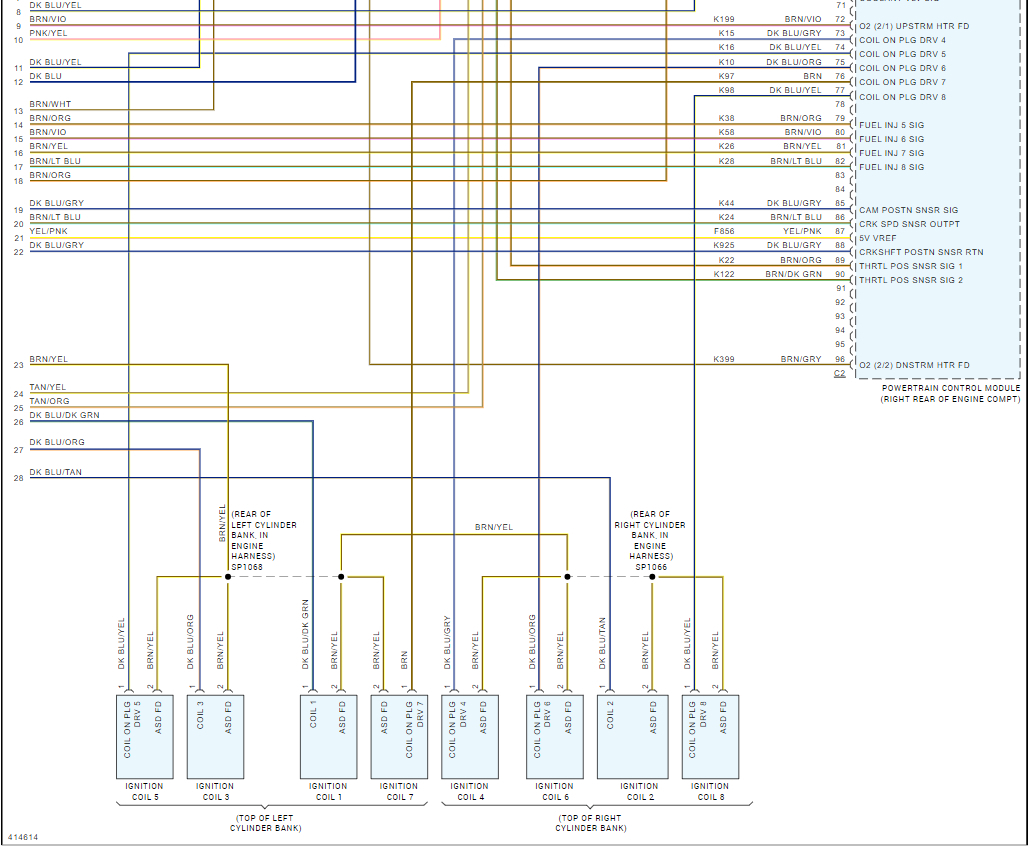

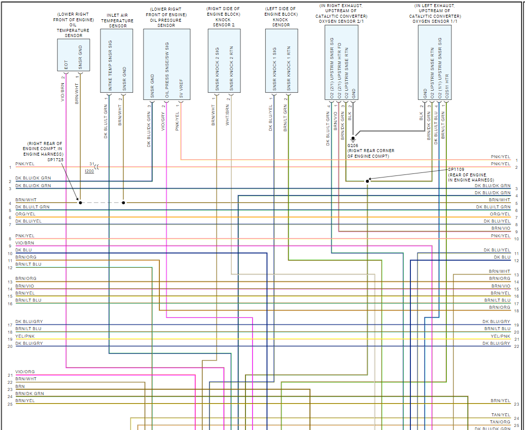

I need a wiring diagram for coils?
2013 DODGE RAM
120,000 MILES • 5.7L • V8 • 2WD • AUTOMATIC
ABIDZ05
MEMBER
7 POSTS

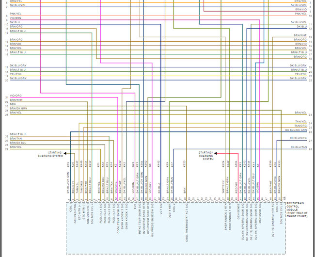

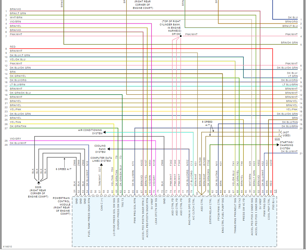

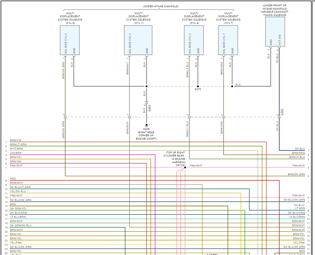

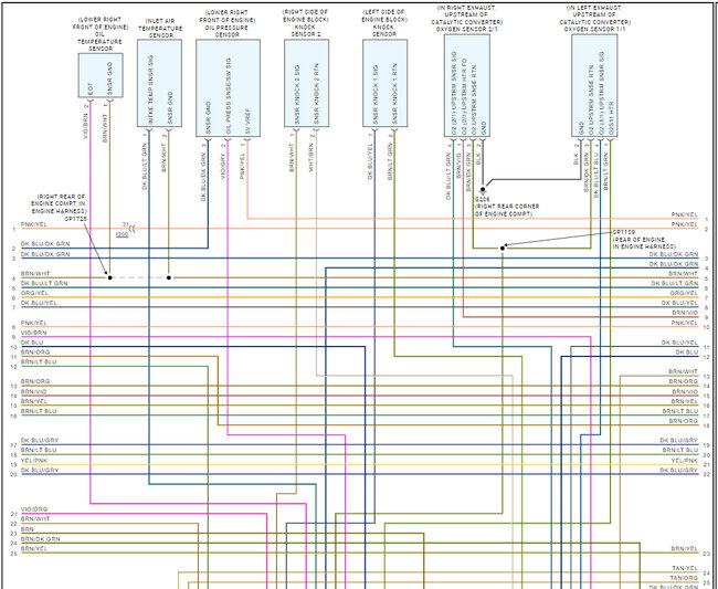

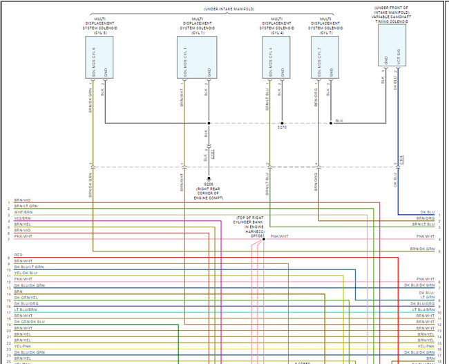

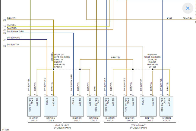

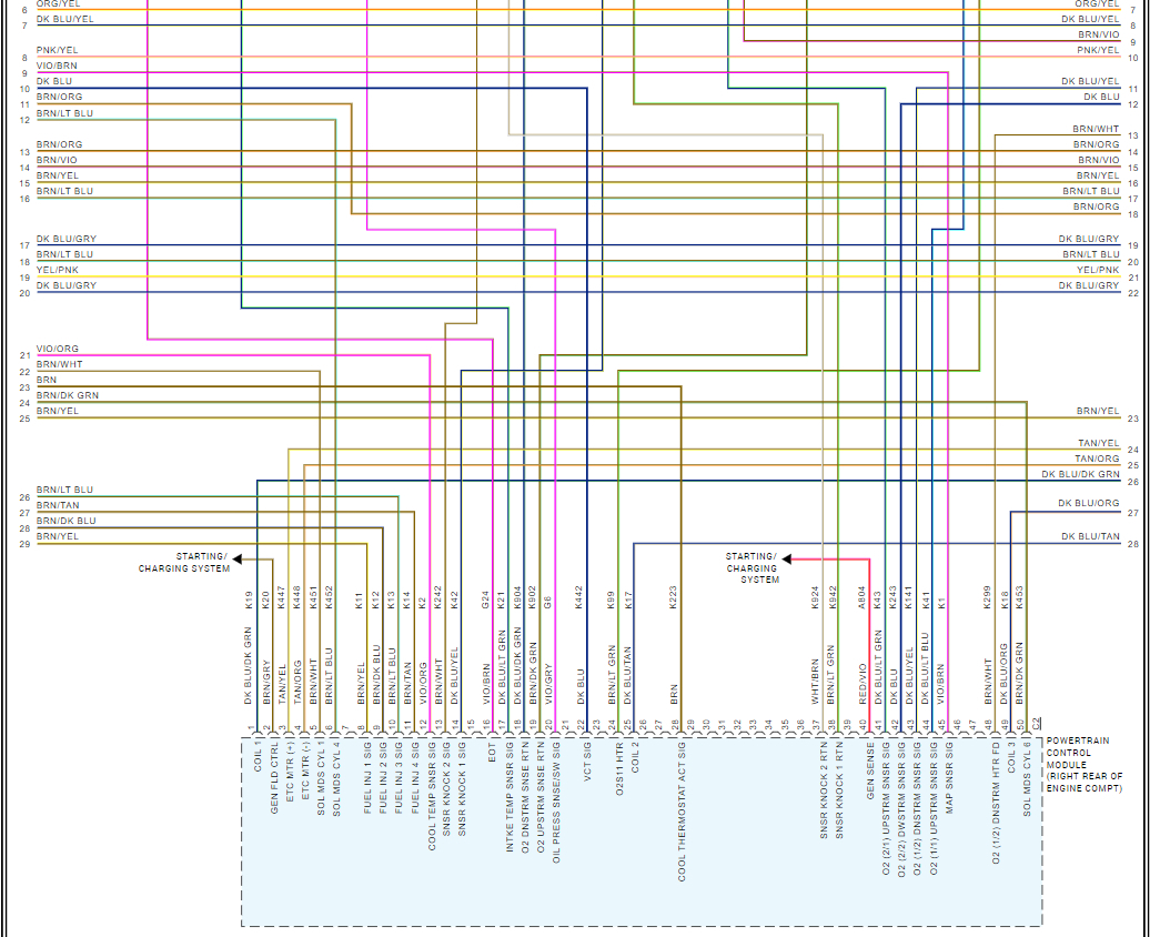

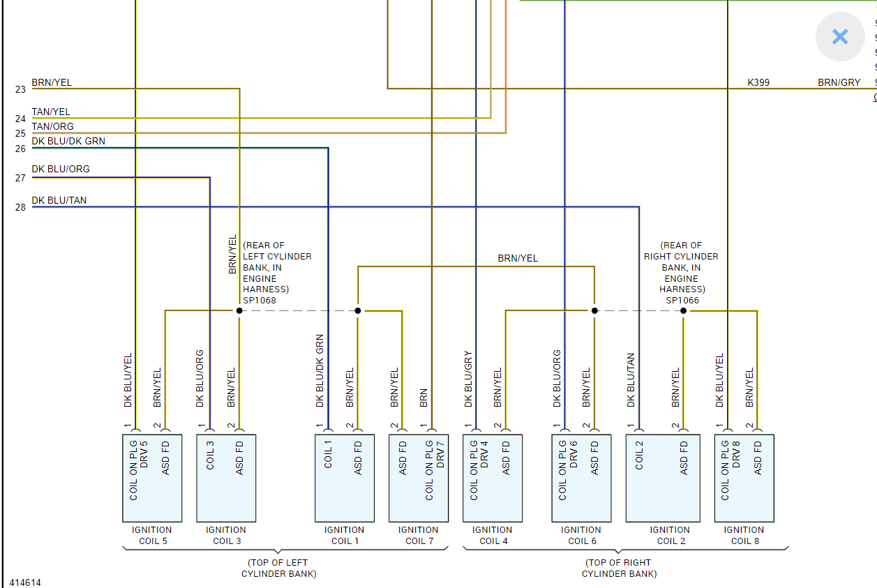

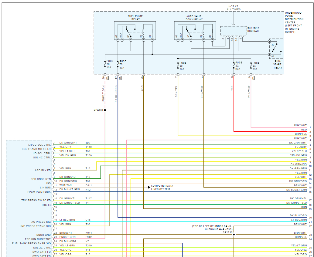

3 of the spark plugs are not getting the signal. Is there any way i can get the wiring diagram for that?
Thank you
Oct 13, 2024 at 10:43 PM
Experienced Mechanic
55,691 POSTS

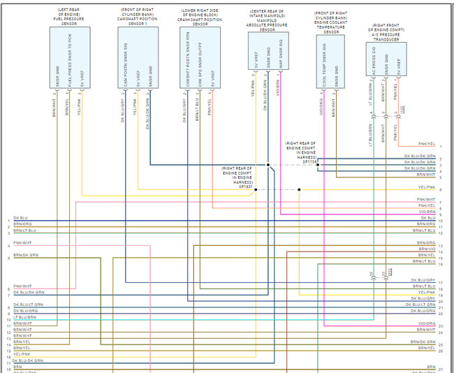

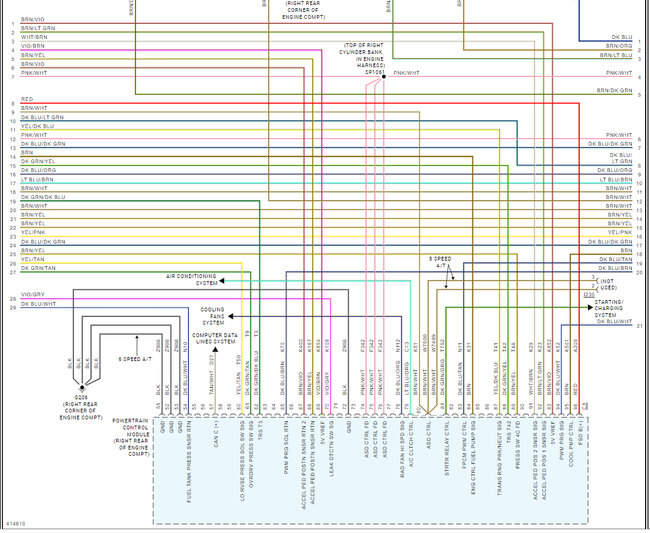

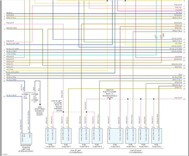

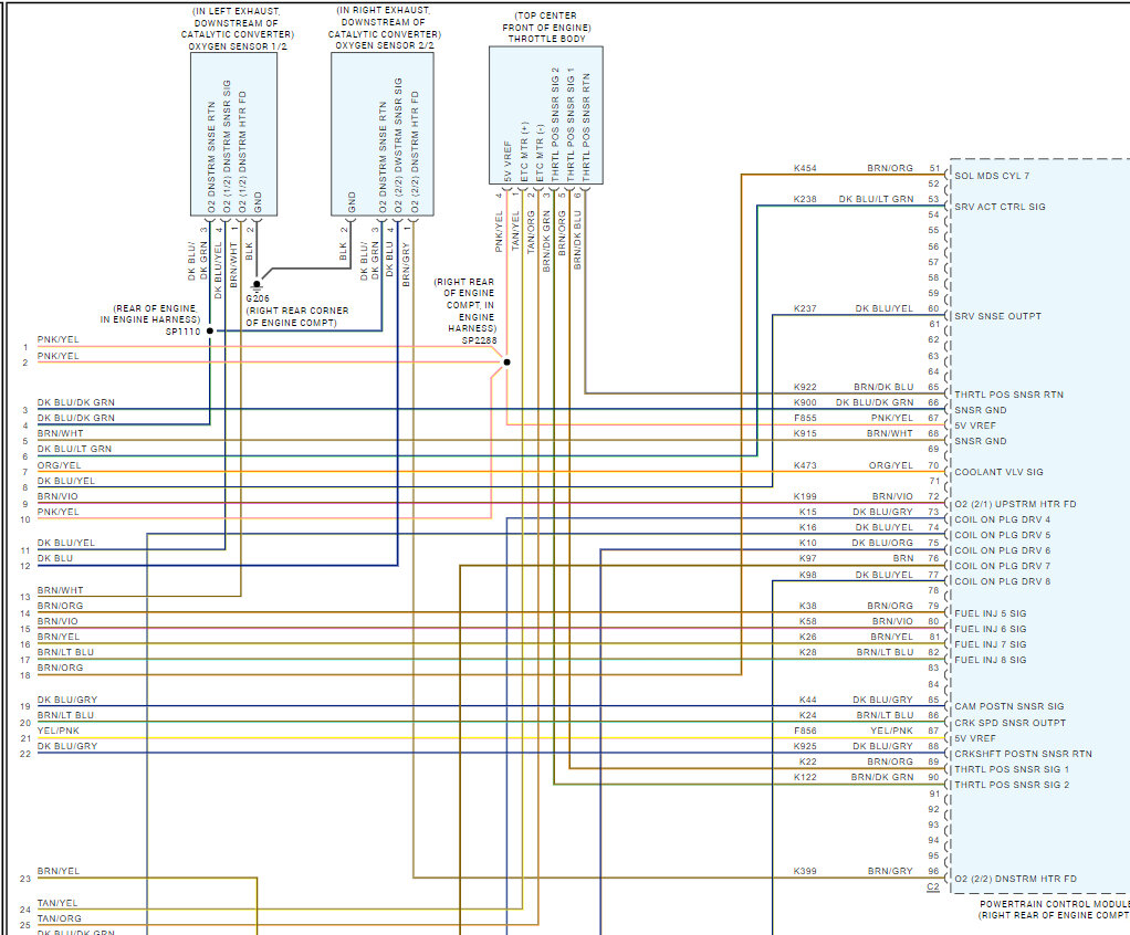

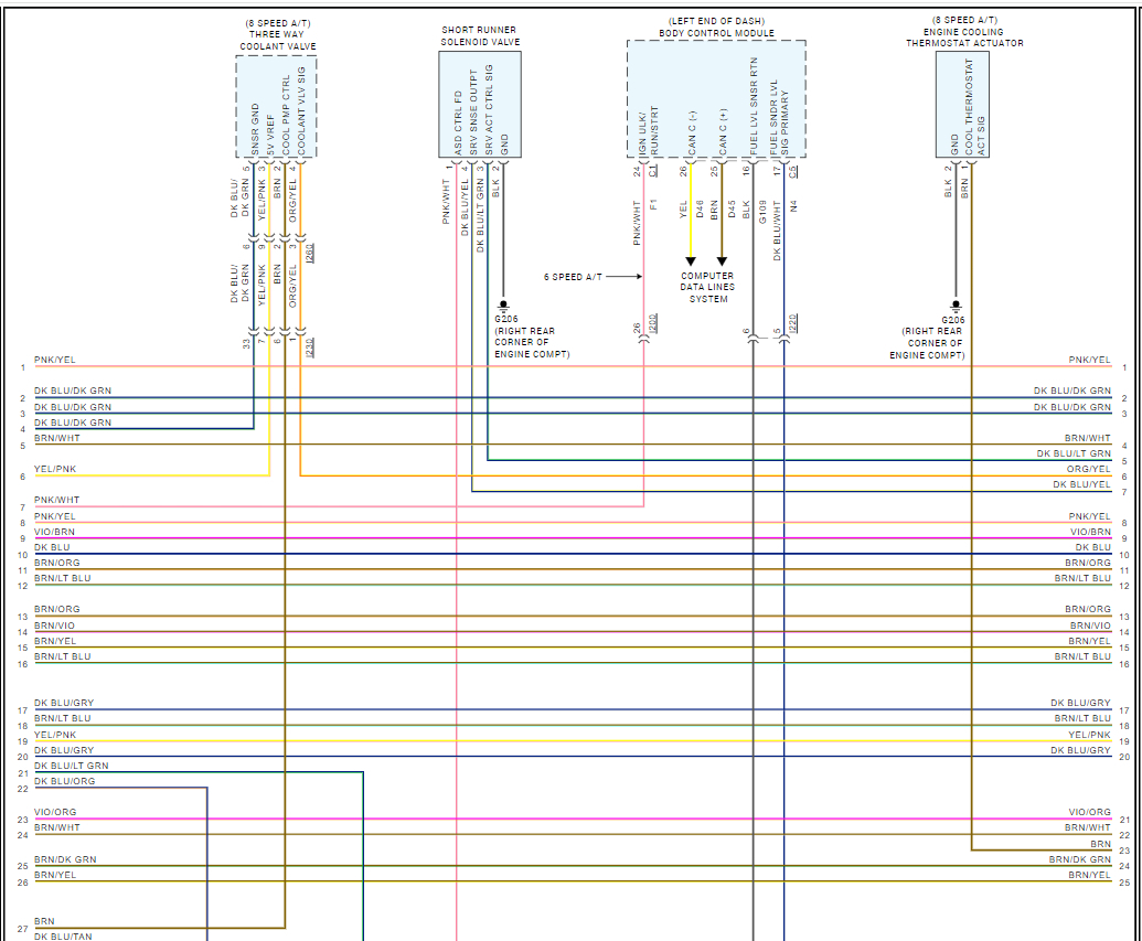

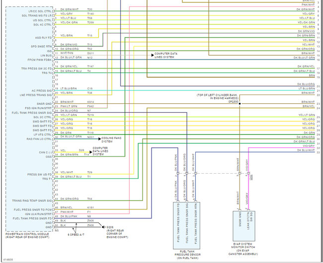

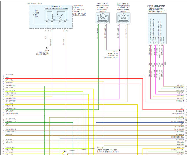

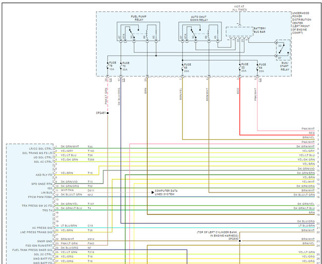

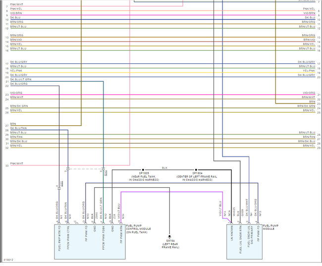

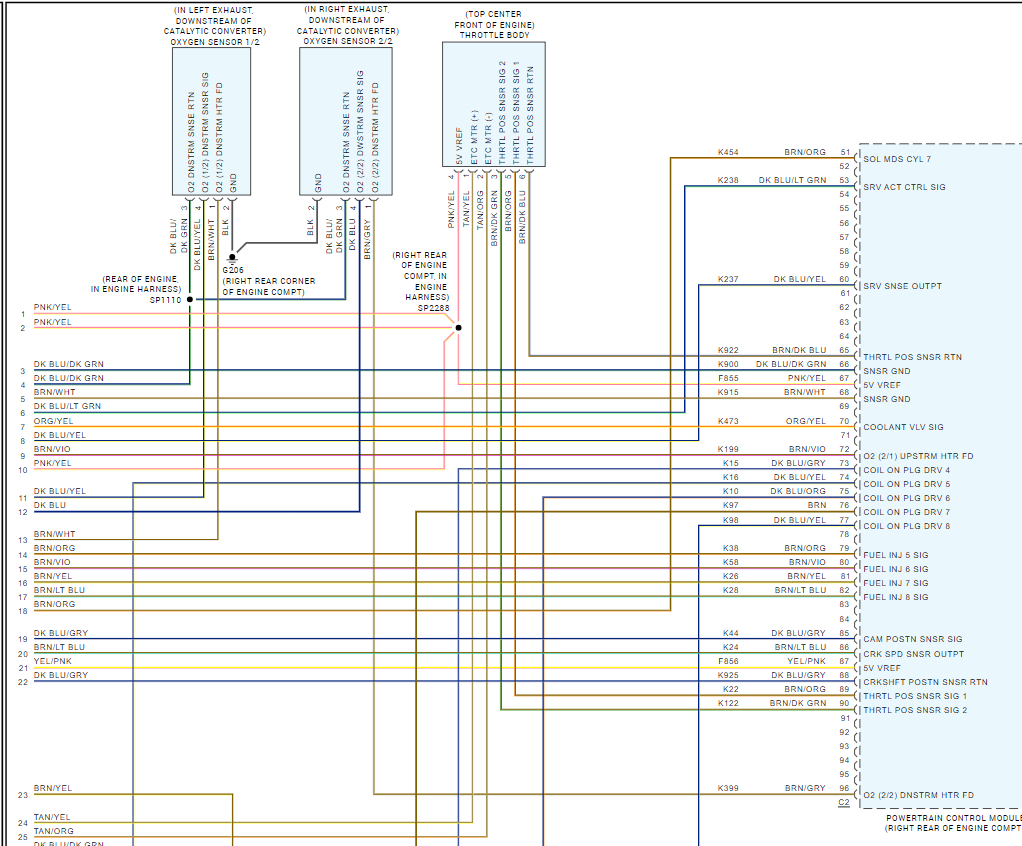

Sure, here are the wiring diagrams for the engine ignition coils and the engine PCM as well, this guide can help you test the connections:
I gave a close up of the coil wiring first to get you started. Check out the images (below). Let us know if you need anything else.
Images (Click to enlarge)
Oct 14, 2024 at 4:06 AM
ABIDZ05
MEMBER
7 POSTS
Thank you, Ken, that was exactly what I wanted and ended up solving my issue.
