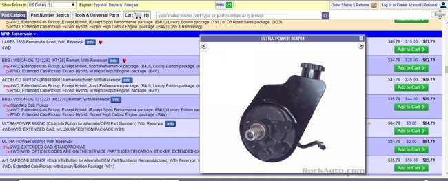

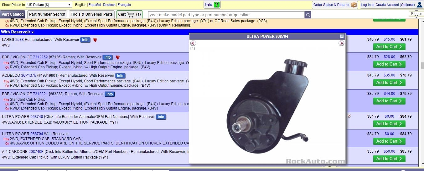

How can I tell if the truck has a b4 high option engine or if it doesn't? So I can get the right part.
Wednesday, February 27th, 2019 AT 9:08 AM
2 Replies
MECHANIC
52,797 POSTS
Good afternoon,
The B4 option is for the high output engine. You do not have the B4 option.
Part is listed below.
