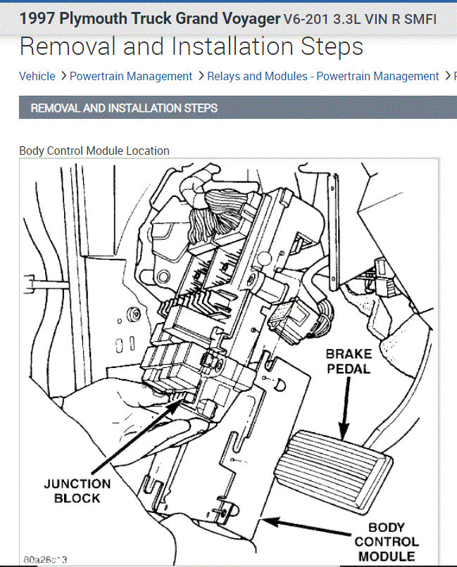

I need to replace my BCM
1997 PLYMOUTH GRAND VOYAGER
240,000 MILES • 3.3L • 6 CYL • 2WD • AUTOMATIC
DUGGH
My VIN is 1P4GP44RXVB437070.
Aug 18, 2021 at 9:00 AM
  • 110,244 POSTS

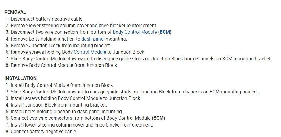

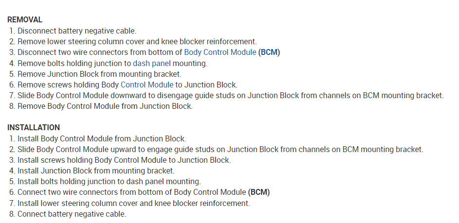

The body control module is located under the dash on the driver's side of the vehicle. I have attached the directions below for removal and replacement.
If you have other questions or need help, let me know.

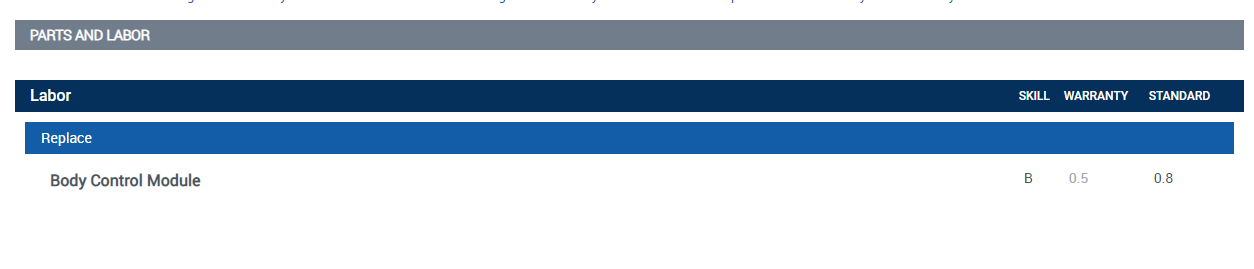

I attached the parts list from Alldata. There is no part number because there are several possibilities.
