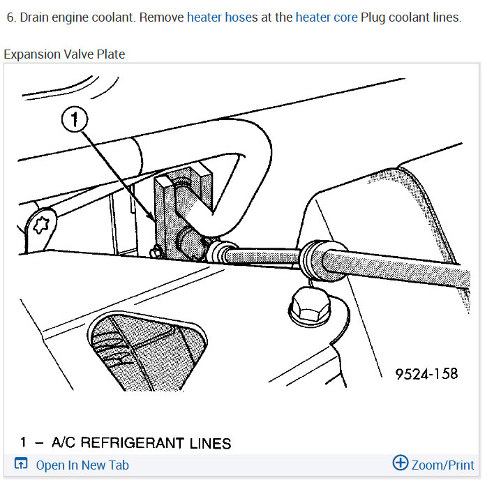

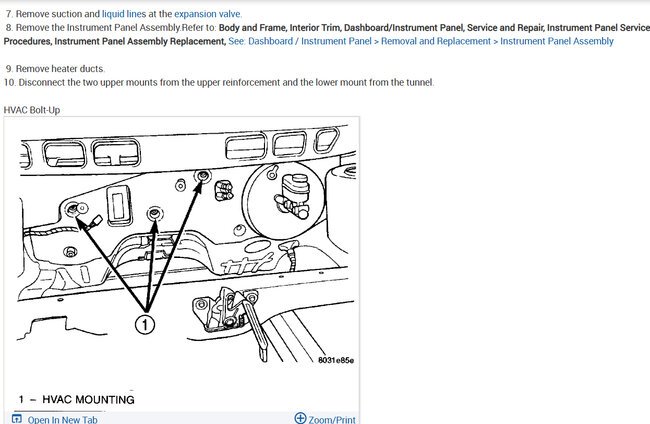

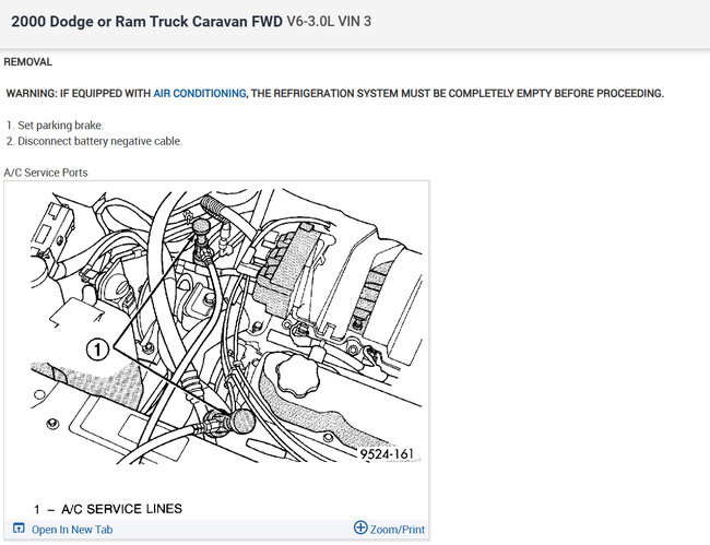

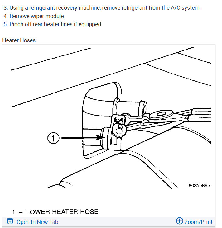

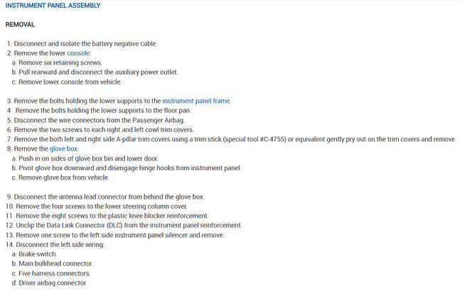

I need to remove Mopar 4882298AB Housing-Blower Motor the housing is broken big hole. I have all the top dash of and need to remove steering knuckle to pull bar and steering column out. but what do I need to remove to get the housing out to replace it.

The dashboard will need to be removed, and the coolant will need to be drained out along with the AC system that will need to be vacuumed down and recharged, this video will help with that.
https://www.youtube.com/watch?v=4EqdrBVb0sY&t=55s
Here are the instructions for you to replace the HVAC system plenum. Check out the images (below). Please upload pictures or videos in your response of any problems so we can see what to help you with.
